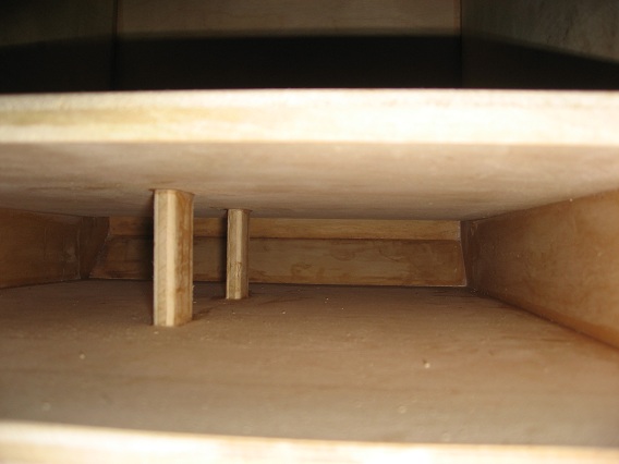

I recently designed and built a box that has port volume at about 20% of net box volume. Seems to work fine, however it has a fairly high tune (35hz) and not all woofers will work well configured like this. Roughly 2.5 cubes net and effectively a 15"x2.5" by 27.5" long port.
If you were to attempt to tune low, say 20hz, in a 2-3 ft3 box, you need to be very careful that your port cross sectional area can keep up with your woofer's max output. Air speed needs to preferably be around 25 m/s or below at max output at tuning. With more powerful woofers the area needed increases, making the port length too long for a small box.
I've found that the best way to cram the most port you can into a small box is with a slot port on the longest dimension of the box with 90 degree turn on the end up the back wall, this gives you a bit more effective port length without extra complexity. Use a roundover and 45 deg slat to improve air flow on the inside, and roundover the outside end. Assume about 2" effective extra port beyond the actual measured length. See here for good discussion on end correction:
http://www.diyaudio.com/forums/subwoofers/219923-ultra-compact-ported-15-dayton-ref-ho-4.html
Inside end of port:
Looking in from the outside:
turbodawg, did you actually measure the true Fb? Reason I'm asking is because I've been doing subs like this for a while (not recently though), but none the less, when I use a slot port like yours where the slot ends up using 3 enclosure walls for its walls, I end up with an effective port length of ~66% longer than what it actually is (roughly 40% reduction in required port length, equivalently stated). This I verified with a WT3/DATS.

Hi, I ran some test tones at fairly high output and the frequency with the least cone movement was about 35hz or a hair above that. My original model has a 24" port length and 37.5hz tune. The box dimension on the port side is 22", so the actual port length with the bend is around 23-24". Also, my port is not exactly 2.5" tall, it's around 2-15/32", so that drives down the tune a hair.
Modeling with a 35hz tune and a not particularly accurate net volume around 2.5-2.75 cubes I get around a 2.5x15x27.5" port. So figure an additional 2" of end correction, vs. my actual, is about right.
I was expecting to end up with something tuned lower than the model, so I am pleased.

That's interesting indeed, because with a worst-case 2.5 ft³ and a 2.5"*15"*24" physical port gives me a standard tuning of 35hz. 27.5" gives me 33 Hz tuning. I am using Akabak to model. I would actually expect to see your box with no higher than 30Hz Fb. Would be interesting to see an actual impedance sweep of your box.
