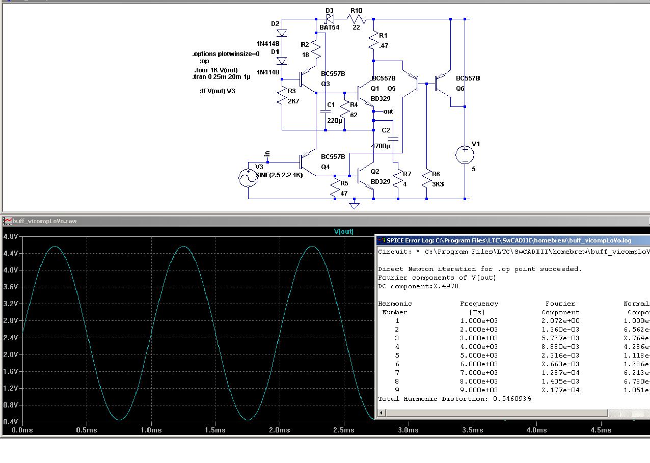

You can also go discreet: here is an example of moderate complexity and performance. It gives 4.4Vpp output at 0.5% distortion and is unity gain.
The quiescent current is 20 to 30mA and is thermally compensated by attaching D1 or D2 to the output transistors. The other one compensates for Q3.
Hi Elvee,
Apologies for not responding to your post - don't know how/why it slipped me by ...that's quite an impressive little circuit - is it of your own design? (is there an PCB layout available anywhere for it?)

Hi Elvee,
Yes it is.
Sorry, it has just been simulated and breadboarded...
You could extract a little more performances by using superbeta transistors, from Zetex, or whatever it's called now.
