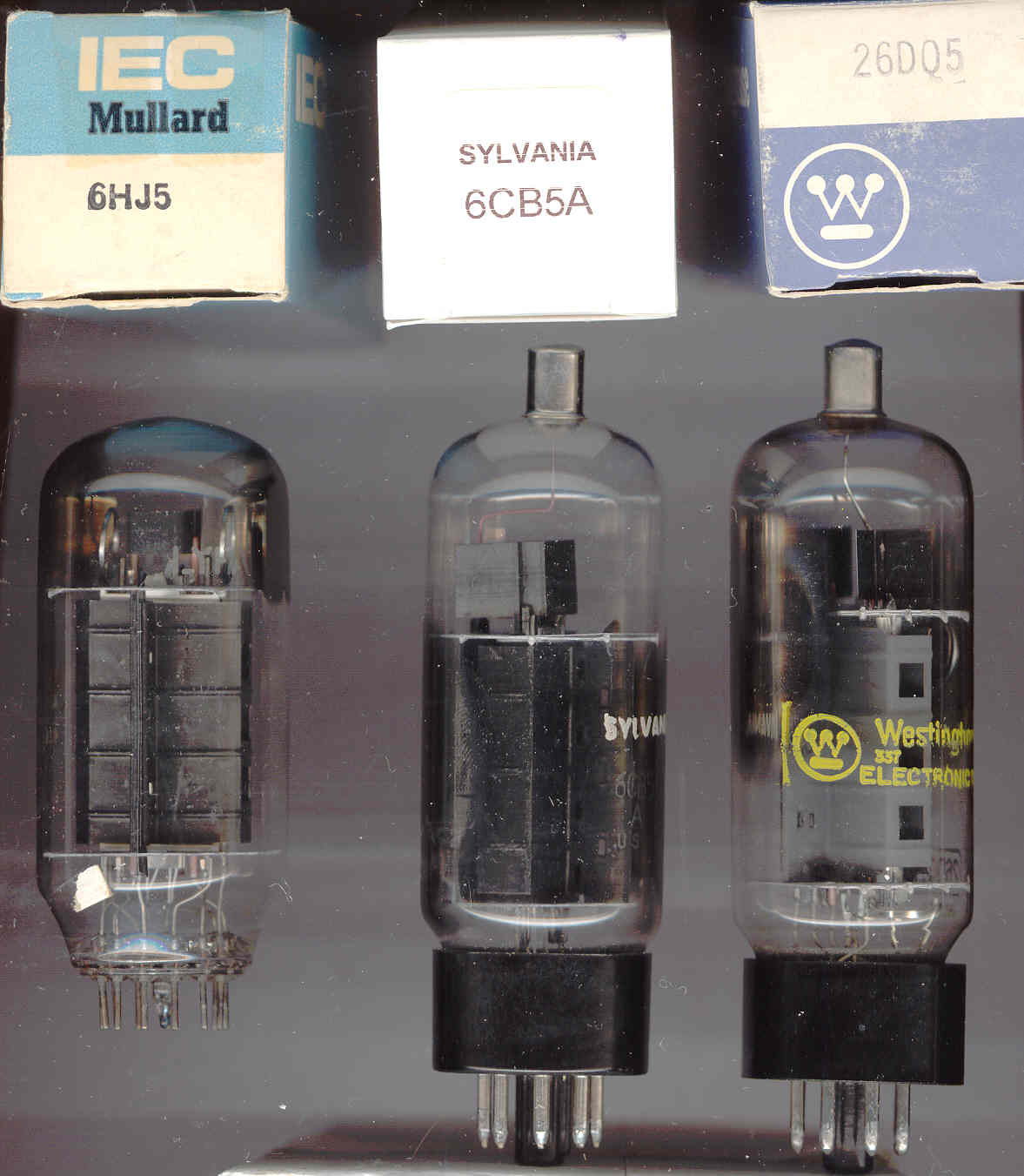

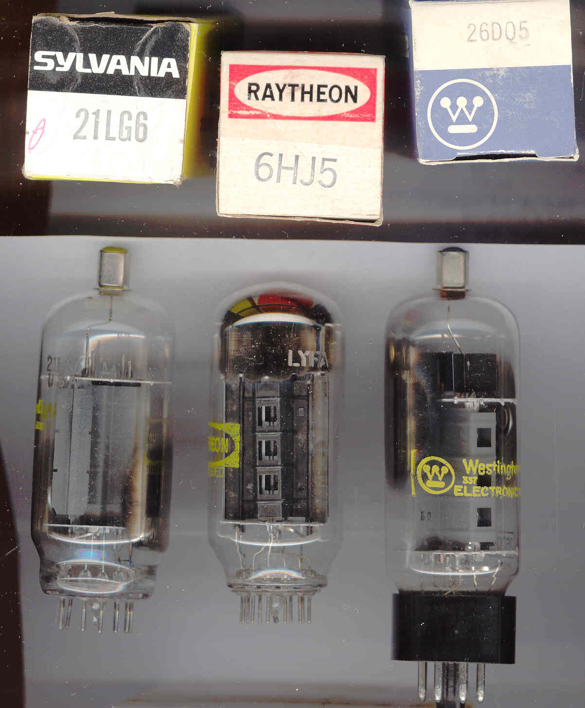

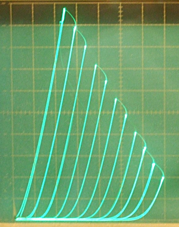

I would suggest looking through the $1 list, below, for tubes that are useful and more plentiful. Like: 6JC6 6HB6 6BN11 6AG9 6DK6 6CM7 [ 6LY8 6JV8 6KV8 6KR8 6HZ8 6JT8 ] 6GF5 12/13DR7 ...
and for power tubes: 26DQ5 for $3, 6CB5A or 6EX6 for $5, 6HJ5 or 21LG6 for $4, 12JN6 or 12GT5 for $3, 6JN6 or 6GE5 for $6, .....
and 12HL7 $4 (pentode or triode driver tube), (triode curves below)
$1 List: Summer Dollar Days - Vacuum Tube Sale - $1.00 Vacuum Tubes

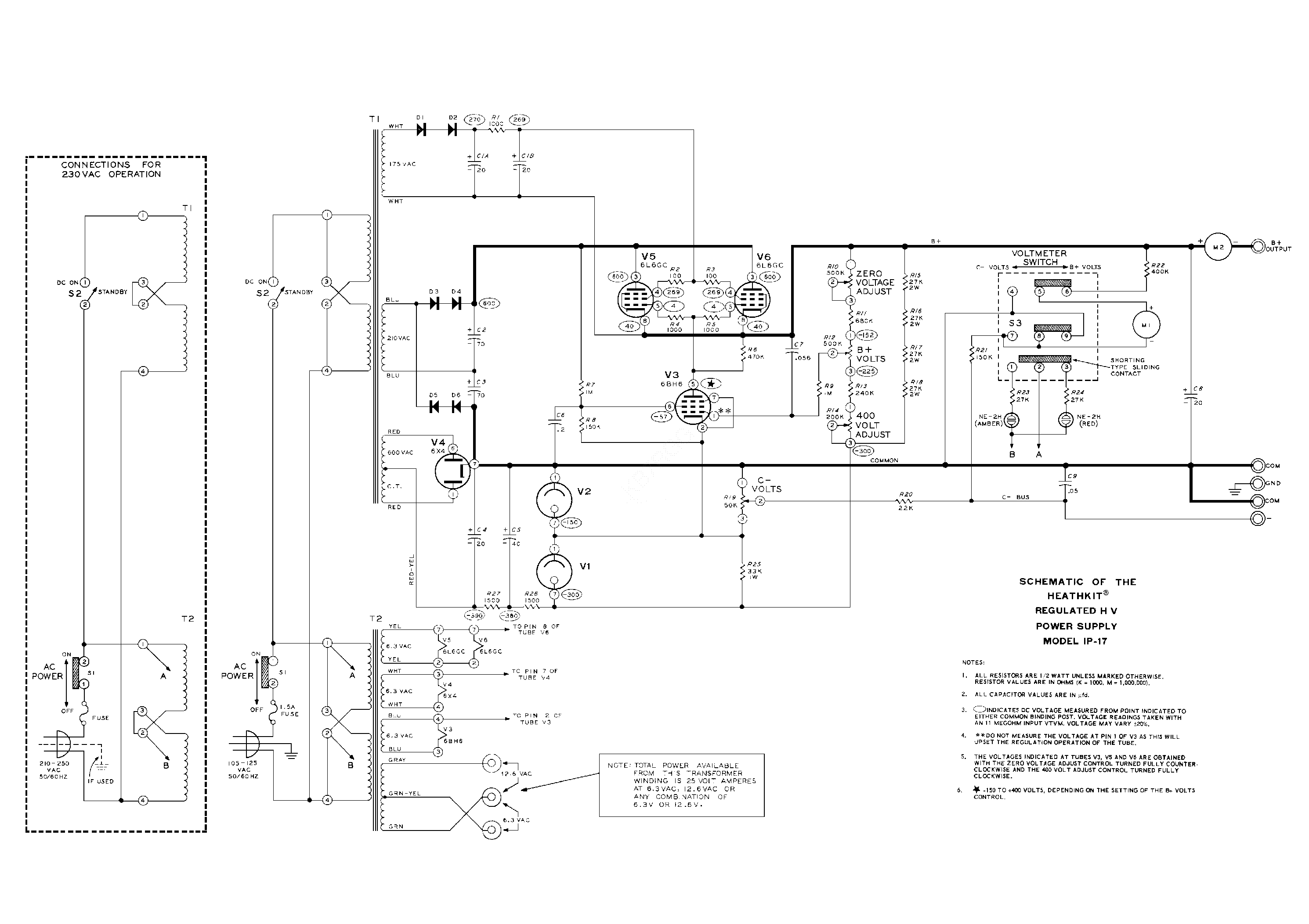

Does anyone have a good link to an adjustable regulated ht supply? I can whip something easily enough Id say.

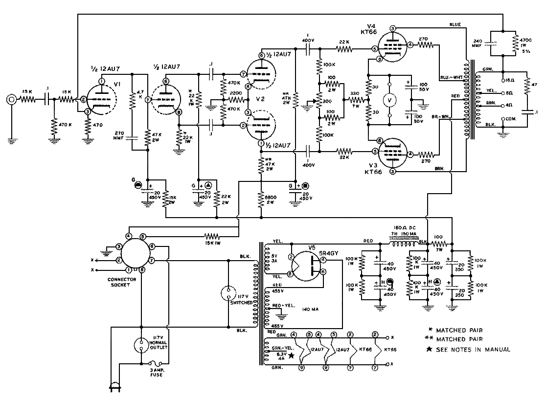

While most definitely not an early project, the 6CG7s would be excellent in a Williamson style PP amp using either 6L6GC or KT88 "finals". When you finally build a Williamson, good O/P "iron" is essential. The attached Heath schematic illustrates what Williamson style topology looks like.

Hey, that's good to know about the 6cg7 (and who doesn't like to feel they got a good deal 🙂 ) and noted on the amp suggested. If I follow, it's a triode amp, followed by a splitter, triode driver to pentode output? Ul tap on the transformer. I don't quite get the bias setting on the outputs though.
Cheers for the power supply links. Much appreciated!
Williamson topology is voltage amplifier DC coupled to "concertina" phase splitter, followed by a differential gain block, and on to the "finals".
The Heath W5M employs self biased "finals", which accounts for the "tall" B+ rail. "Fixed" bias O/P tubes can also be employed.
Examine the setup for phase shifts and you will see why "bargain basement" O/P "iron" is not a good idea. Combine the RC pole shifts with a shift in the O/P trafo and the Barkhausen criterion for oscillation is satisfied. 😡 It is necessary to spread the RC pole "corner" frequencies out and use good O/P "iron". Low frequency instability is the "Achilles Heel" of Williamson style circuitry and prophylaxis is absolute essential. Why bother with Williamson, given its weakness? Williamson style topology is incredibly linear/good sounding, which makes it a "classic".
