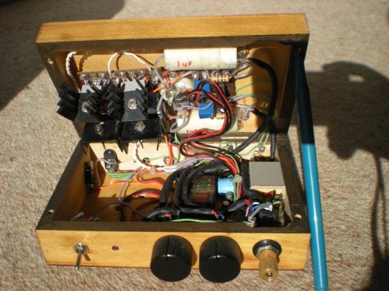

Interesting link. I used this because I wanted to run the ECC82 from 12V DC. To see what happened!
Bigun,
" Photo's of the inside"
It was done in a few hours so it's a bit of a birds nest!
Because it was in a wooden box I had to screen cables. I used PTFE silver plated cable as a twisted pair covered in foil with a drain wire twisted around the foil, covered with heat shrink!🙂
Regards
M. Gregg

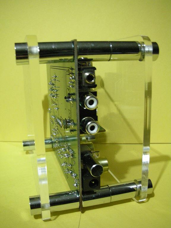

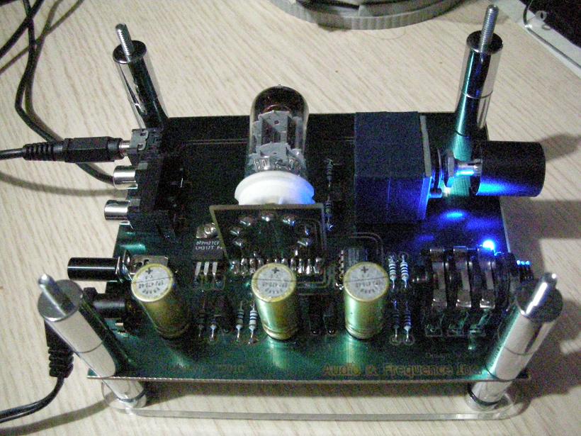

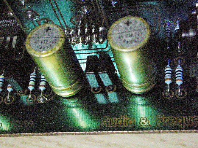

Thanks M Gregg
I use bettery supply B+ 12V
and sound is sweet.
now the tube is made for car use.
tube type is 6DJ8 .
my friend say the tube is use to fix BMW car stereo.
and sound is sweet.
tube type is 6DJ8 .

It looks pretty dapper to me, nicely done !
p.s. my amp is also a bit of a birds nest, I'm the process of trying to tidy it up but I'm not sure its worth the trouble.
