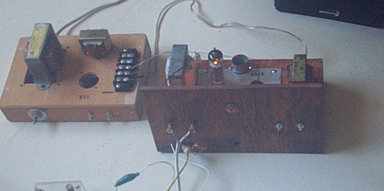

I wired this output transformer into a 6BQ5 amplifier, the chassis on the right. It is the amplifier on the left side. The right side is using a smaller vintage 6BQ5 output transformer. The power supply chassis is on the left. The amp is driving a Dayton B652 speaker and its input is a Toshiba "walkman" style radio.
