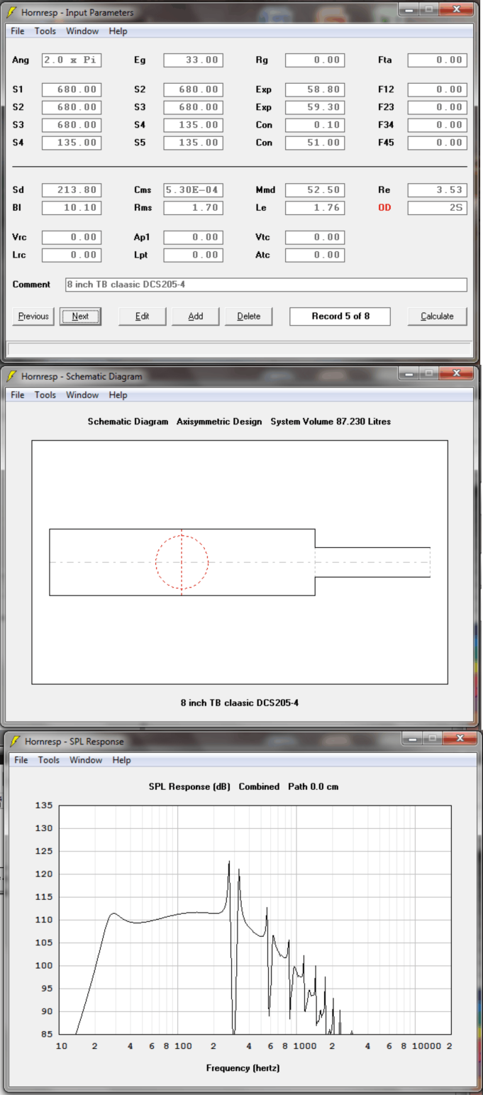

I made the first step by duplicating your results. That's a good sign I at least am running Hornresp the right way.If you want to use more than one driver the the CSA:s S1,S2,S3,S4 and S5 must be enlarged correspondingly e.g.:
If 3 drivers then S1...S5 should be multiplied with 3 to get the correct areas bu the section lengths L12...L45 should alwauys remain the same.
Now it doesn't seem like either of the Hornresp outputs you show match the dimensions in the speaker diagram in the upper left hand corner. That's too bad as that design would really work well.

In post #20 I showed a design using 3 Drivers further practically optimized (-11.5L smaller) and a crude 'Paint' picture that only have a small typo error, that in reality, would minimally affect the resulting FR:
The internal dimension 32.5” should be 32.85”,i.e. L23 should be 18.64cm instead of 17.8 cm.
The Drivers are mounted in a row as close as possible to the S1 area but obviously cannot be kept centered at L12=64.8 cm if not horizontally mounted.
Practically, the driver Sd areas are distributed over a larger section length than shown in the simulation but still somewhere covers the stipulated L12 section length:
This is good enough and will return smoother off-band FR than the simulation predicts at the precise center location that HR uses.
The amount of needed stuffing must be simulated too but at a later time after an exact box Plan is posted by the DIY'r 😀

I just figured out where the 258.19 CSA comes from (forgot to subtract the width of the .75" board, duh).
1. You have L12 as 64.8 cm and L23 as 17.8 cm (or 18.64 cm in the corrected version). From what point are these measured? I see the "center" of speaker set about 26.7 cm (17.8 + 8.9) from the "bottom" of the first cavity in the diagram (the LEFT end of the schematic, or the S1 point) and 55.8 cm from the start of the second cavity (the L45).
2. I get different answers if I use "parabolic", "conic", etc., even though the change is diameter is a step function and not any of those curves. What fundamental concept am I missing? What does the "parabolic" refer to (since none of the walls are curved)?
Thanks for working with me on this. What I find interesting is how different Hornresp and WinISD suggestions are. Since both are trying to model the same concept (a box, a speaker, a port, the responses), they should converge at some point, maybe a cubic box?
Now I just thought of another interpretation of the situation. The measurements you used (64.8 & 18.6) are where the speakers SHOULD be. The diagram on the upper left is just an illustration of the general situation (speakers close together, a long secondary cavity that opens to the front, etc.). To implement the design, I need to put the speakers at the S2 position.1. You have L12 as 64.8 cm and L23 as 17.8 cm (or 18.64 cm in the corrected version). From what point are these measured? I see the "center" of speaker set about 26.7 cm (17.8 + 8.9) from the "bottom" of the first cavity in the diagram (the LEFT end of the schematic, or the S1 point) and 55.8 cm from the start of the second cavity (the L45).
Now I do have one more question about the "position of the speakers". I would assume the "position" (or the S2 point) would be at the midpoint of the middle speaker. So in the diagram, the "position" of the speakers (S2) is about 26.7 cm. To build the modeled sub-woofer, I would need to move the speakers to 64.8 cm from the "bottom" of the first cavity. Is that a correct assumption?
THIS part I understand.Practically, the driver Sd areas are distributed over a larger section length than shown in the simulation but still somewhere covers the stipulated L12 section length:
Okay, this part I do NOT understand. The speakers (in the diagram) seem to be much lower in the first cavity than indicated by the HR output (much closer to S1 than 64 cm).This is good enough and will return smoother off-band FR than the simulation predicts at the precise center location that HR uses.
Obviously, I am missing something here.
