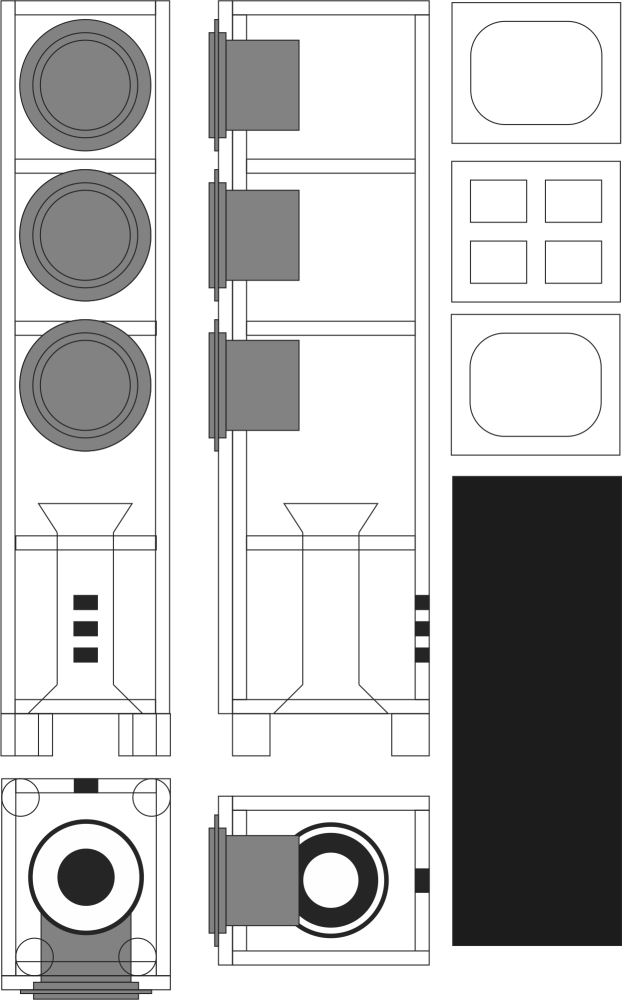

This project will be my second DIY speaker. The first was a kit (Overnight Sensation) where my personal contribution was moving the port location to the front so I could wall mount the speakers (and use them for the surround sides in my 7.1 setup). I very much enjoyed the project, so I want to do one “on my own”.
My front speakers (a pair of Polk 10s from the early 80s) do a good job, so I didn't want to replace them. Same thing with the center and surround back speakers (not all Polks, but all decent speakers). The only speaker I don't have currently is a dedicated subwoofer (although the Polks do a decent job on the low end).
So the decision was made to build a subwoofer. However, that desire is complicated by the rather major restrictions put on said subwoofer by what I've read here as the WAF.
The first restriction is that the subwoofer must fit into a location that is only 10” wide, and not much deeper. So no 15” subwoofers for this design. The second restriction is that I utilize my old NAD 743 amp that was replaced by the modern (Marantz) 7 channel system. I have access to 3 power amp channels of the old NAD unit, each with about 50-70 Watts (depending on which power rating I use). The third restriction is that I do not have access to a real shop. I have a carport, saber saw, circular saw, a drill, and I know how to use sandpaper. So all wood cuts must be simple. Oh yea, and “breaking the bank” is very much a no-go. Again, the WAF comes into play.
So the initial design has a set of three small subwoofer speakers with power handling ability around 50-70 Watts (to match my NAD output). I found a speaker that seems to fit the bill: Tang Band W6-1139SIF. Given 3 of those speakers, the box volume comes out to 1.263cu.ft., with a port 3” diameter by 10.2” in length. That should get me a response down to 33 Hz (which I can live with). With the restriction that the front be only 9” wide using ¾ birch plywood, the outer box dimensions come out to be about 38” tall and 11.25” deep (I doubled the front speaker plate for stiffness and because I had enough wood left in a 4 x 4 sheet to do so). I will include pictures of my design if I can figure out how to do so. It ends up looking like a small tower speaker, not the usual cube shape of a subwoofer. In my drawings of it, it kinda looks cool (which helps the WAF).
The only major thing left to do in the design is to locate the port. I have three choices: front, bottom, or back. Putting the port on the front or back means I have to curve the port as there is not enough depth in the cabinet to fit the port. Home Depot/Lowe's have 3” 90° PVC elbows that should work. If I put it on the bottom, I don't need to curve it, but I will need to set the speaker up off the floor so the port exit isn't too close to my carpet (I've been reading some threads here about that very issue, so you've helped me already).
Each speaker will be driven by a single channel of the amp I have from the subwoofer (line level?) output of my new system, so there should be no crossover or impedance issues to worry about. The NAD will drive the 4 Ohm loads without a problem.
I do have some questions and hope to get some suggestions about how to solve any remaining problems, such as:
1. Sanity check. I've gone over everything I can think of, but since this is my first real “scratch” speaker project, I wonder if there are some “simple” things I've not thought of (“Doh!” moments). I have a degree in physics (PhD) and do research for a living. I understand the “theory” of all of this stuff, but I know from experience that theory and practice are two different things and I have VERY limited experience making speakers.
2. Where should I put the port? I see advantages/disadvantages with each of the three locations. For aesthetics (and from reading horror storied about things getting put in the ports), I am leaning towards the bottom or back placement.
3. Corners. Due to my lack of proper tools and skills (I work electronics and software, not woodworking), I am going for “butt” joints, but I'd love a suggestion as to how to get rid of those plywood end grains (without having to buy new equipment or learn new skills in too short of a time).
4. Feeding the speaker. My intention was to take the “pre-amp/line level” subwoofer output of my Marantz SR-5007, split it into three lines, feed them into the power amp connectors (which I assume are high impedance, so splitting the line out should not be a problem). Then take the speaker level power amp outputs and feed them to the three speakers. Good sounds should happen, unless I really screwed up something basic (and yes, I've screwed up “something basic” in the past).
5. Speaker box material. I first was going to use MDF and then use vinyl to make it look good, but due to various issues, I moved to birch plywood which I will stain either oak, walnut or cherry (depending on the WAF). I am hoping that is not a really dumb idea.
6. General issues with the design. I don't even know what questions to ask here.

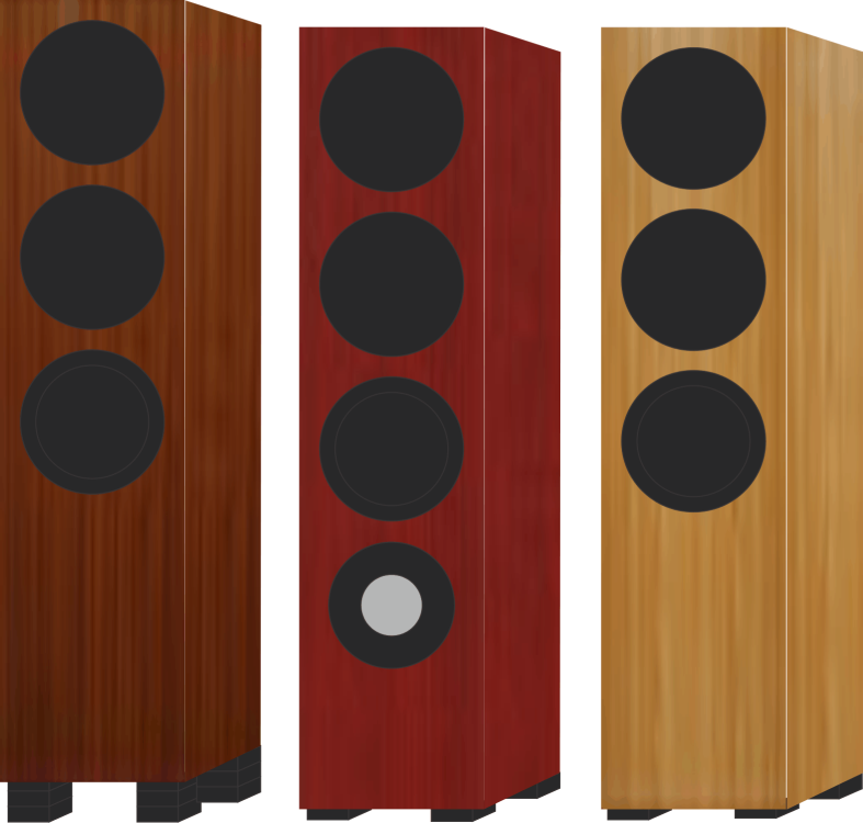

Pictures
Here are some pictures. The first picture is what it may look like using my drawing package (with 3 different finishes and the 3 different port placement). The second is a sort of "three view" of the parts & shape of the box. Most of the design is in my head, but I need little drawings like this to make sure all the parts fit together. There are 3 braces that I intend to make out of the "scrap" bits used to make the 6 sides. The grey things are the speakers, and there is the port in the bottom. Again, for scale, the unit is about 38 inches tall, 9 inches wide, and 11 1/2 inches deep on the outside.

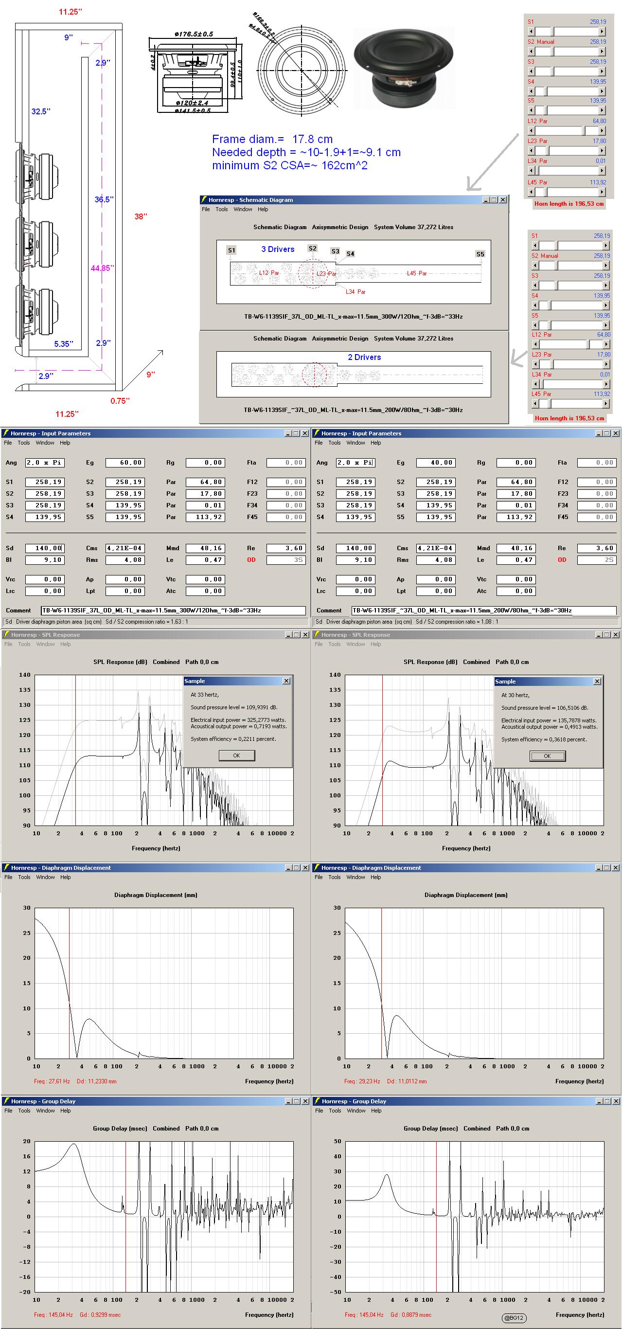

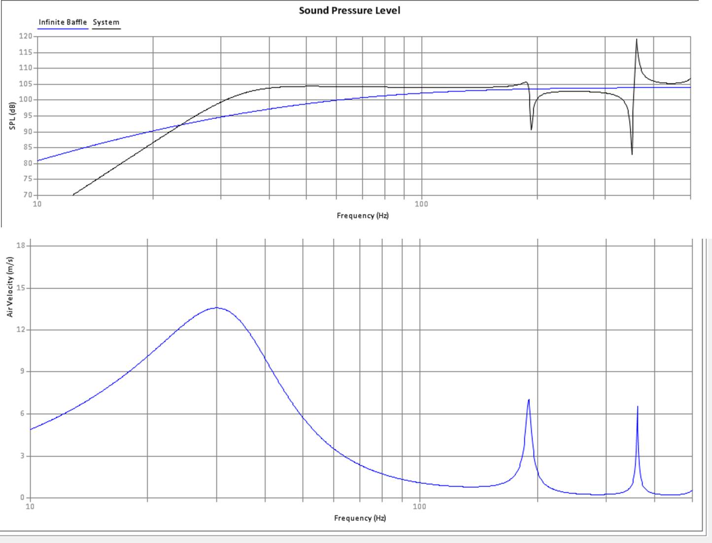

Below attachment is a sim of your design assuming it is a ML-TL. I have modeled your drivers as though they are at the start of the line but it has little effect being along the length (maybe a bit less ripple in the higher frequencies).
What frequencies will these be playing up too?
Also, be careful of port noise. you have over 10m/s there (@50w) and you don't want to be going much higher.

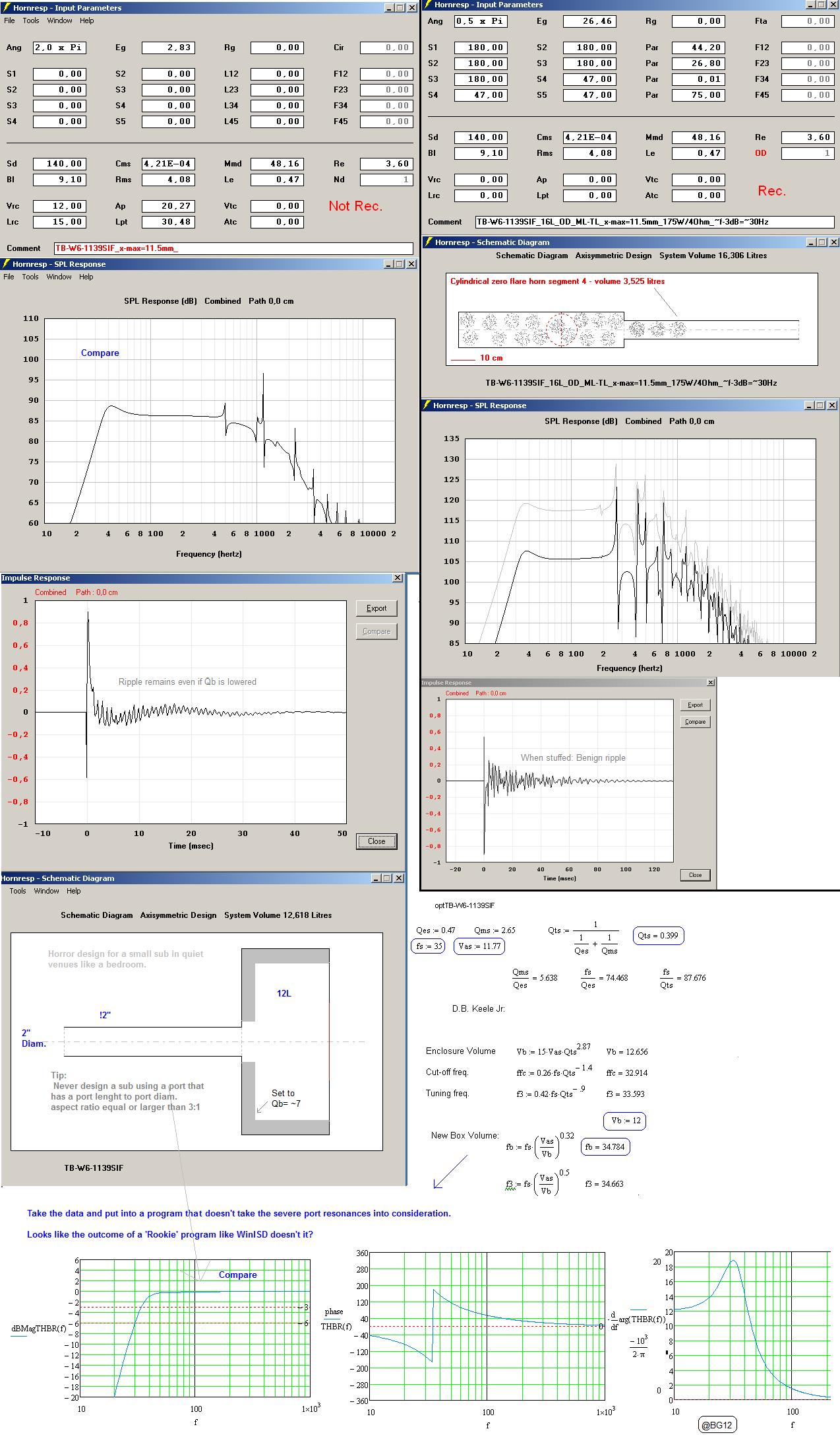

You will need to help me with this one. I see you did two different analyses, and found one recommended and one NOT recommended. I am not sure which numbers I need to find. It seems like the "not recommended" version has fewer spikes than the "recommended" version, but the recommended version has better transient response (?). It looks like the recommended version would be good if I can make sure nothing about 200 Hz gets to the sub. That part I can handle. I know how to do that with my amps.Hi, FYI:
b🙂
Obviously, you used a MUCH more sophisticated analysis program than what I used (WinSID or something?). That better program is showing things that were not found with my version. I've also not read that I should not use a port with a greater than 3:1 length/diameter.
What I don't see is a box size or port recommendation on either analyses. My guess is they are there, I just don't know where to look (or what to look for).
Help?
The four plots in the right column is IMO a sub I would recommended/ build.
On the right side and down a sub type that you can find mass-produced at bargain prices..i.e like 'F..ting' computer subs probably designed with programs like WinISD or similar. drDyna in this forum have a very good YOU-tube animation link that highlights the expected performance..Sorry I cant find this one.Maybe someone can post the Url?
b🙂
PS: ' It seems like the "not recommended" version has fewer spikes than the "recommended" version, but the recommended version has better transient response (?)'
No, the recommended version will in reality have much smaller spikes as internally damped and a far better transient response that can be seen in HR.

You might want to have a look at the Exodus EX-Anarchy 6.5" driver it's definetly mechanically quieter and also IMHO more musical oriented(lower distortion) than the similar TB drivers.THAT could be an issue. Are there any alternatives (same approximate size) that you might recommend? I want the sub to ADD to my enjoyment, not subtract. I will be sitting about 8-10 ft from the sub.
Also while your at it you might want to really consider an alternative design, say something like building 2 of these proven, tested and measured LilMike designed Tapped Horns Two of then side by side should fit in the space you have available and may have a much higher WAF since they are much lower profile. As to the complexity of construction there are CNC flat packs available for that design - just a thought for you - btw you can use either the TB or the EX-Anarchy in that design.
Yes, unfortunately you should still consider a high pass (rumble)filter that cuts or reduces most LF content below 15>20hz, especially with those very small drivers(6.5") which will never reproduce those frequencies anyways.Since none of my sources are analog (DVD-A, Blueray, SACD, mp3, FLAC,internet radio, etc.), will rumble still be a problem?

Hi,Dough,
I recommended the OD labeled simulation and for only one driver.If you want to use more than one driver the the CSA:s S1,S2,S3,S4 and S5 must be enlarged correspondingly e.g.:
If 3 drivers then S1...S5 should be multiplied with 3 to get the correct areas bu the section lengths L12...L45 should alwauys remain the same.
You need to learn HR, as a start look here:
b🙂
