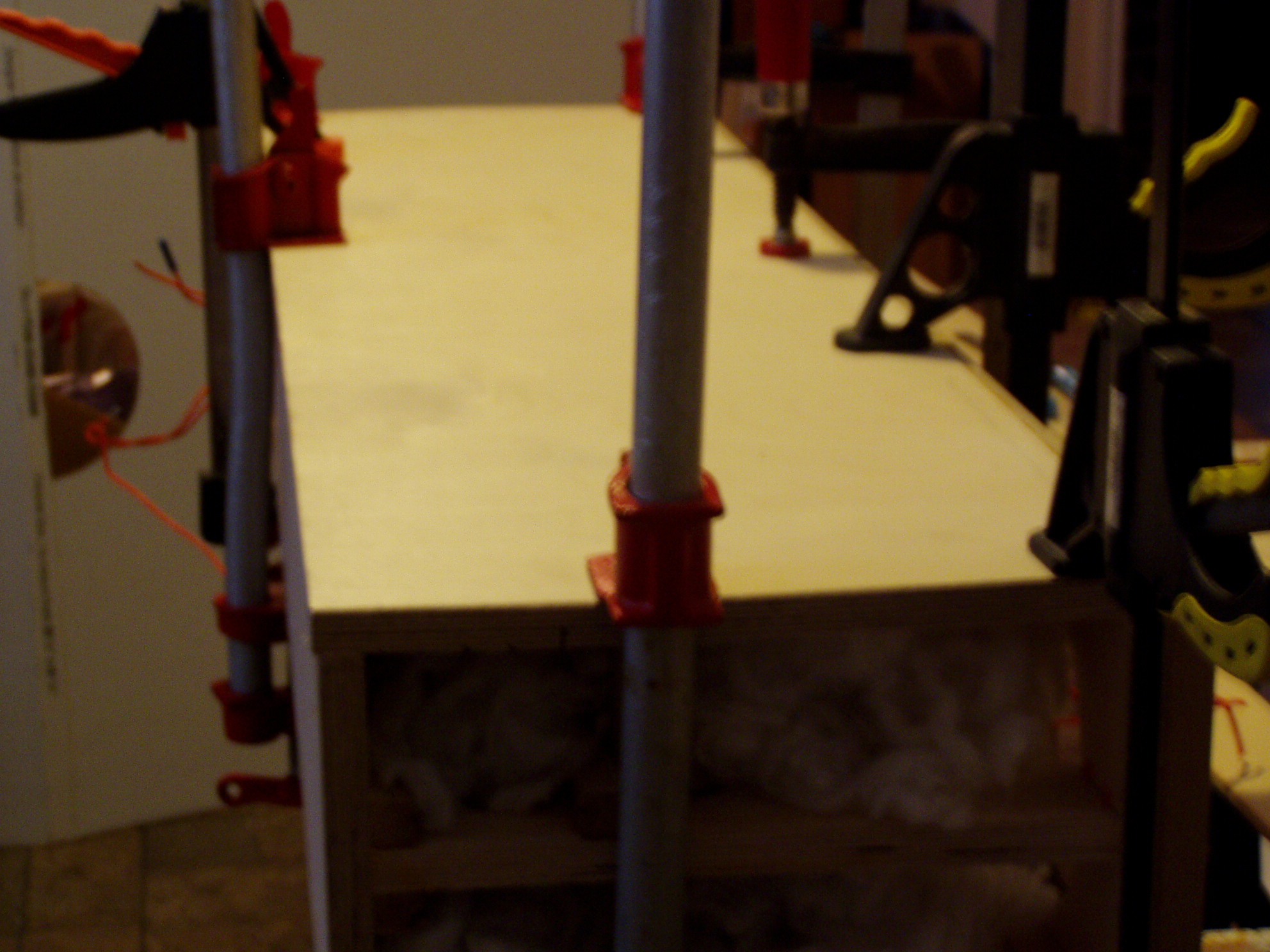

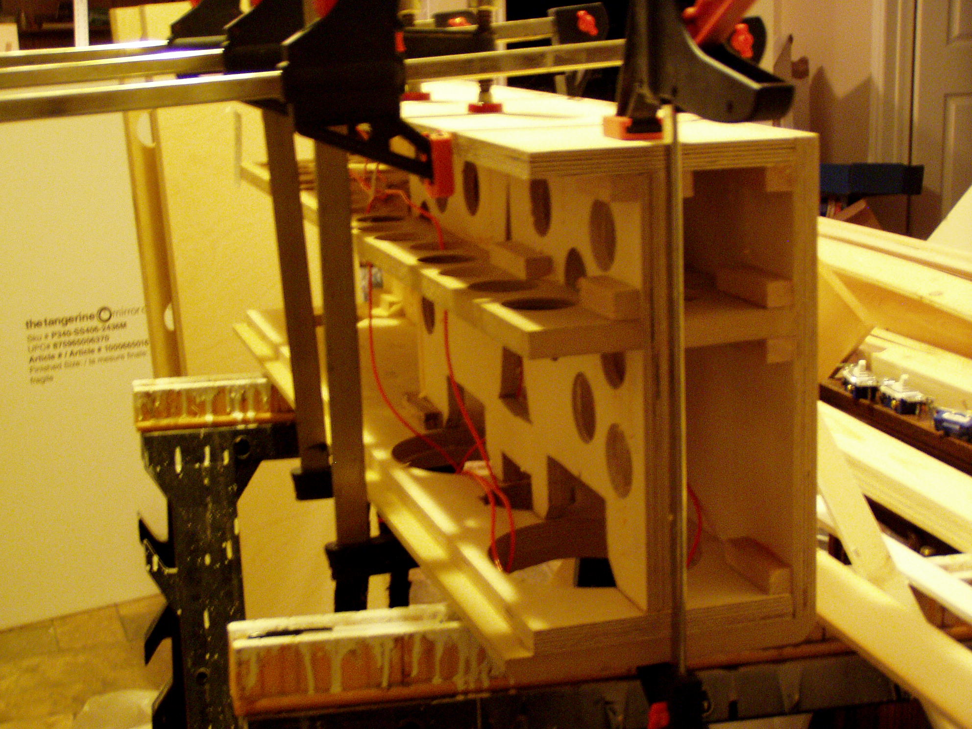

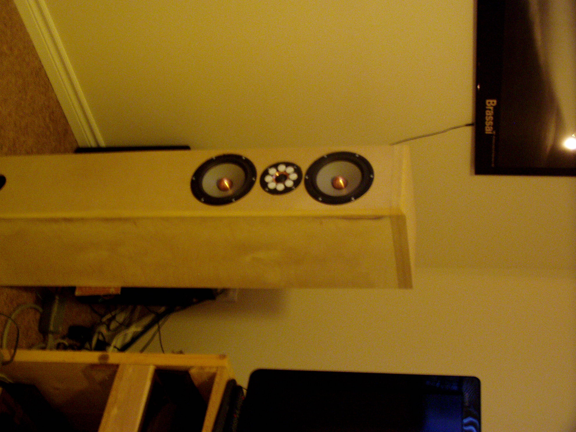

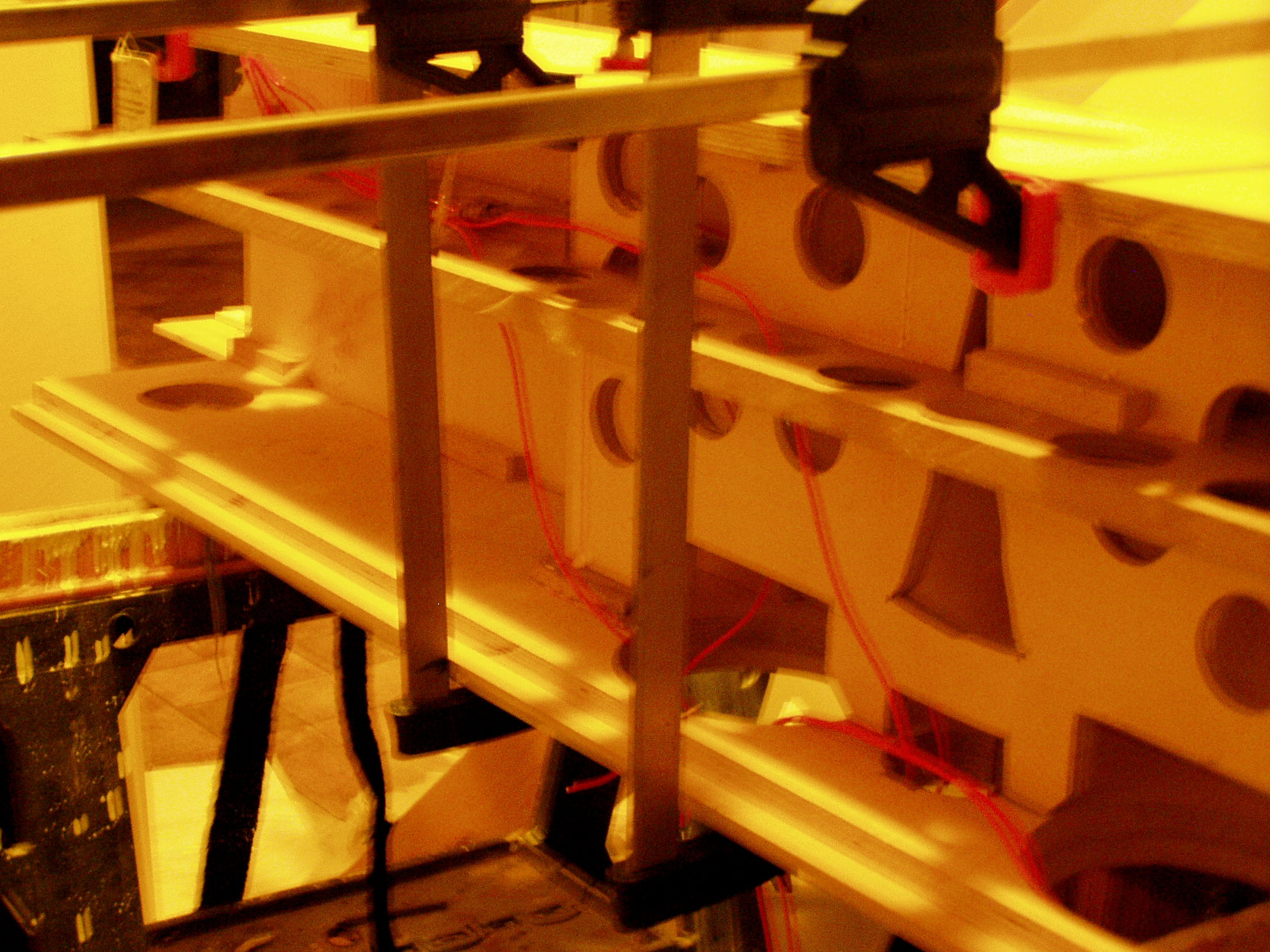

Here are a few more pics - using every clamp I have - my workshop- the semi finished speakers. I need to fix the damaged speaker you can hear a little rattle in the top woofer. I cannot finish the speakers now until spring as the weather in my workshop is a little damp.😀 I have not had time to listen critically Just finished. Learned I suck at soldering😱
It will be good to have them inside and "dry out" over the winter. They should equalize nicely and be ready for the finish come spring. Go easy on the volume knob until you fix that buzzing driver. My speakers sound best ~50% or higher.
Yours was a very quick build, I hope you enjoy them as much as "We" do.
I don't recall if your drivers were "New" or "Used", if new expect ~50 hours of break in time before they start to sound good. Patience Luke..........
