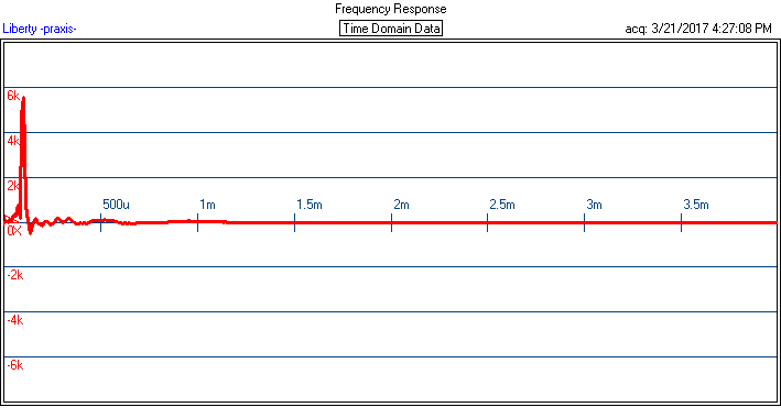

Here is the xml file to load into MiniDSP 2x4 HD. There is also a short text file included about how to remove the Linkwitz Transform and/or some room EQ I have applied in the settings.

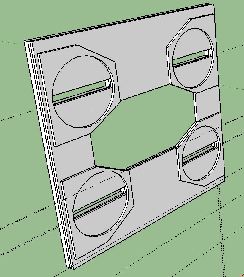

I made a start on sketching out a 4 woofer version, a few pics and a few Qs to go with them.
To start with I simply mirrored the slots above the wg so that the upper slots are the same distance from the CD as the lower ones like so

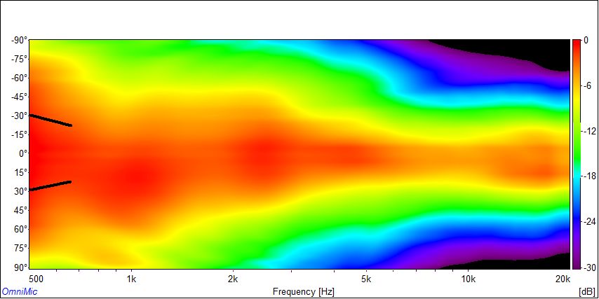

This gives a centre to centre spacing of the top/bottom woofers as about 10" (NB: I am working in mm here), xdir suggests this will produce the following lobe which seems a bit narrower than the mid/cd but not terribly so.
Is this a reasonable approach to placing the upper woofers?
Are there any concerns with space for the mid here? I guess not (because the mid is listed as 120x108.5mm and there is ~150mm between the woofer mounting points).

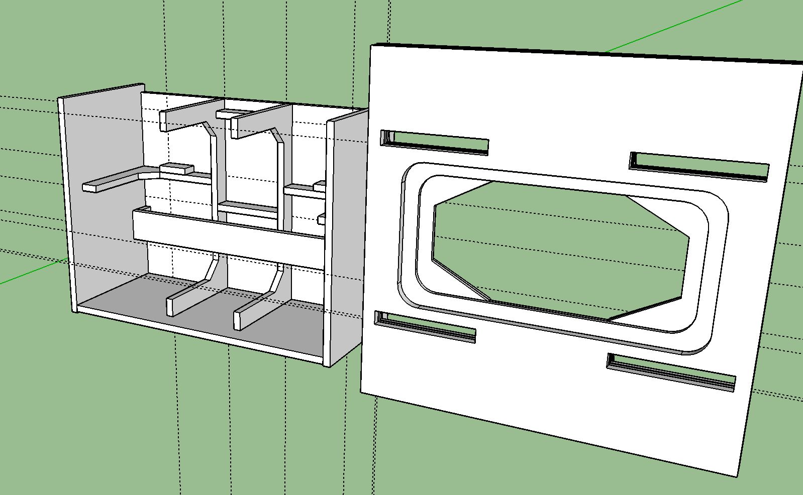

I also worked out the internal volume of the sealed smallsyns to be somewhere around 30L. Is this about right? It seems like an appropriate size (when modelled) so I was planning on simply extending the baffle down til I hit around 60-65L internal volume.
