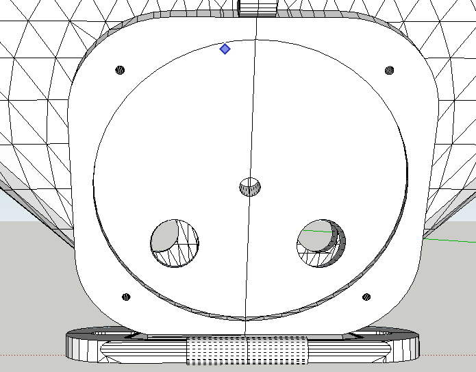

I am attempting to design a drop in replacement for the horn in the SmallSyns, as it is all but impossible to purchase it now. I'm hoping to just get it close, so no (or a very minor value change) is needed to drop into Bill's design.

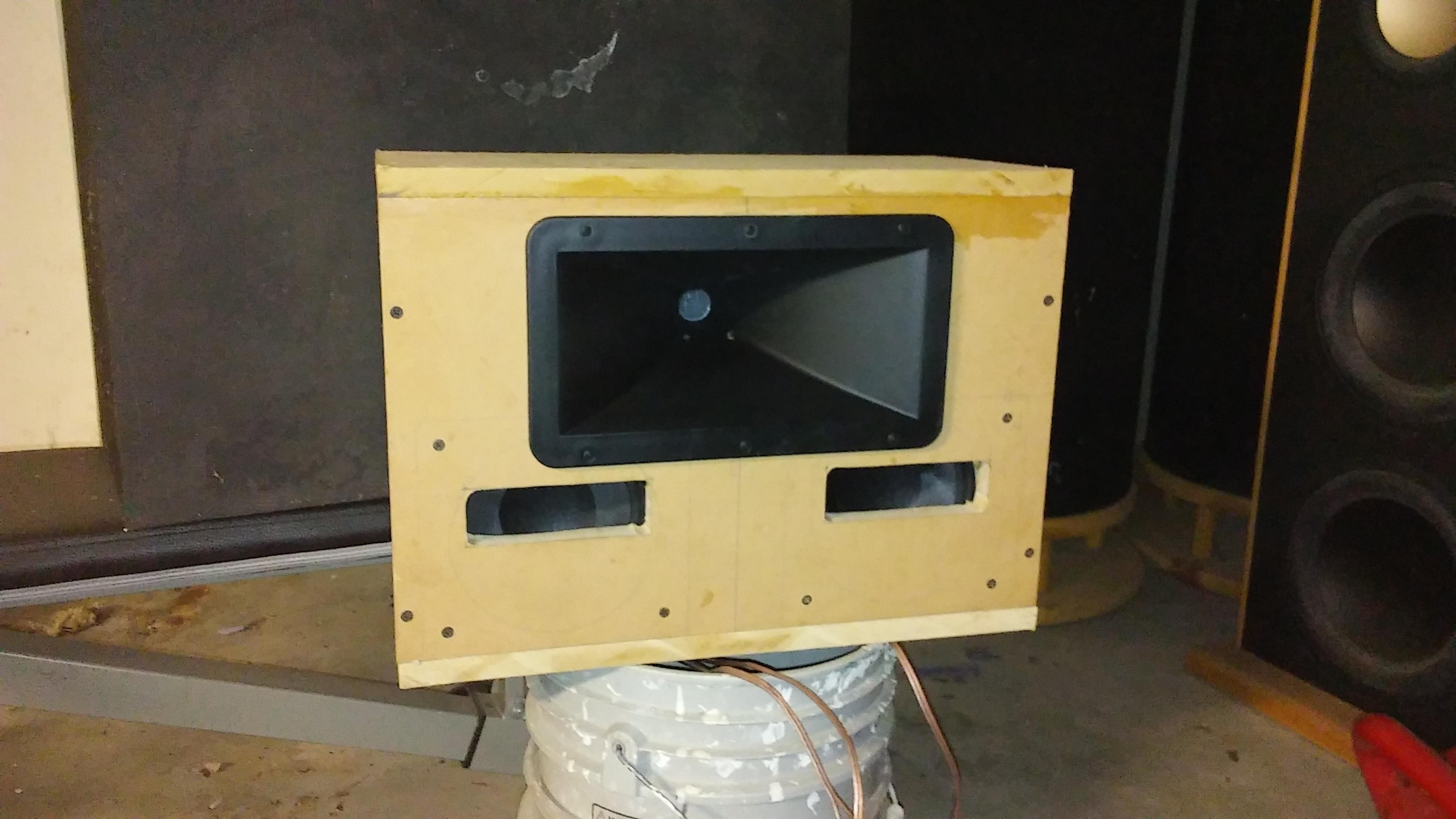

The original horn was the SEOS15 sold by DIYSoundGroup, and designed over at AVS Forums by committee. The end product design work was done by jzagaja. Final specs were listed here, but there is a lot of wiggle room there. Later talks put the throat at 16deg with a small conical section before the transition to the OS profile. It reads like this was for the fiberglass horn, so I assume the plastic molded horn used the same profile.
I have never seen an SEOS15, so this should be fun.
I have went through multiple dozens of designs, done in several different ways, and narrowed it down these two to try out. They were designed in two different series, and both are close. These are the targeting shots.
From left to right they are models 15b and 15bb3.
Polars shown with the same layout with Horizontal up top and Vertical on the bottom. No cd throat length added here.
The pink trace is 45deg. 5deg spread from 0deg on up.

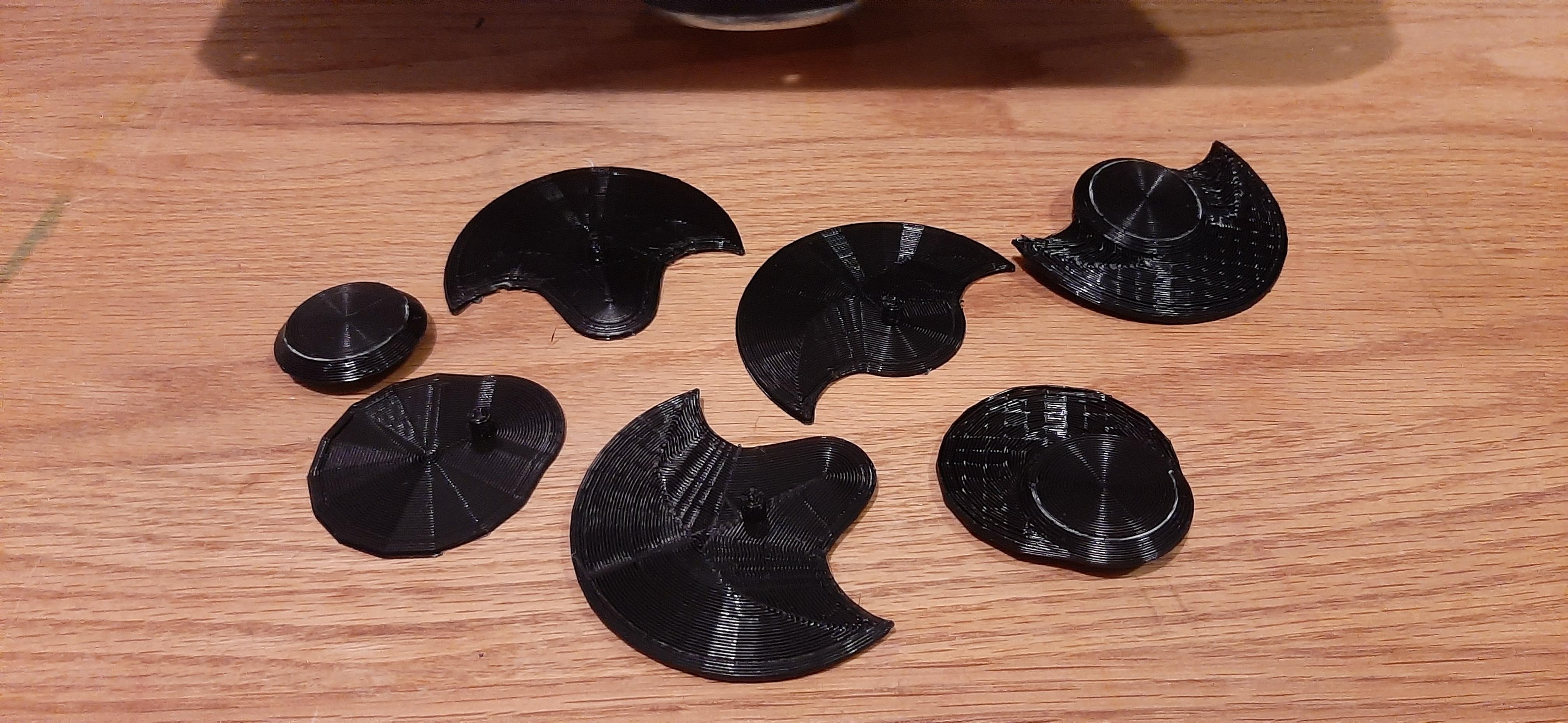

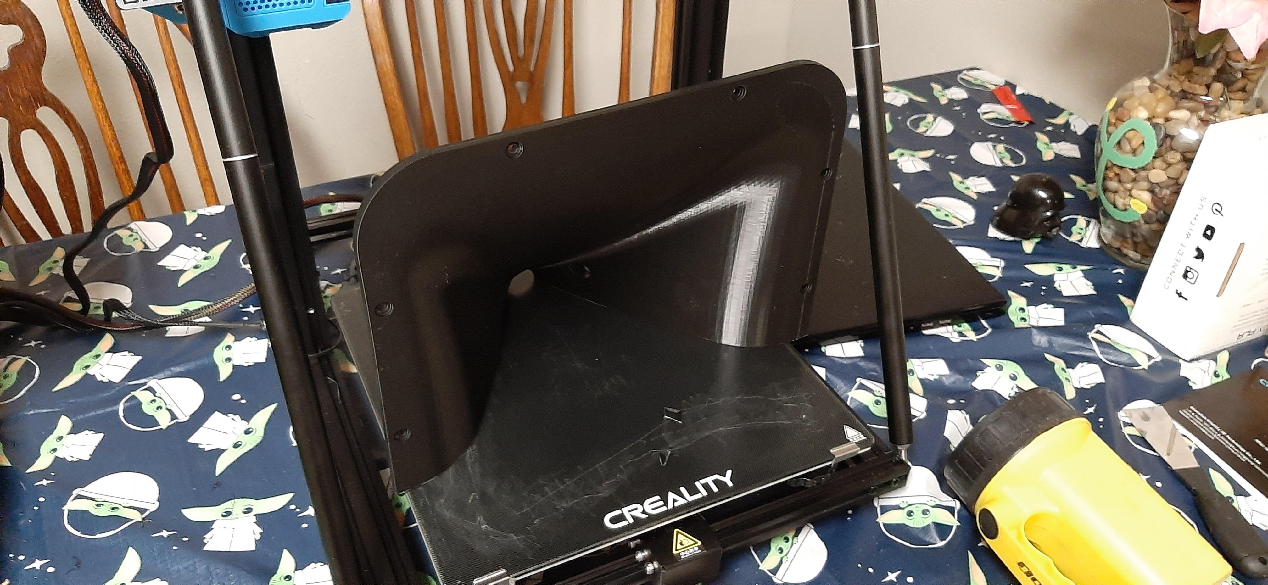

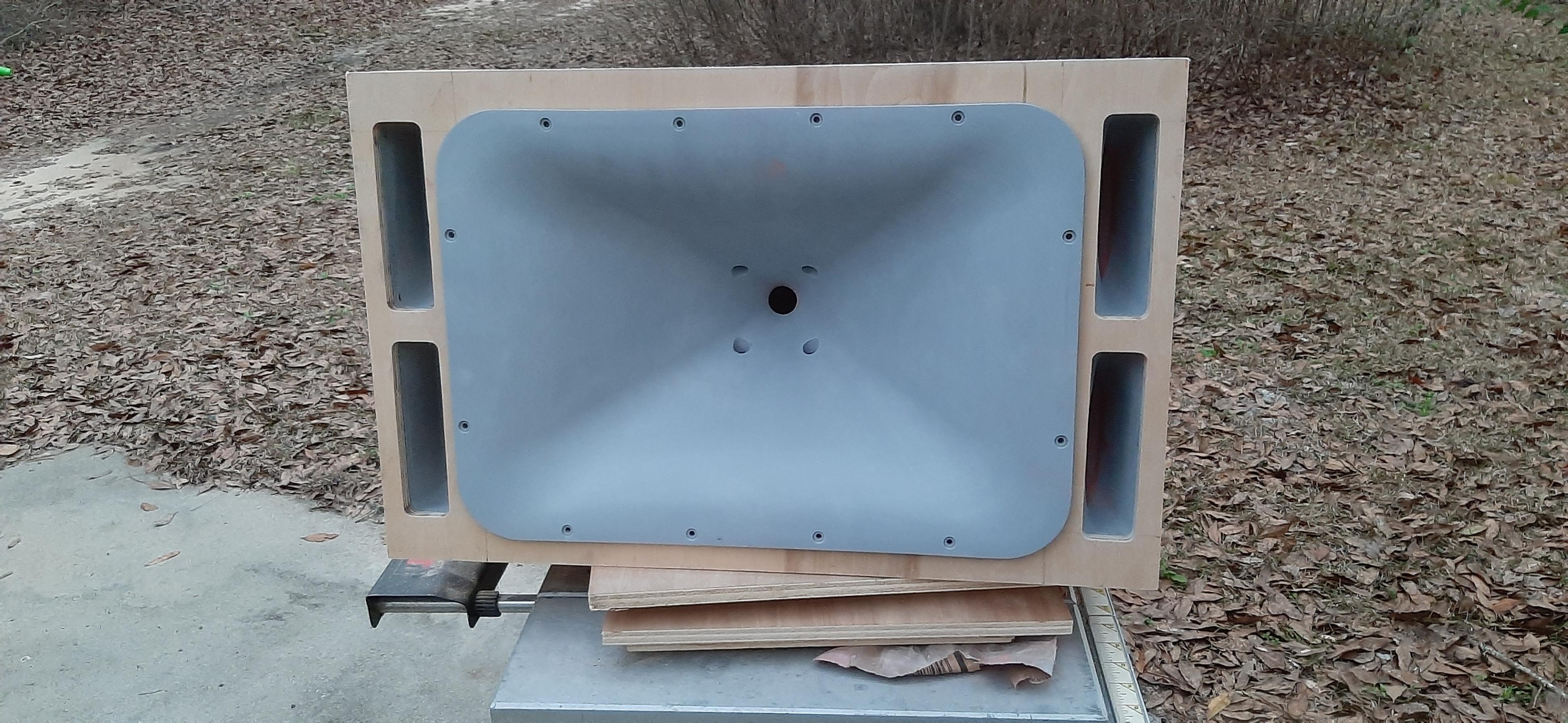

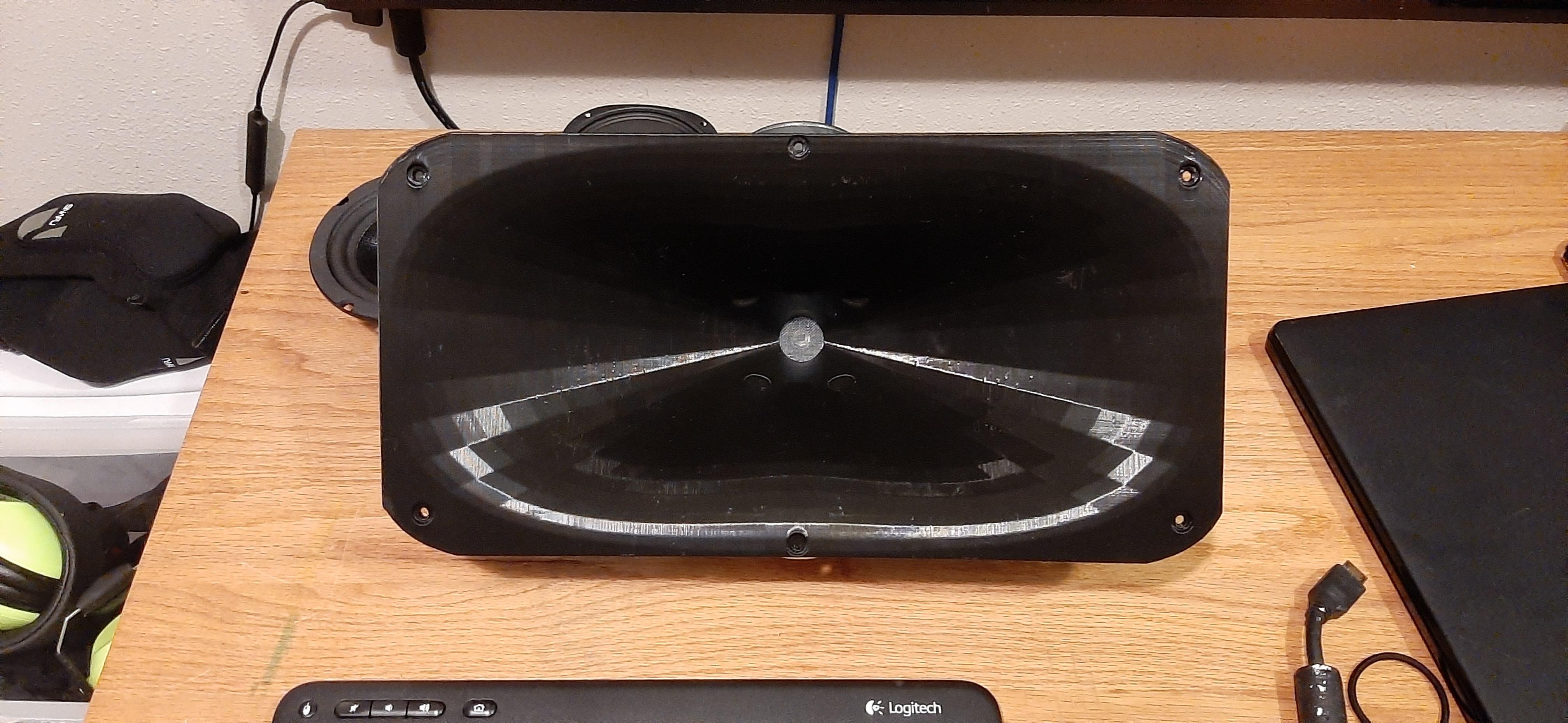

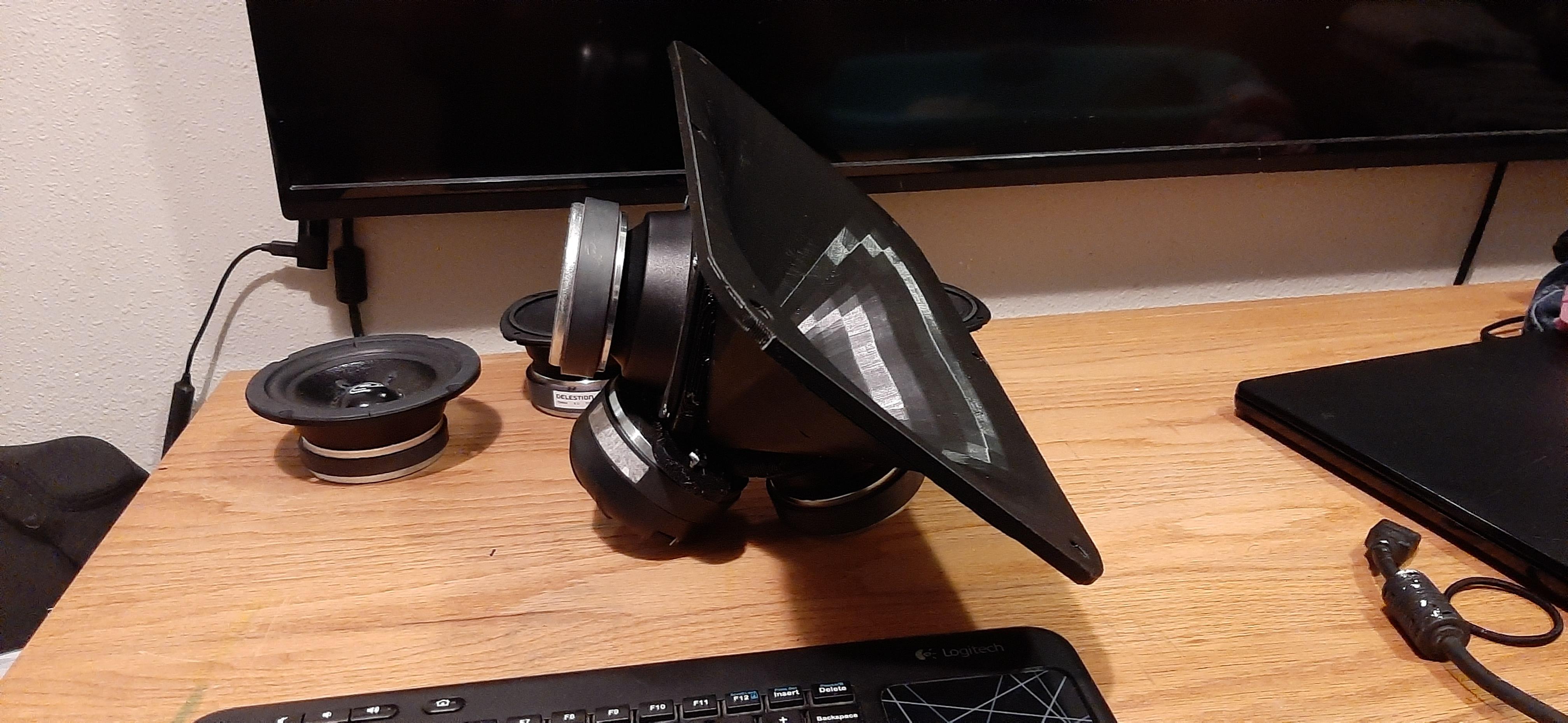

I have the first one (15b) printed out (draft quality in one piece with a .8mm nozzle) in low poly mode with the first two shots at the mid taps ready to go as well.
I have different tap locations on each side of the horn, and printed a few easily changeable plugs to dial in the mid chambers needed.
I didn't notice, but the edge showing doesn't have the brim completely pulled off. It is straight.

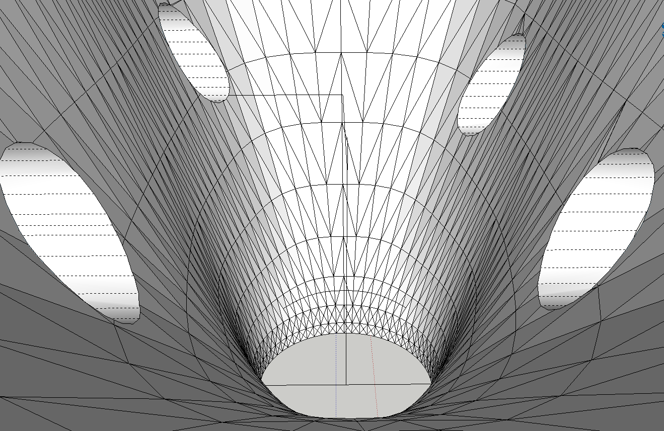

I was looking at your print and I saw that the surfaces seem to be small rectangles. Is that what you mean with with draft mode? The kit is looking great. IMHO, you may need a little bit of extra with on the bottom flange, the screw mount looks to close to the final round over of the waveguide.
The large rectangles would be the low polygons count. It is faster to test tap positions with less geometry to deal with, the way I do it anyway... Once I am happy with placement I will transfer it over to the higher poly model.
Draft mode is in reference to the speeds I printed at. It was as fast and hot as possible with my setup while still holding full surface integrity. There is ringing in the y axis and zits visible, but no under extruded or sagging areas. It isn't pretty, but the horn (especially the throat) is smooth and doesn't require any touch up for testing.
As you noticed the middle screw holes are technically in the mouth edge. When I first started designing the horns I was trying to stay away from a direct drop in, but once I realized I could print the whole horn at one time if I did, I came around. I just minimized the mounting surfaces to work with what I had already.
In this case there is a difference of a little less then 2mm from one side of the screw head opening to the other. I recessed the #6 pan head screws just enough for it to fill in the area slope pretty close. I will run a pass with the offending holes filled in as well to see how they effect things. I'm crossing my fingers that it is really too small to even show.
The lighting, large polygons, and glossy surface from printing hot makes the mouth look like it is terminating much faster than it is.
If I can get these to work I also have a split version mocked up for smaller printers, along with mid configurations of 2, 1, or none.
Very nice, what 3D printer do you have? (prints look great)
Any thoughts about going beyond the seos design (if there are indeed improvements to be made)? (I notice that PB has more complex than the normal entry ports perhaps this is something to persue?)
I have never seen the low polygon count, but makes perfect sense. Your high speed print has no warps or cracks, so pretty good. I assume it is pla. I like the spilt version like bwaslo did in one of his projects.

kipman725, it is just a CR10 v2. I just took the time the adjust everything right out of the box, and then spent many evenings printing 3D Benchy over and over until I dialed in the settings.

I have flat mounting sections on the rear of 18mm on the top and bottom, and 22.25mm on the left and right.

That's why originally I was using totally different dimensions. I changed my mind on the differing dimensions to allow myself to print them in one piece, and it allows the original build plans to be used as.
Throat, profile, mouth, and corners all mine. Height, width, depth the same for using original build plans and depth also for phase.

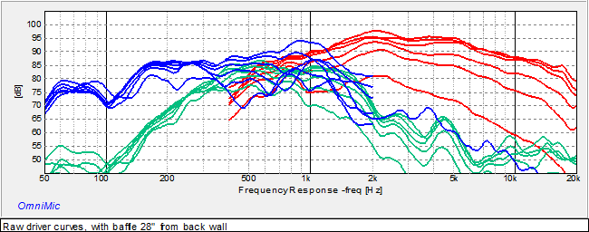

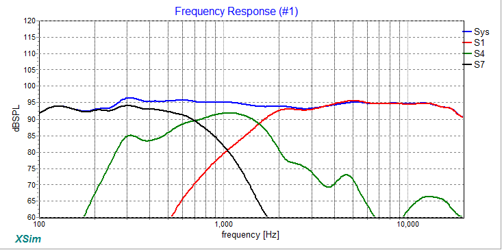

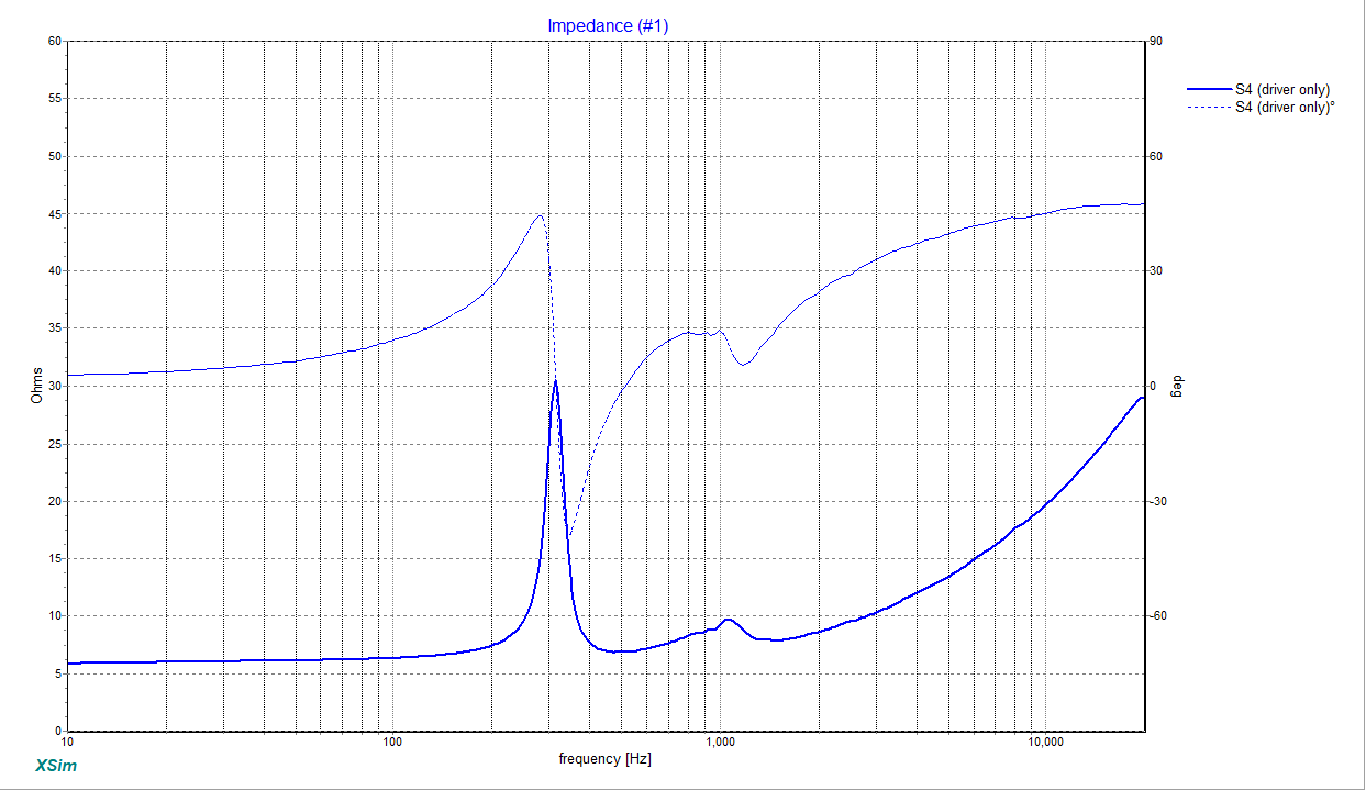

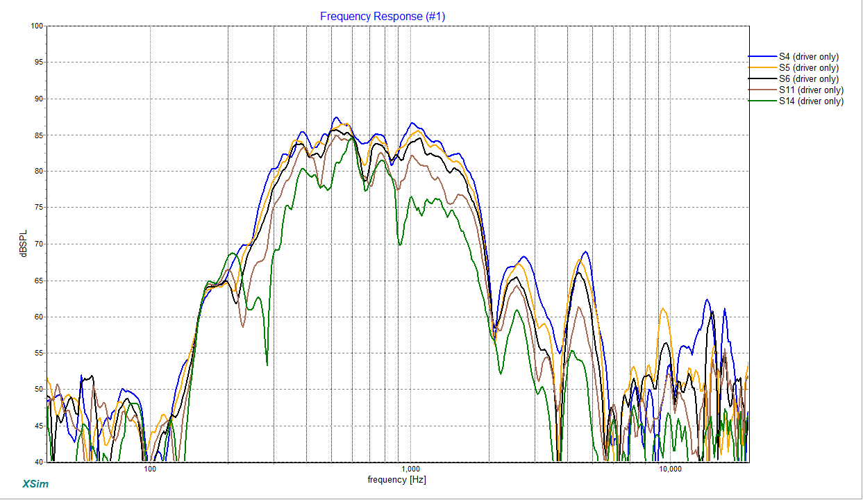

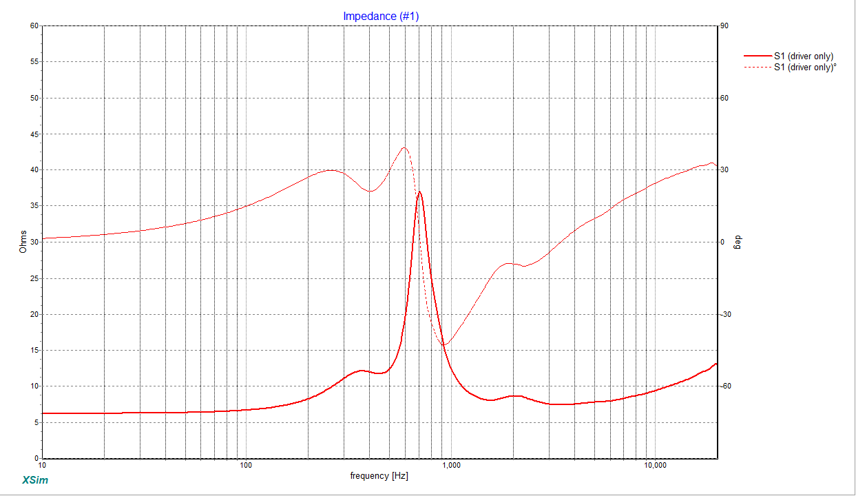

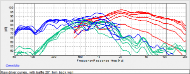

These are all the target images from the small syns thread that I am trying to recreate.
The directivity is the ran at 0, 20, 30, 45, 60, 90

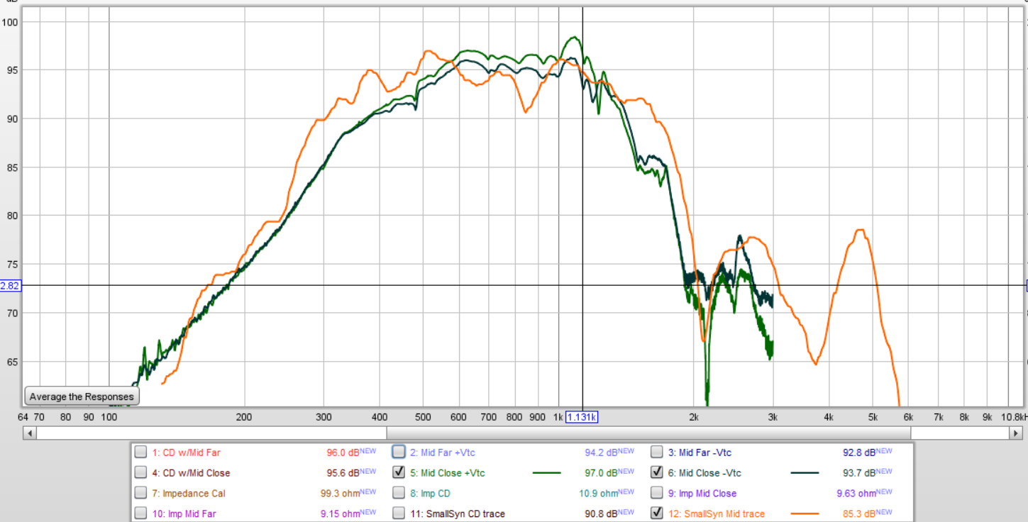

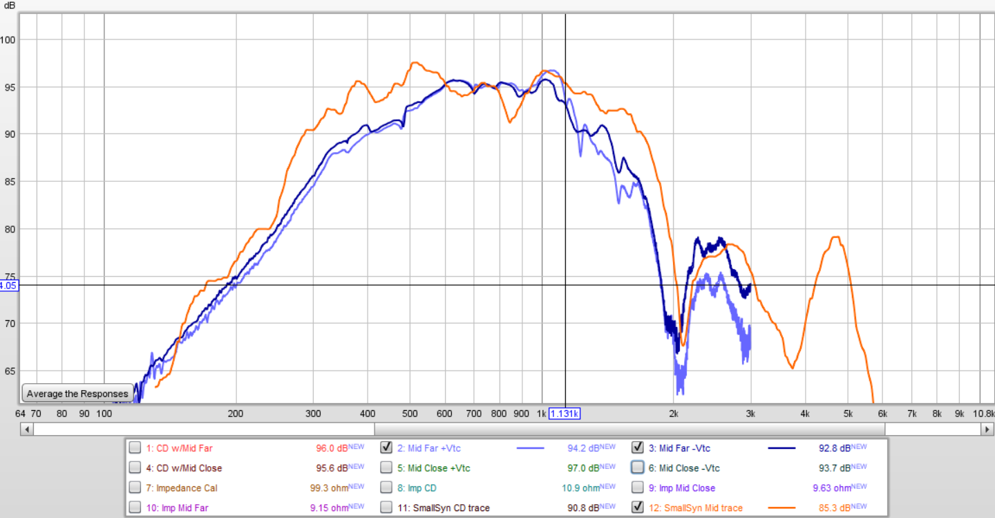

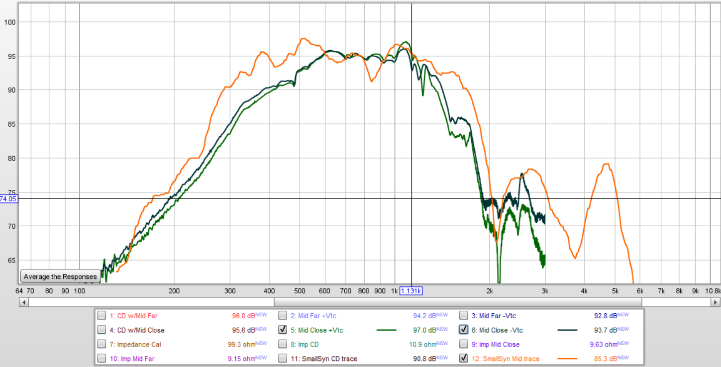

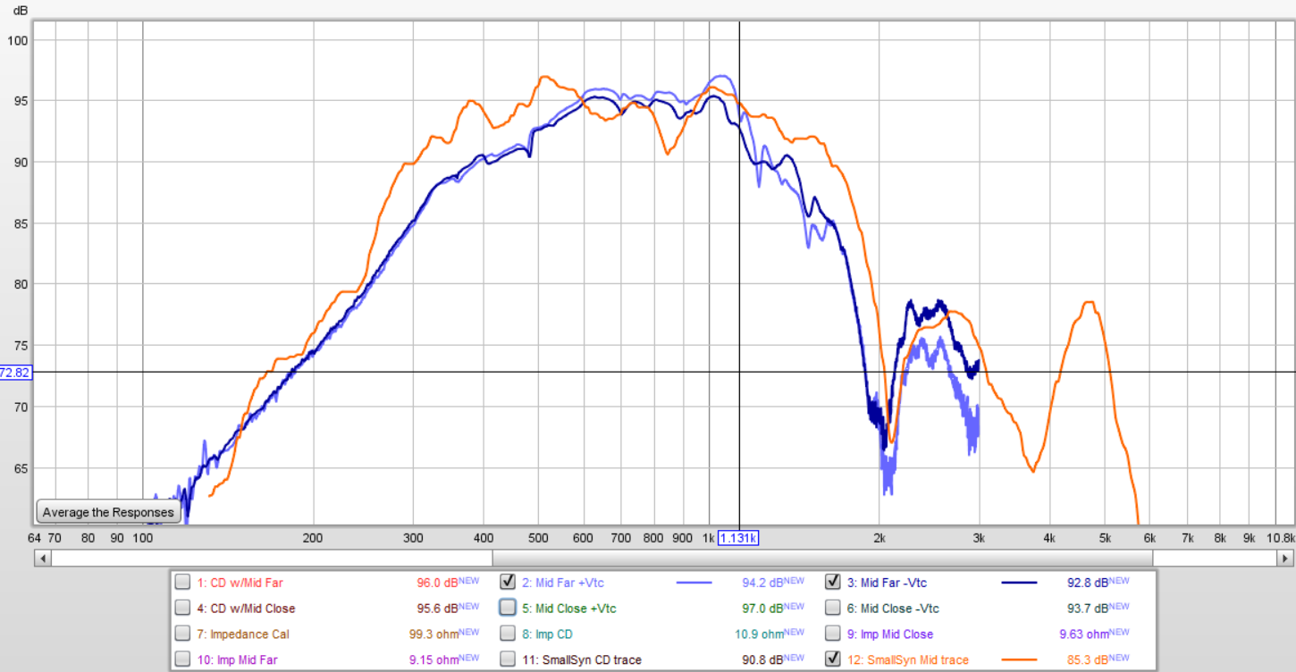

Here are a few quick and dirty measurements.
My IMP jig seems to be showing it's age as there is a little fuzz in the higher frequencies, but it works here.
These are taken with the CD, but with no baffle. This means they roll off a little early. I didn't think of a fix until later, and wasn't going to do them over due to time constraints. The mids are tested separately with cheap duct tape covering the non-tested holes, as the cheap stuff peels off easier. 😀

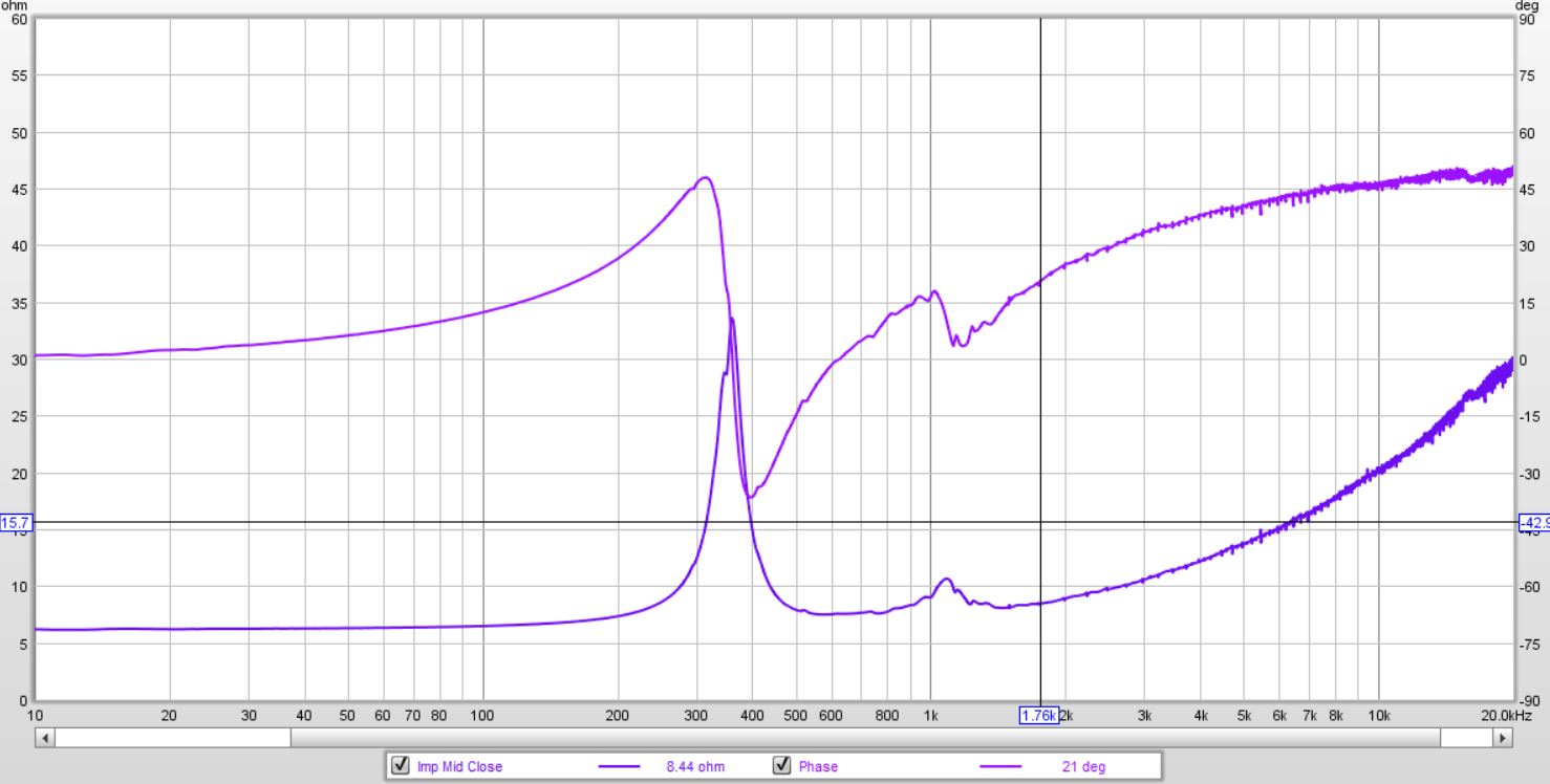

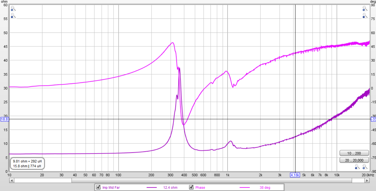

They were both tested with the base model mid chamber (+Vtc,) and with the max filler plug I had (-Vtc.)
I also added the 0deg raw polar Mid trace from the original thread that was added as a target above.
Looks like the Far and Close ports fell right above and below the needed 1/2 wavelength null. This makes final placement a lot smoother.
As shown, the notch at ~1.5k still needs to be brought up a lot. I shows the ports area are too large and will need to be made smaller as the mid chamber is already about a small as possible. Lengthening the port could also do it, but there isn't much play there. The question now is play dough or wood filler?
There is also the option of aggressively adding camber volume to raise the two notches below and use the bandpass upper corner to rub the 1.5k notch out. I haven't tried it before, but it should work after a fashion. I'll print up a spacing ring to test it out later.
The first set is real SPL, and the second is with the two matched to show the end result change more clearly.

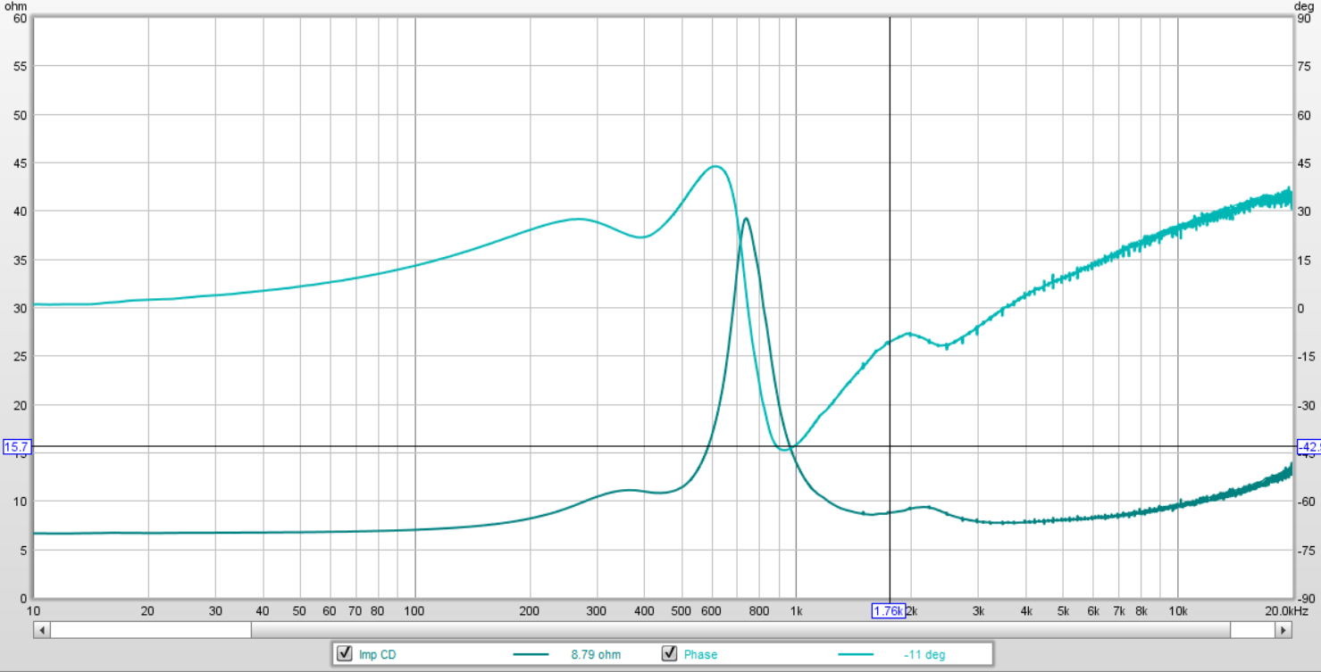

These are just fast passes to make sure things are going in the right direction. I didn't adjust the windowing here so ignore the fuzz. Once I finish my new measurement tower things will get more serious.

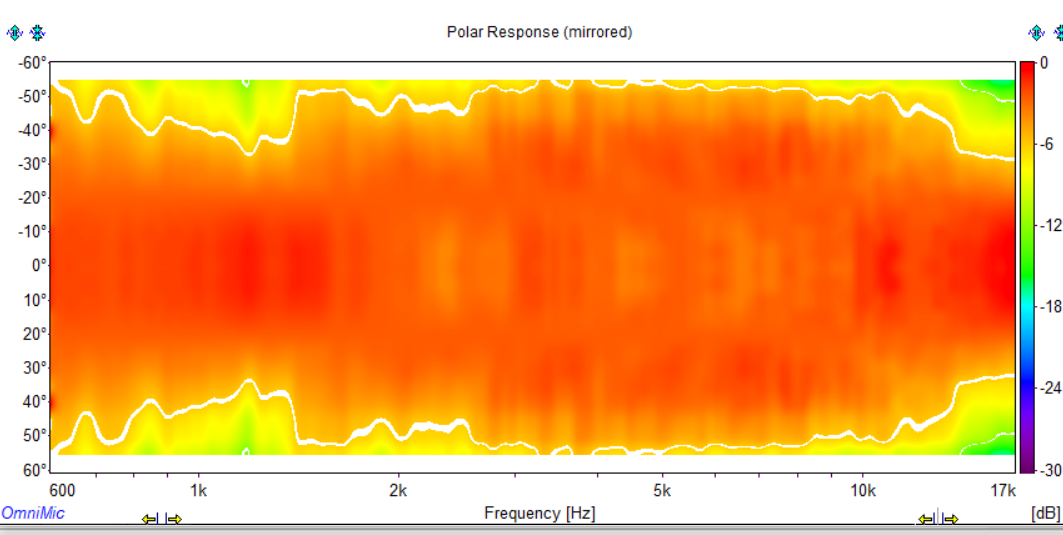

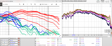

After a few unsuccessful attempts to get usable baffle free CD and polar test measurements I came up with a dumb idea.
I used my old SmallSyns H290B test speaker turned around backwards as a stand on the base of my WIP polar rig (bucket pictured not part of polar rig.) It is the same size as the sealed SS, so it should work horizontally with the new horn sitting up top right on the edge, right?
The directivity on the target was ran at 0, 20, 30, 45, 60, 90. I did 0 to 55 at 5deg steps, so I have 55 instead of 60.
I used SplTrace to add the 0deg run from the target to the REW chart, same as before.
The polar map is smoothed 1/24th and normalized to 20deg. It looks like a SEOS 15 & 18 love child.

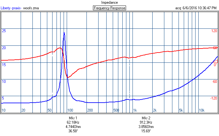

The Imp is no baffle. I didn't redo it. These are just tests.
