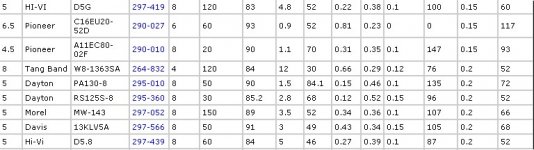

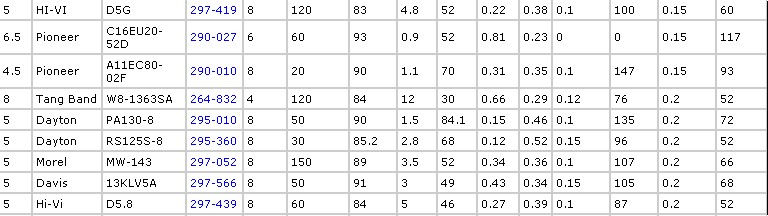

Here is Part Express's Selection for woofer in that cabinet size. The second to last column is the net internal volume of a ported enclosure, the last column is the F3 point.
