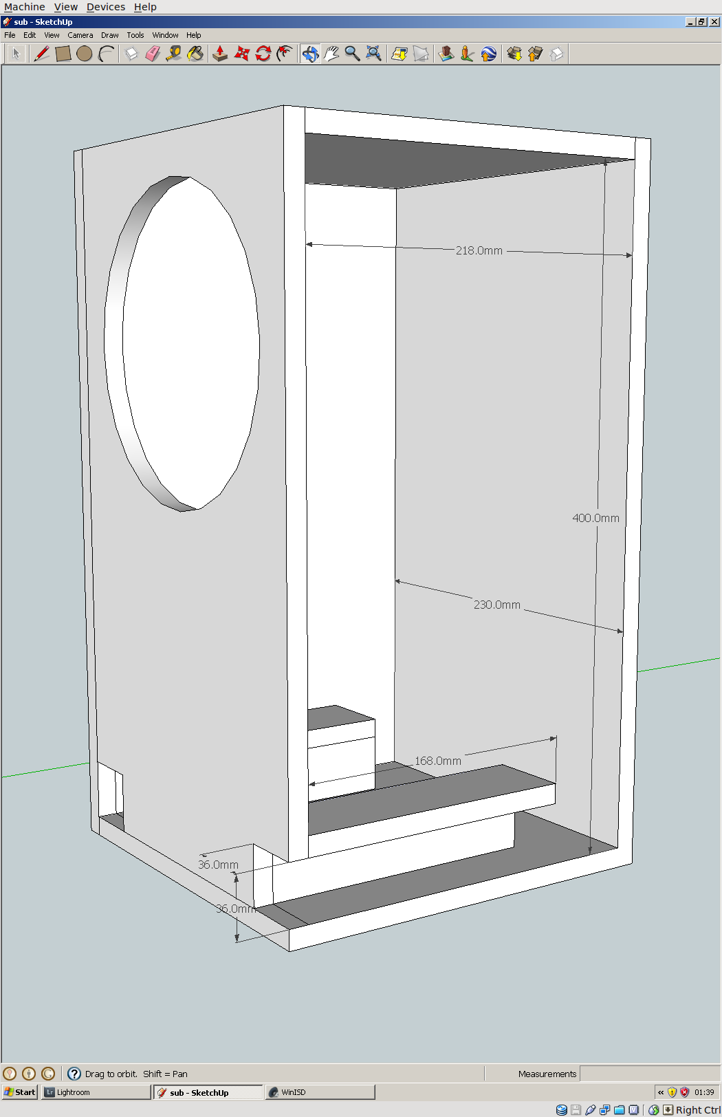

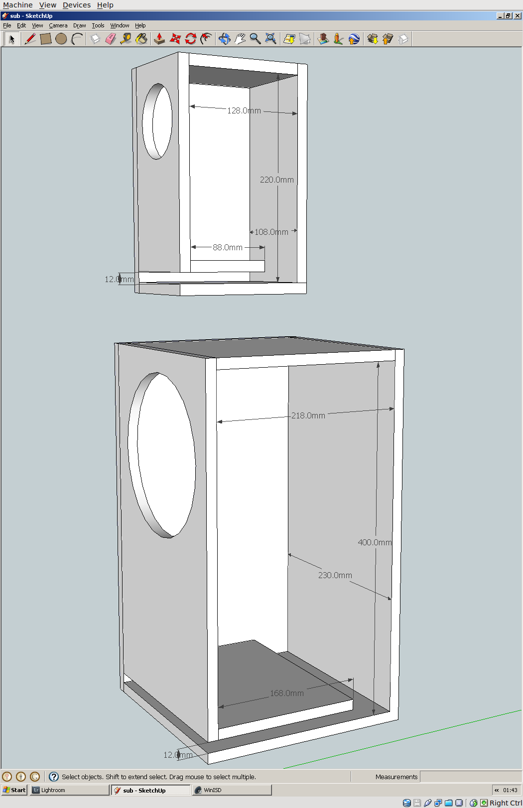

Still playing with the idea of making my subs the right height to go under my speaker stands, I've come up with these.

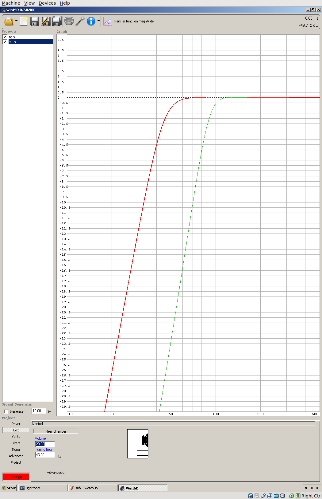

Tops are 3l tuned to 95Hz, subs are 20l tuned to 43Hz (exactly 43Hz at -3dB according to winisd). Assuming 12mm wood, probably MDF as it's cheap & easy to work with but I might go for birch ply if I get my local joiner to do the cutting.
I don't know if these are sensible shapes for the enclosures though?

One thought, the slot port in your design has a ratio of 1:9 (Height:Width) that's about the limit (above 1:3 port compression becomes an issue). As long as it will be used at low levels you'll be fine.
edit: You don't need to worry about the subs being directional if they are directly under the tops. If you are tuning the tops to 95Hz and are planning to put the "subs" directly below them, cross well above the tuning frequency of the satellites ~200Hz. That way the delay imposed on the satellites by the ports will be taken out of the equation. If you can get to 200-400Hz without ports I'd do that instead and just cross at the natural rolloff F3.

Your concern about the slot port ratio is the exact sort of thing I meant when I said I didn't know if it was a sensible shape for an enclosure! I chose that design because it would be very easy to build, but it shouldn't be too much harder to have 2x squarer ports like the attached image (dimensions/length according to WinISD again, not just guesswork) - would that eliminate the problem?
Will port compression be an issue for the tops (if I decide to keep them ported) as well as the subs? Due to their size it would probably make sense to have a taller/narrower central rectangular port rather than 2x square ones like the new sub design.
Edit: Just been playing with WinISD some more wrt ports. Is it preferable to have one shorter port (36x36x751 '1st port resonance' 2287.51Hz, new image attached) or two longer ports (35x36x168 '1st port resonance' 954.79Hz)? Will 2x ports reduce the velocity of the air at the ports' mouths or something?

You're right about multiple ports reducing the velocity of the air at their mouths (Google agrees at least!) so I think I'm going to try the 2-port design, at least for the first sub - MDF is cheap so I guess I can always build the second one slightly differently & if it sounds better change the first one to match.
Changing the top to have a square port instead of a slot port couldn't harm either - it's now essentially the same as HEL's Tekton clone but 0.4l smaller.

Winisd has that backport air velocity or something like that that shows you the velocity. You can also change the power to higher from signal so you can see the it better. I think you might also want to check cone excursion chart to see how much it moves.

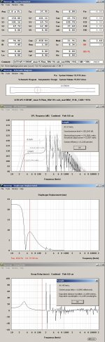

I've done some winisd simulations with W8-670C:
grey = winisd original calculation 20 litres ported (tuning freq. 40hz)
orange = same as gray but with 25 litres volume ported (tuning freq. 40hz)
yellow = 19 litres closed box
http://www.abload.de/img/coneexcursion80watttf4nf.jpg
http://www.abload.de/img/groupdelayer6cl.jpg
http://www.abload.de/img/spl80wattck3qm.jpg
http://www.abload.de/img/tfmec20v.jpg
...i used the grey simulation and changed port dimension to 2cm High x 25cm Width x 39,43cm Lenght resulting in a good air velocity:
http://www.abload.de/img/portkfk1c.jpg
This is really a very good sub i think! You should use a HP filter at around 30-35hz/2-4th order to keep the chassis away from cone excursion!! If you're doing this right you can see in my simulations a very good SPL at 40hz powered with only 80 watts...really amazing little sub i think. I highly recommend the ported design, forget the closed one!
