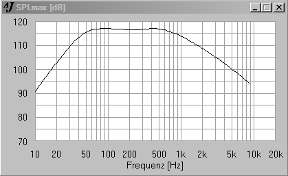

If used in a room, you could go for two high-excursion drivers like the sonic-10 from Carpower (+-25mm xmax linear) und put them in a 40l sealed Box, which gives you this, standing on the floor:
Of course, three will do better... Some EQ, and you are there.
