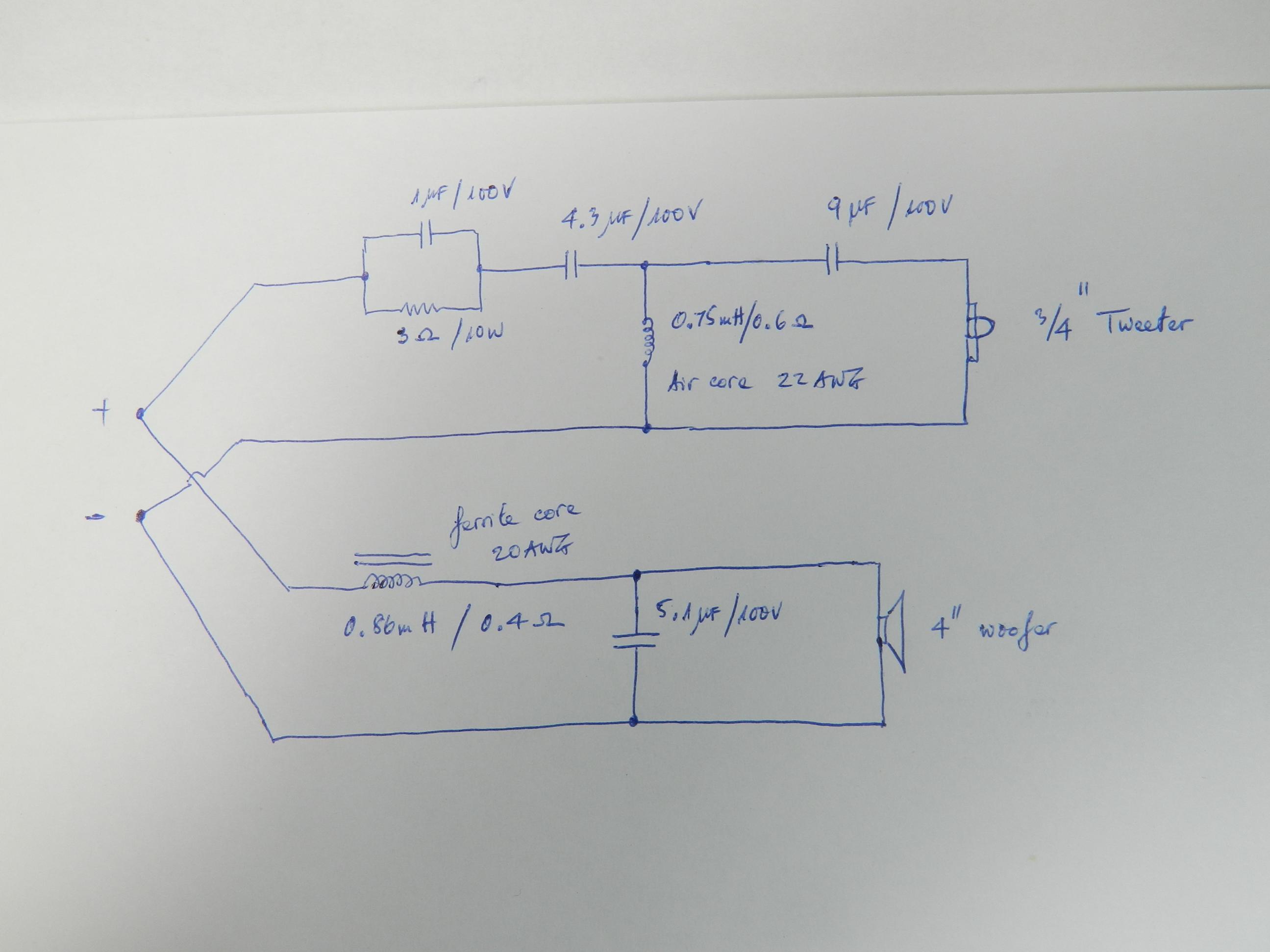

Here is what little info I could get on them
Tweeter
I realize the PDF is basically unreadable, but it has a bit of an image of the TM crossover. For whatever that's worth.

You've really got your work cut out for you here.
I assume that there are no TSPs available for these OEM drivers, so those should really be measured.
While the original crossover may provide a good starting point, in the details each crossover is unique to a given combination of cabinet and drivers, and is optimized by means of first simulation and later measurements.

Dave - You're talking horizontal MTM for center is not good? What do you think about the vertical MTM with that offset little tweeter for sides? I think it's crossed at 2.5k from factory.
tuantran - Thank you! Does that cross at 2.5k like the other one? My last one to figure out is what a TMM would like look with the top driver highpassed and the lower one doing midbass duties.

Crossover of 2.5k is 5.4". CTC spacing between woofers for the infinity design is 6". So no bueno...
Other option is to see how low one can cross the tweeter? I have extra, I guess I could sacrifice. How can I test to see?

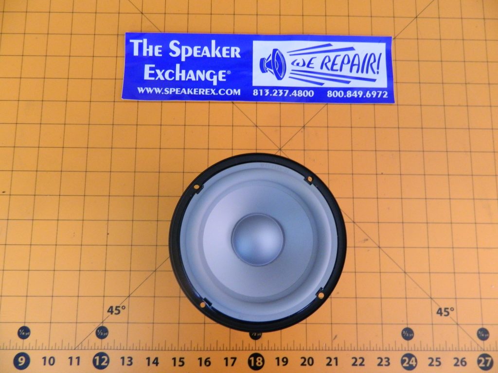

I have a lead on qty(8) 5-1/4" CMMD drivers from a different line for less than $200. Of course no measurements but should I go for it anyway? Then each speaker has one 4" mid and one 5-1/4" woofer to get down to the subs? Center can have one 4" and two 5-1/4". I know this is a bit of a janky build but we can have some fun with it no?
Is freq response enough to see if two drivers match up? I'm thinking of buying these 5.25" drivers. They are from the second iteration of the Primus line, mine were from an earlier line, the Modulus and the Entra. I'd be looking to have the 5.25" do a narrow range from about 300 down to subs. Or should I just stick with two 4"? Worried about the midbass band being weak vs complexity of trying to integrate different drivers with unknown t/s.
Picked up eight 5.25" drivers today for $150 CAD.
This is all the info I can really find on them until I take a look at the crossovers they came with.
Infinity 5.25"
Good news is that they are used in a center channel, the PC251 in sealed configuration. They claim to get down to 80hz in that small enclosure.
