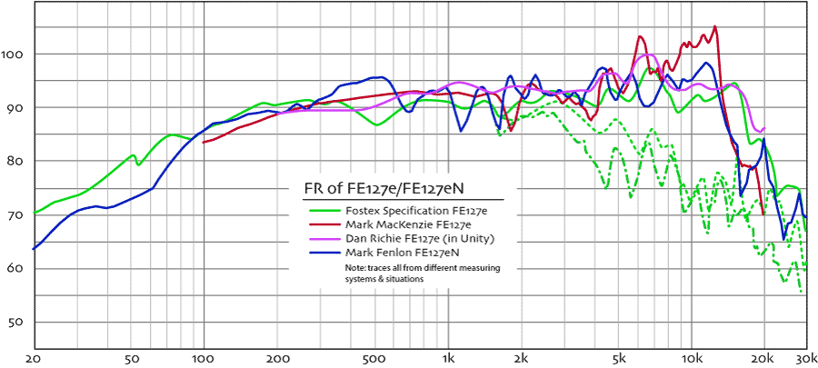

I stumbled across this small speaker comparison from 2007 the other day and read with interest about the Unity Audio speaker using what looks like a Fostex 127e in a simple ported box. If you scroll down to 'SHOOTOUT #4' you will see the speaker lost badly in comparison to the other. The comments were so unflattering it called into question why i prefer 'full range drivers' at all. Just curious, do you think full range drivers are an acquired taste?
no, this is just a bad implementation.. my guess is that it lacked a BSC
and there must have been something else wrong as well given the comment "not much imaging or soundstage"....
I couldn't agree more - from my own experience with at least a dozen or more designs with the FE127E over the past 7-8yrs, you've got to work pretty hard at getting it to not deliver on imaging/soundstage and for that matter reasonable lower midrange and upper midbass.

No BSC on the speakers in the shoot out. Check the bottom of this page for comment and measurement: Stereomojo Small Speaker Shootout 2007 Measurements

Instead of bandaiding the peaky bits with a notch, i tackle the issue where it occurs on the cone.
I've added Ritchie's measure posted above to my comparison collection (the new purple curve)
dave

When I got the pair of 127's Dave sent me, they measured better than the "speaker Shoot out guys". I used an fully calibrated lab set-up in an anechoic chamber. From what I've read, their measurements are "in room" so their results shouldn't automatically be considered as reliable.
We took the pair of 127's into our factory's test listening room. They sounded very sweet when compared to 2 big brands (sorry I'm can't say who they are) of bookshelf systems using 4" and 5.25" woofs, 3/4" and 1" tweets. The 127's were far superior in terms accuracy of music reproduction provided we kept them inside their low power handling limit. The 2 way's tweets were emitting allot of micro-resonance distortion even though the responses were near flat on LMS anechoic.
I think the Shoot Out Guys didn't do enough to get the best from the 127's so in that respect, it was something of an unfair skewed contest. I wasn't around in 2007, times have moved on with more full-rangers on the market from of variety of makers. Running a Shoot Out like their's today would I'm sure would give different results.
