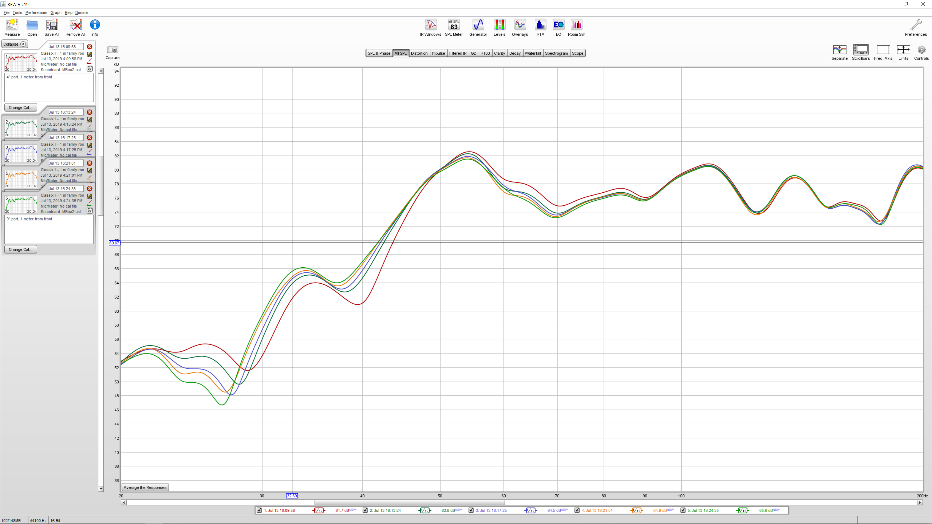

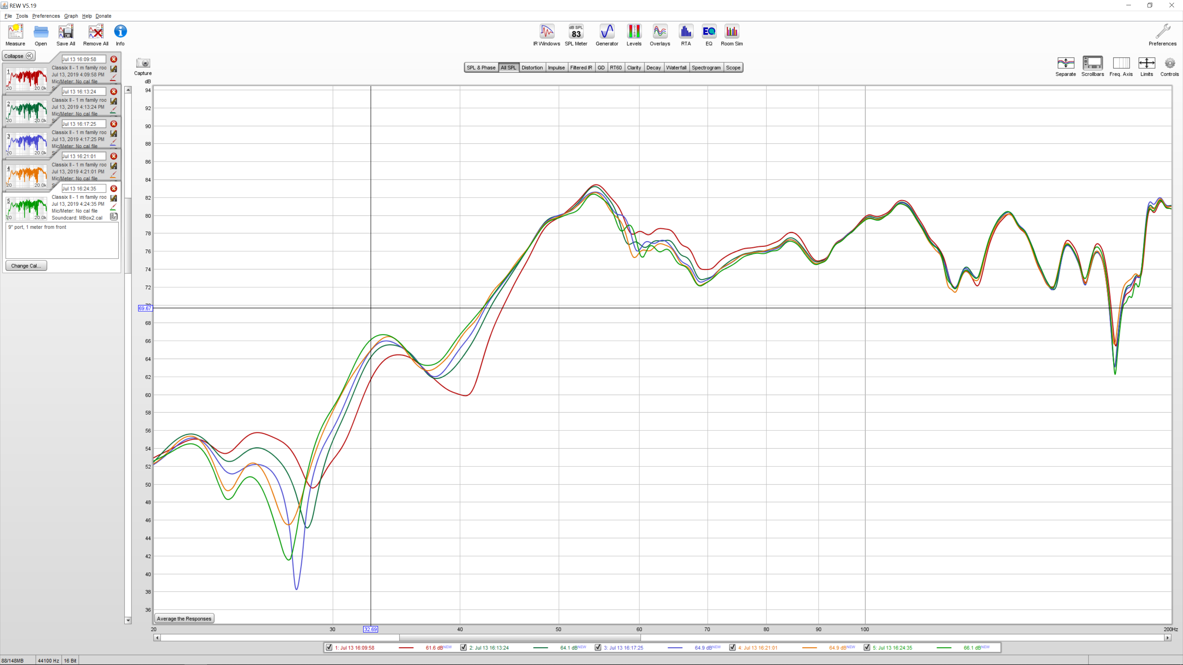

I built the Classix II kit, but left one side and the baffle unglued, and just held them in place with clamps. Then I tested the speaker with the stock 4" port, as well as with varying lengths of PVC pipe taped to the end in order to lengthen it one inch at a time. Close measurements clearly show the tuning frequency dropping as expected, but it's interesting how far measurements are so affected by my living room that the tuning difference gets masked.
Here is REW's graph for 9", 8", 7", 6", and 4" ports, all in the stock PE cabinet. I have damping material on the back, but nowhere else yet. I put my microphone about 1 meter in front of the speaker, with it positioned against the wall next to my organ console like it will be eventually. I figured this would capture the output of the port as well as the woofer, but of course, also the quirks of the room.
I put the cursor at 32.7 Hz, the frequency of low C, and it looks like the longest port does produce the most output down low, as expected. The difference between the 7", 8", and 9" ports is fairly small, however, but all of them clearly outperform the standard 4" port. The second screenshot shows the same graph with 1/12 octave smoothing for all the measurements, and that shows the improvements from lengthening the port pretty clearly.

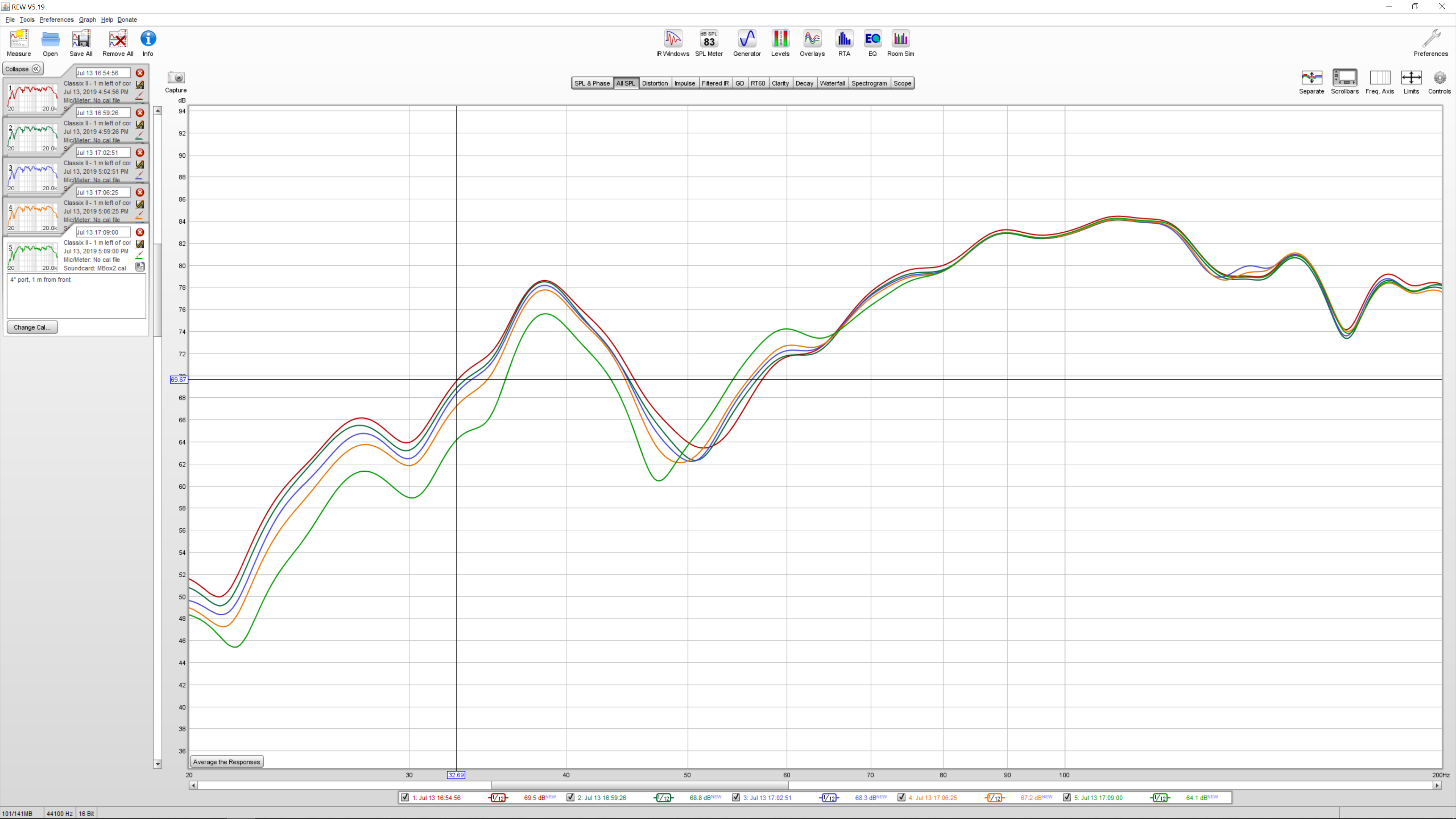

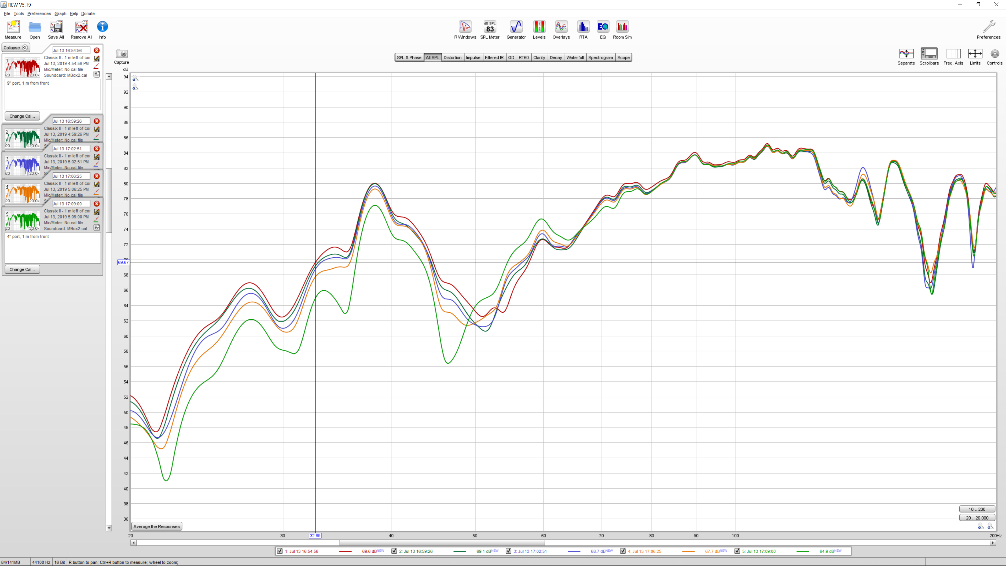

I also tested the speaker the same way in a different room in order to see how it would affect the response. These measurements were also taken from 1 meter in front of the speaker, but the speaker was in the middle of the room this time instead of against the wall. I don't know how much that might have affected the response. Here are the curves raw and 1/12 octave smoothed.

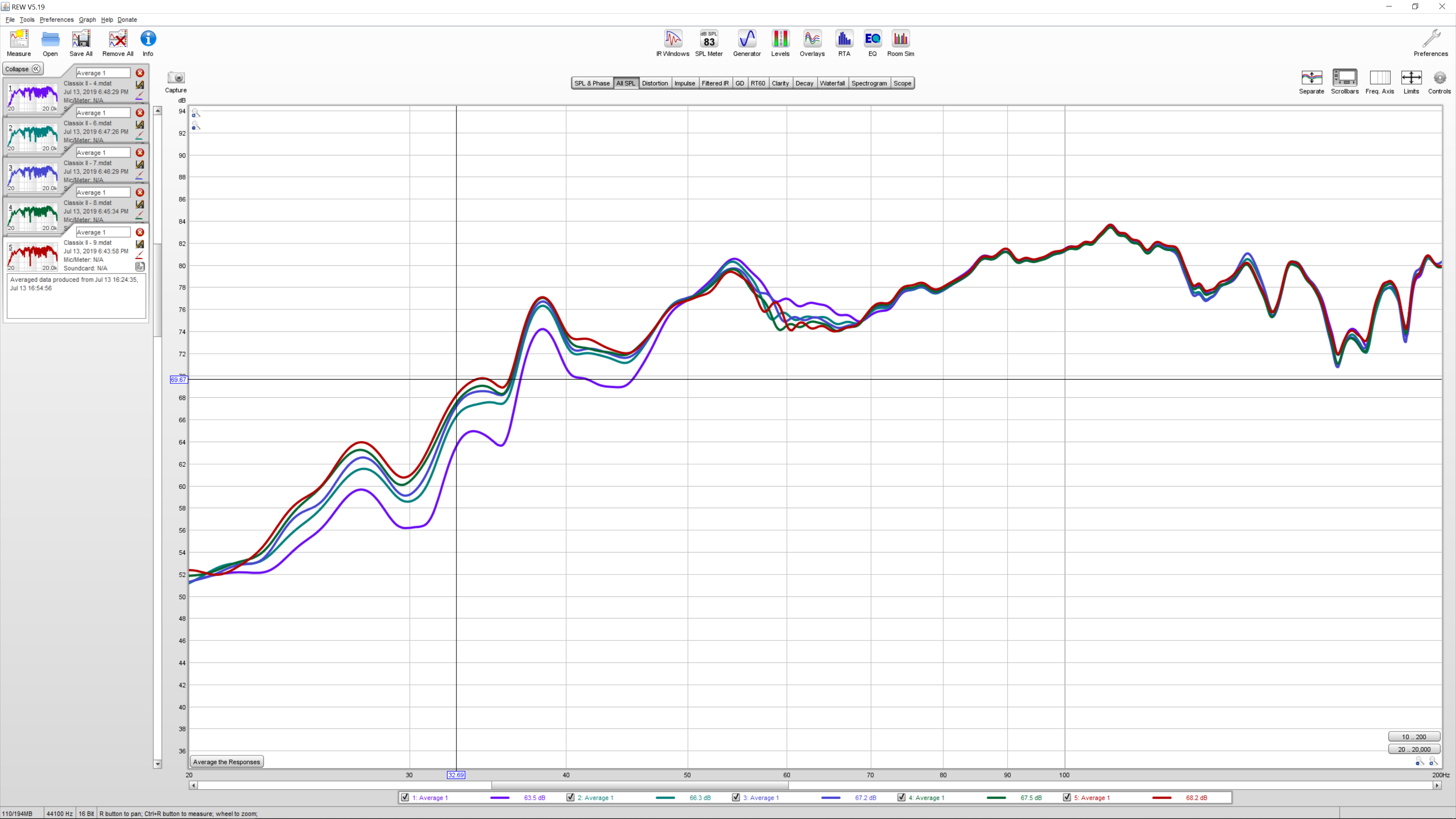

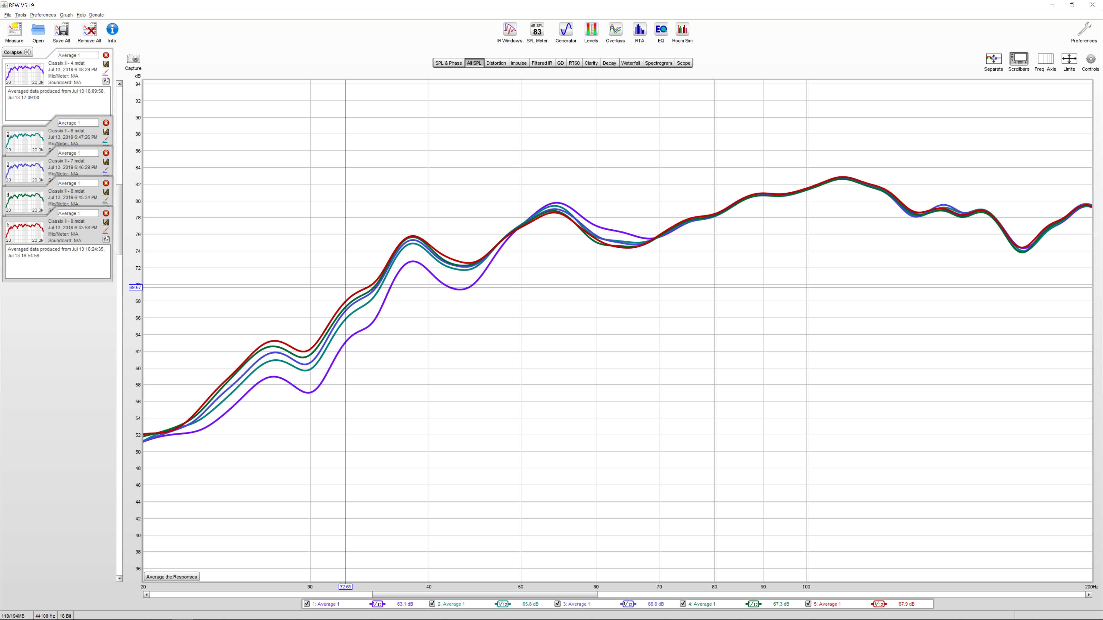

I think I'll try exporting the data and averaging the measurements across rooms. That should help remove some of the effects of the rooms.
I did some averaging in REW and came up with these curves. I'm either going to go with the 8" or 9" port. Both give measurably more bass in the low range where I'm concerned with the output, and both reduce the peak in the mid-50 Hz range that's present with the original 4" port.
