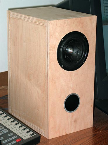

I know it's not the favorite design here, but just for comparison, here's one of the cabinet I just finished for my TangBand W4-1052sa's. Just under 7 liters, a 65 hz f3, and 88 db efficient. Thermal power handling is 40 watts. There's a prefilter in there per MarkMck's design which flattens the upper mids and extends response to around 17k.
Xmax is 3.4mm on this driver compared to the Aura's 5mm, but larger cone gives the TB an advantage in swept volume. With the little t-amp in my office, these can get obnoxiously loud!

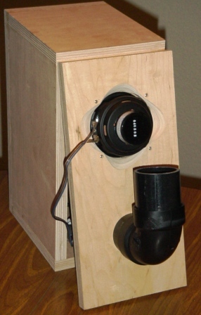

Oh, and here's a shot I took before the front baffle went on. I know I went nuts with the port diameter (2"), hey, nothing exceeds like excess! I also figured it would help with standing waves in the box because it presents a round cross section between the parallel walls.
