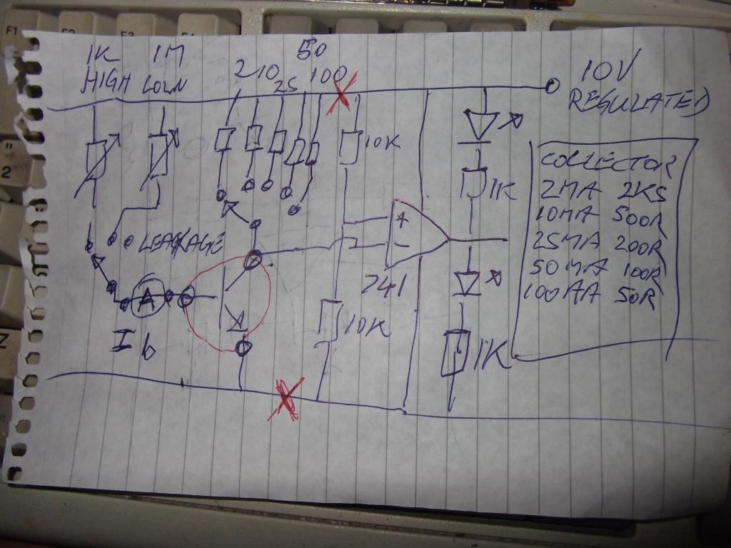

I have a home made transistor tester that I built over 30 years ago for that very job working with parts from those big bags of surplus components that used to be sold by those nice old electronics shops that are no longer there.
It measures at several currant settings so that you can make the points for a paper graph.
This is the transistor tester I built over 30 years ago for this kind of job.
The two red markings are where the NPN/PNP switch goes.
It uses a switchable collector currant and you have to calculate the HFEs.
It is a teenage build poor mans curve tracer all be it fiddly to use but where the hell could you get an affordable curve tracer from in the 1970s.
