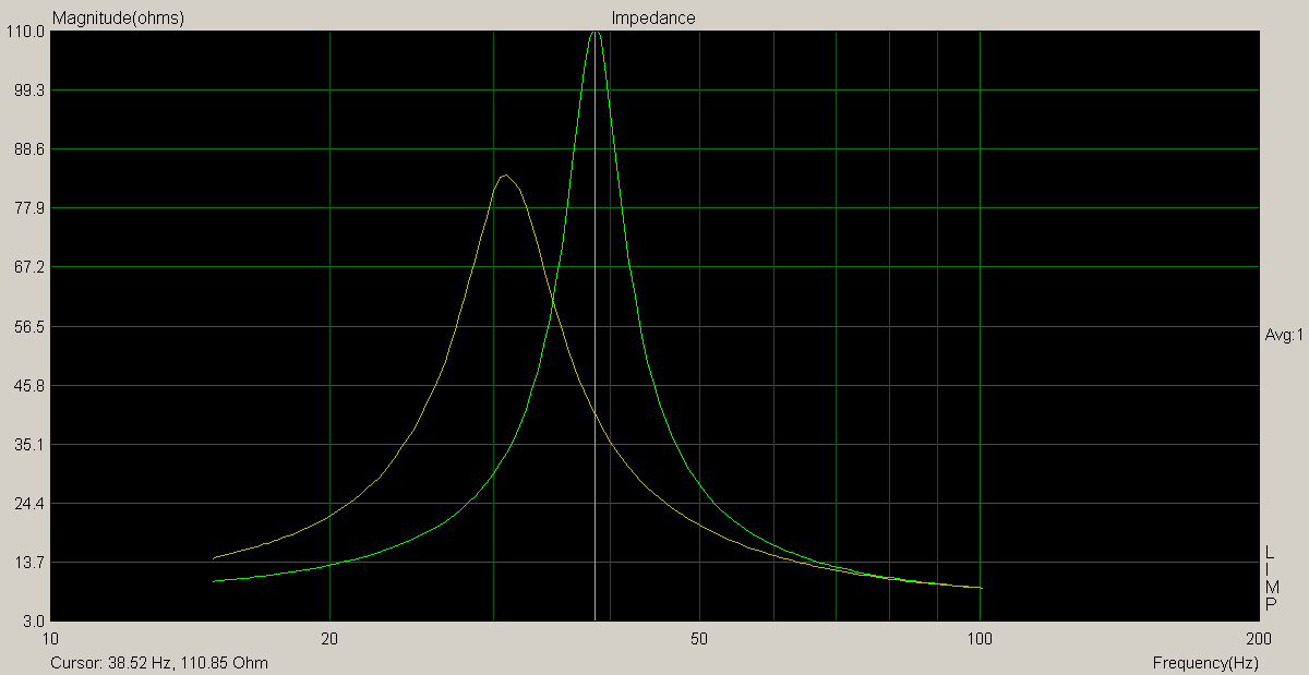

Upon receiving my Visaton AL 200s I was amazed at what large an effect the driving voltage has on their impedance and therefore on the measured Thiele-Small parameters. I measured them in LIMP with a 15-Ohm reference resistor using the stepped-sine method at different voltages at the amplifier output, which revealed a general tendency for Fs and Zmax to decrease as voltage increased. Here are the results of two measurements:
Code:
Udr, V   Fs, Hz   Zmax, Ohm
2.56     31.5     83.5
0.16     38.5     110.9
The corresponding impedance graphs are attached.
Is this the expected behaviour, and if so, why do manufacturers not specify the method and signal magnitude whereby their datasheet figures were obtained? Should not one measure the small-signal parameters with the smallest signal capable of yielding the required signal-to-noise ratio?

Yes, quite normal.

Here are the quick (small-signal) measurements before and after warm-up:
Code:
|     Spec   Fresh   Warmed-up|
|Fs   32.0   39.3    37.6     |
|Qt    0.35  0.50    0.45     |
|Qe    0.39  0.54    0.48     |
|Qm    3.73  8.41    7.19     |
It looks as though the amplitude of the signal has a stronger effect than the preliminary warm-up.

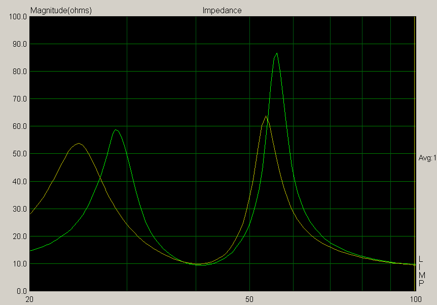

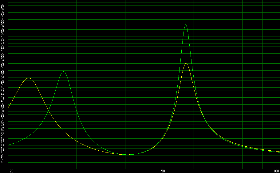

The simulated and measured impedance graphs are attached, where the small-signal measurement and simulation is shown in green and large-signal ones in yellow.
The simulated frequency responses do not, indeed, differ much and run in parallel with about 1.0-1.5 db difference.

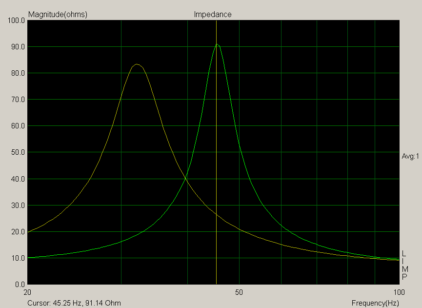

There is also an anomalous (i.e. not accounted for in WinISD 🙂 increase of the impedance maximum in the closed box (91.1 Ohm) with respect to that in free air (83.4) when measured at large signal. It is shown in the third attached image. Small-signal measurements do not reveal this effect, showing a constant maximum impedance of 115.3 Ohm both in free air and in the closed box. Does that mean that my box has negligible losses?
Are those graphs measurements or simulations using measured T/S parameters?
I suspect the simplest explanation for the third graph is a value of Rms (Qms) that changes with frequency. T/S theory (thus WinISD) assumes all of the values are invariant, but as you have seen, they vary with frequency and amplitude.
It could also be a change in mass between free air and baffle mounting.
Also, for your first chart, Zmax (Zres) can be calculated - Zmax=Re*(1+Qms/Qes)
They are mentioned in the text on order of appearance and the files are named accordingly: 1) measurements in the vented box with a small (green) and large (yellow ) signal, 2) simulation of the vented box with the parameters estimated from small- and large-signal measurements, 3) Impedance in free air and the closed box measured using the "large" singal (2.56 V at the amp).
Could be that or the dependency on amplitude, because a different compliance causes a different amplitude.

Also, for your first chart, Zmax (Zres) can be calculated — Zmax=Re*(1+Qms/Qes)
Do you mean the free-air impednace? In WinISD the peak height depends also on BL and Vas (sic).
Try Zmax=Re*(1+Qms/Qes) and you will see that it works. Qms/Qes is also equal to BL^2/(Re*Rms), so Zmax=Re+Bl^2/Rms - no dependence on Vas or compliance. Bl^2/Rms is also known as Res, the motional impedance at resonance.
