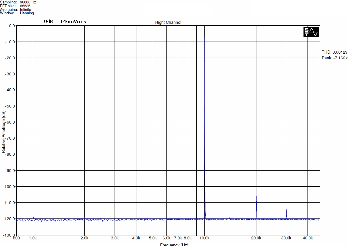

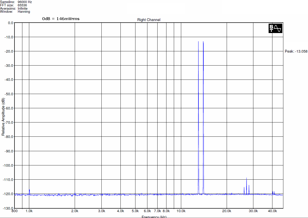

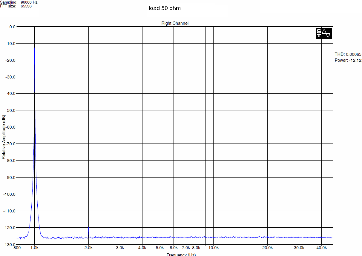

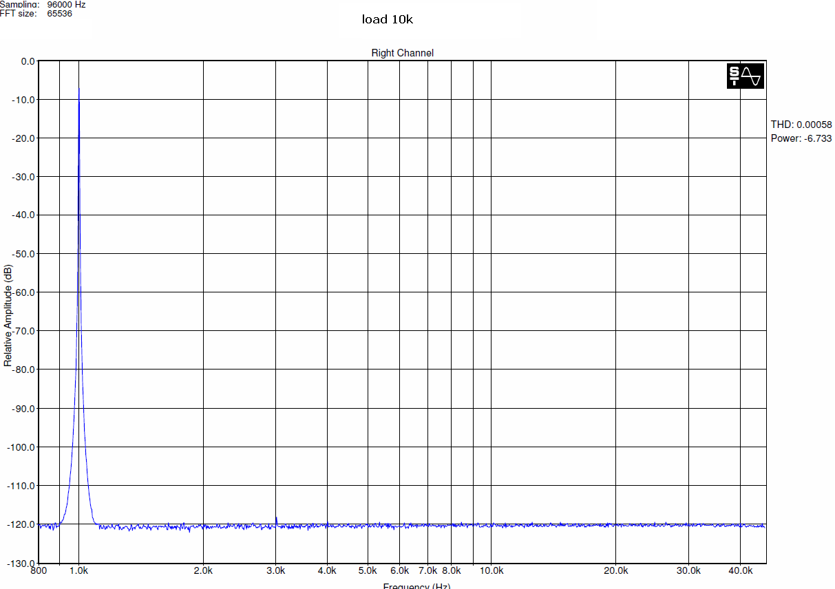

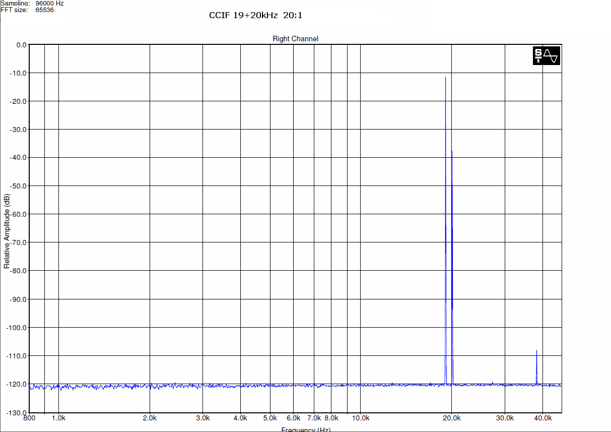

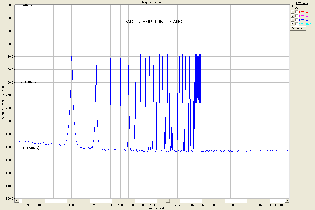

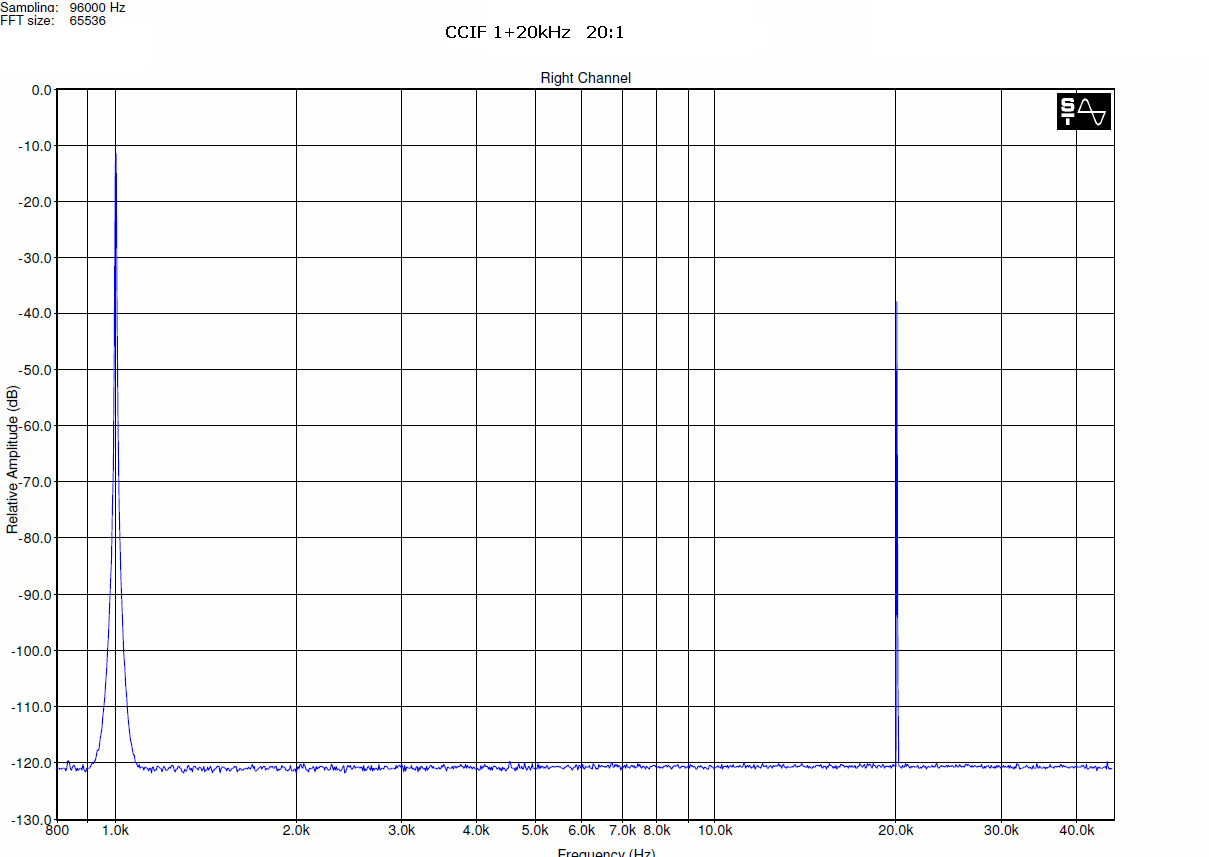

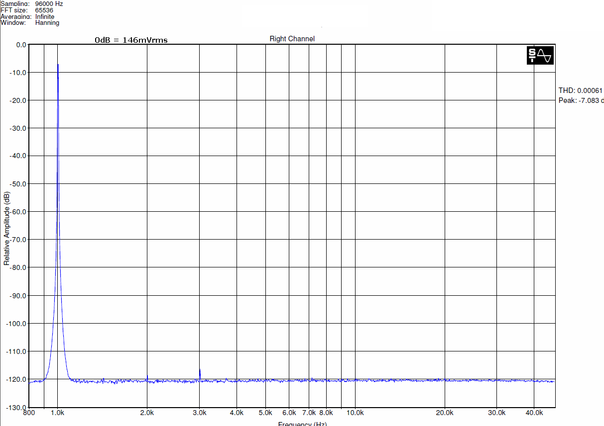

Yes, nothing significant measured.
But it doesn't prove that it applies to multitone aperiodic signals like music which atr much more complex.
I am all for good measurement tools, but extending what they say beyond their reach i am not.
The test you have shown, shows only that the DUT is good at doing the test you have subjected it to. A useful design tool, but more?
dave
Dave, good measurements are a necessary condition for transparent sound. Measurements are the only way how to present properties of a DUT in a web discussion. 'Good sound' cannot be evaluated by discussion, you need to be there and listen.
In case you are concerned about behavior of the well designed circuits when transferring asymmetric signals with zero DC, would you kindly provide me with a link to a measurement of any problems of this kind? Please get rid of 40 years old experiments with uA741, 4558, TIM with those devices and other similar 'proofs' often used in the BT thread. I would like to see a measurement on something like OPA 627 that would show problems with asymmetric signals or multitones.
