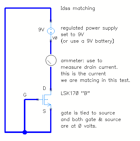

Hi All
Followup to the above.
After digesting this a bit and becoming more familiar with whats going on, I re-read Mr Pass' B1 article.
Somewhere I got the notion that for best performance, I needed to match vgs. Wrong, according to the article.
Nelson says best performance is achieved when matching Idss.
With that and flg's post (above), I set up a very simple test jig and re-measured my 20 LSK170's.
I also read the manufacturers spec sheet while I was at it.
I applied 9 volts from a regulated supply through an ammeter to the drain.
I tied the gate to the source, and set them to 0 V (ground).
The results I got across the same 20 devices was anywhere from 7.4mA to 13.47 mA, quite a spread.
Also, I was surprised to see 6 of the devices I measured had an Idss of greater than 12mA.
12mA is the max listed by the manufacturer for this part. So 6 of them are out of spec.
These are the "B" versions of the LSK170. Should I toss those out of spec devices?
Anyway, the real question. Now that I have the numbers, how closely do I need to match the Idss for use in the B1?
1%, 10% etc. I have no idea!
Thanks again
Curt
replace the ammeter with a 100r precision resistor (<1%).
Measure the volts drop across the resistor using your most accurate DC voltmeter.
Remeasure your jFET's Idss.
Try to get pairs that match to better than 10% and a few better than 5%.
You may get one or two pairs that match to 1% or 2%, keep them for very special uses, not the B1.
By way of comparison 2sk389 and Lsk389 are guaranteed to match <11%. You should be able to do better than that unless you were unlucky with your 20 devices.
Do not throw away your C grade devices, measure them and keep them for the occasions that the circuit requires high Idss devices (V or C grade)
From the ~10% pairs select the lower Idss device for the lower FET position and the higher Idss device for the upper position.
This ensures that at quiescent condition the upper device has a current just below Idss and thus has a low value of Vgs at the input pin.

But I am curious. Why the need for such a precision?
If I know the value of the resistor I am using in the test setup,
does the actual value matter as long as its close to the 100 ohm you specify?
Again, thanks for the great insight here.
Best regards
Curt
Administrator
Joined 2004
Hi Curt,
Andrew is bang on here.
The DC voltmeter sections are far more accurate and stable than their ammeter sections. Also, the sensing element in your average meter (often a 5% resistor) tends to increase it's resistance at higher temperatures. If you are going to measure these, you may as well get the correct answers. Use a higher powered precision resistor if you can. They are not all that expensive and you will have to order more parts to meet minimum order levels.
If I know the value of the resistor I am using in the test setup, does the actual value matter as long as its close to the 100 ohm you specify?
Not at all. I use 10 and 1 ohm resistors and sometimes a 100 ohm resistor. Try to keep the math easy!
Yes! looking at the VGS value also will provide better matches. The IDSS values are more important.
