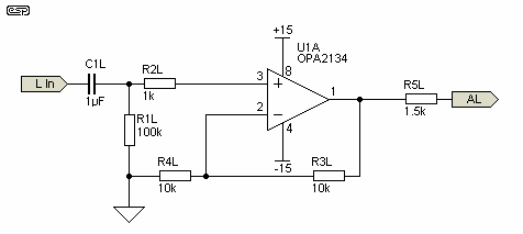

The amp (k-502) has 100k input impedance, and .22uf input capacitors...(schematic is here: http://www.circuitspecialists.com/products/km12sch.jpg)
So would that mean i should try for
1/(2*pi*.22uf*100kHz) = 7.32Ohm output resistance?
That sounds a little low to me...I thought I'd be okay with up to ~5K output impedance...
In any case, I will be going with this (with adjusted R5 for more gain) , since I have all the parts handy:

the 0.22uF is the DC blocking high pass filter.
The source impedance interacts with the cable and input capacitance to create a low pass filter.
R5 does not adjust the gain. It isolates the opamp from reactive components in the load.
It also sets the output impedance of the amplifier/buffer.
Change R3 or R4 to alter gain.
Reduce R5 to between 50r and 200r to set Rs in that range.
