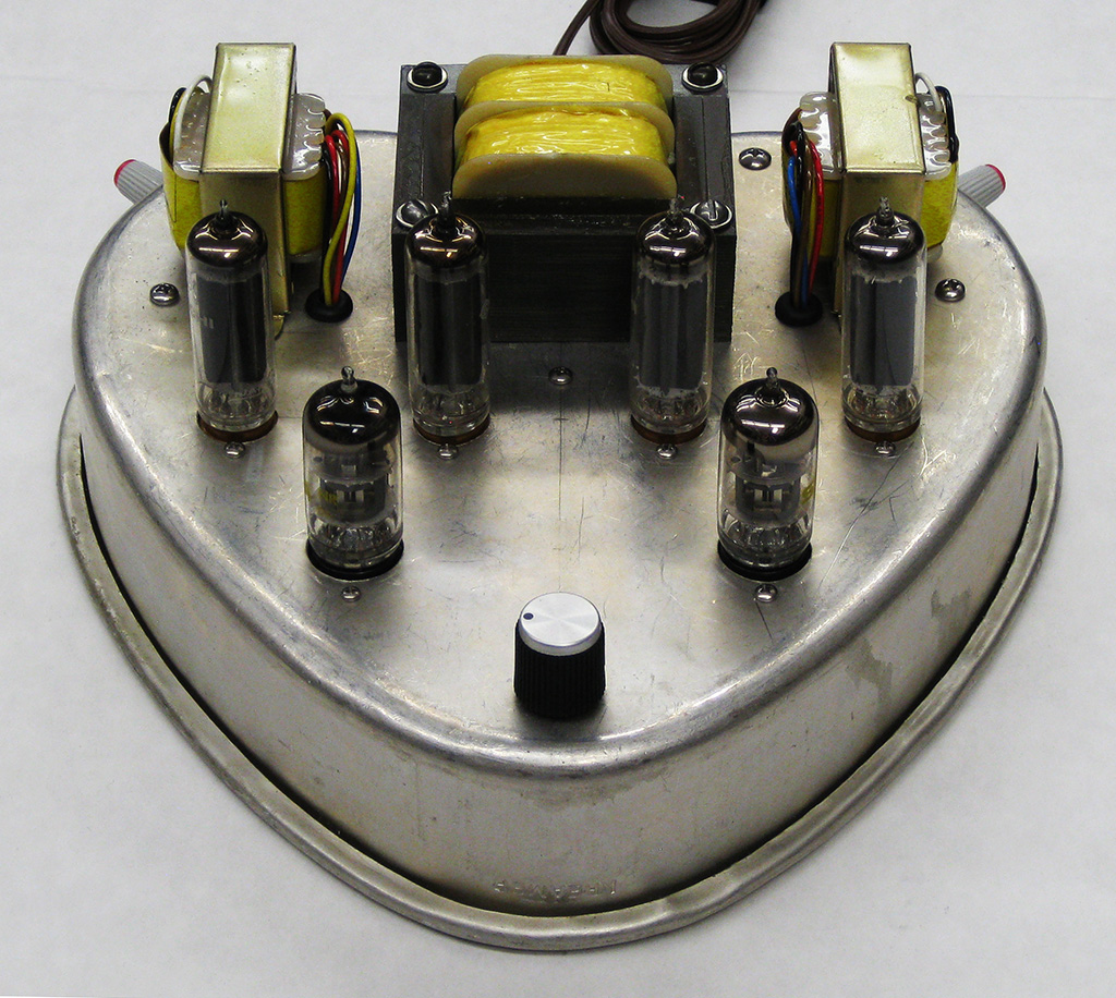

My Parsimon design might be useful. It uses cheap unshielded speaker line matching transformers from MCM, but it has enough global feedback to essentially eliminate the bad consequences. With the layout in this photo, I got noise down to about 1mV at the speaker terminals. Schematic is in the second attachment.

That's a pretty novel heart-shaped chassis you got there Mike - just in time for Valentine's Day!
The line transformer are the right size and cost ! It looks like Edcor also have some low cost open frame OPTs although not as cheap as the line transformers, e.g. the XPP10-8-10k but the issue is making them pretty. I could mount them face down (horizontal) on the chases and put some kind of end bell over the top - Edcor make something called the HC-100 but I'm not sure if it fits.
Let me know if you decide to build Parsimon. I've got a commented bill of materials and some decent under-chassis photos free for asking -- or I'll attempt to post 'em here if that's appropriate. They were previously posted on another forum. I believe all of the tubes are still on the dollar menu at ESRC.

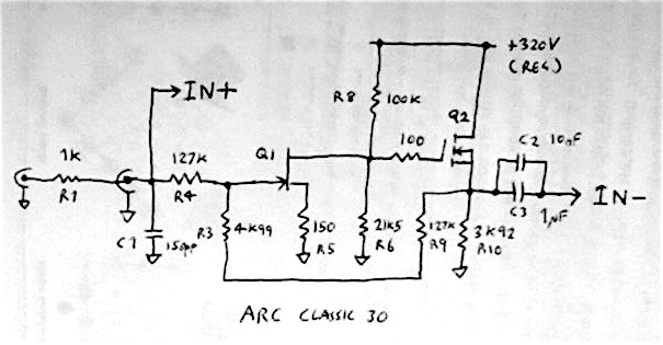

I'm thinking about how I want to drive the output tubes. I'd like some help to evaluate some hybrid options - using some SS parts. For inspiration I decided to look at the ARC Classic 30. I've read good reports from this design. It has a lot of things going on in this design and although I won't use all these ideas all I'm interested to direct the design a little to see what I can learn before I decide how to proceed with my own project.
The ARC 30 uses an inverter right at the input of the amp, all discrete, a common source JFET does the inverting and a source follower MOSFET buffers it. There's a feedback loop around the inverter too. See attached. Why did they use this approach, what are the benefits ?
