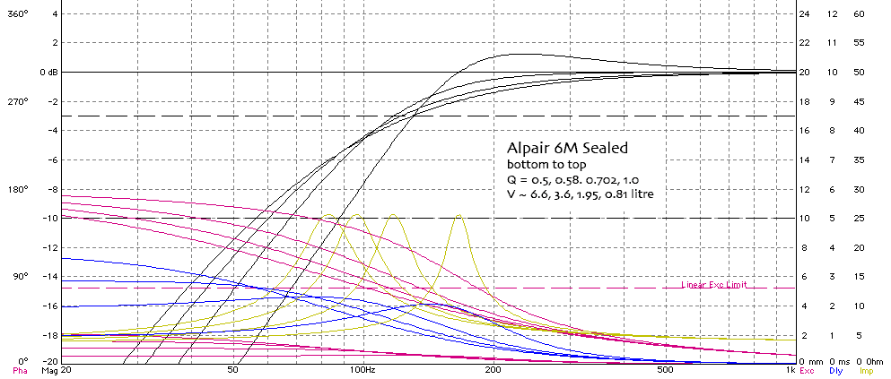

I have a 2 litre enclosure (uMar-Ken6) that, in theory, works with either the A6P or A6M unchanged.
It might be possible to put the A6M in an even smaller enclosure -- using the initial prototype numbers i squeezed one into 1.5 litre.
dave
I'm glad you mentioned the A6.2. It's so new I didn't know if anyone had tried one in a sealed box.
Both Patrick and i are referring to a vented enclosure for A6M. Attached are sealed sims. If you have no need of real bass, you could probably live with a litre box.
dave
