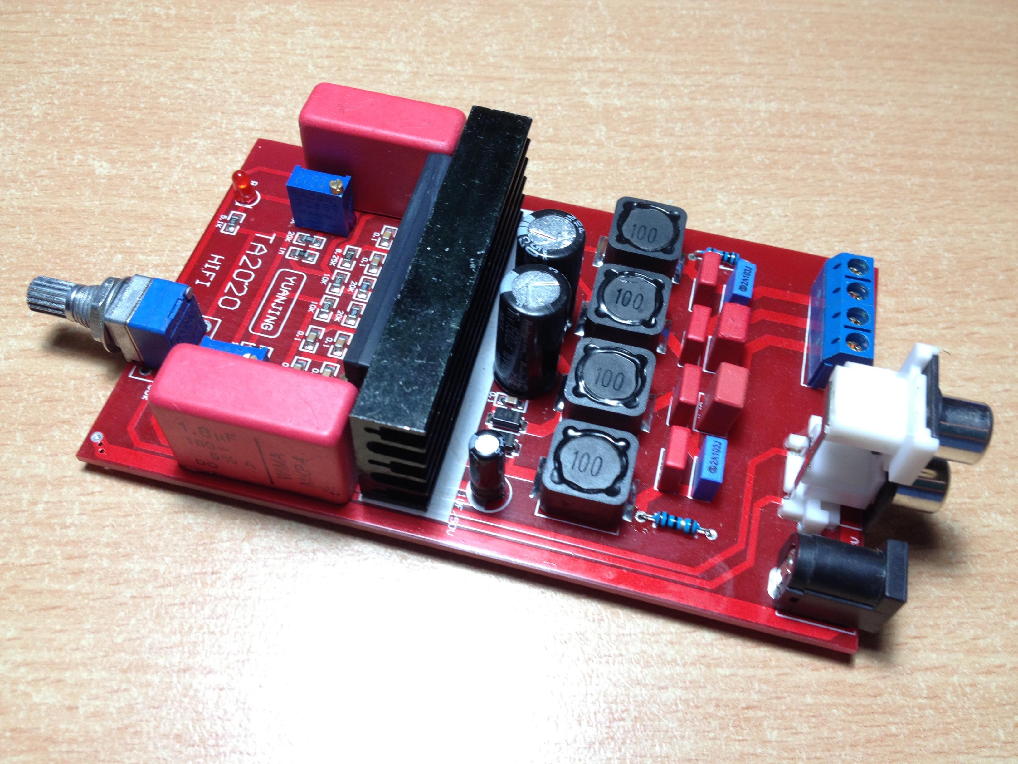

I want to make a portable weatherproof speaker. I plan to use the Tripath TA2020 Amplifier that will be powered by a 12V 7ah SLA battery. I have found these waterproof speakers that I was planning on using. The speaker needs to be weatherproof as I want to be able to mount it on a bike rack for our tandem bike, use it by the pool and while camping.
I would like some advice on whether these speakers are appropriate to use with this amplifier. Is 4 ohm better than 8ohm in this case? Do I need any tweeters?

Amplifier
Tripath TA2020 PCB 25Watt Class-T Audio Amplifier Board | eBay

For the TA2020 chip 4 Ohms gives more output but 8 Ohm slightly better efficiency for the amp. I think 4 Ohms are generally preferred for that amp/chip.
For a portable speaker I do recommend tweeters, since listeners are generally never on-axis. (Full-range speakers does generally not spread high freqs very good.) It is of course a matter of taste since tweeters increase the complexity, cost and so on.

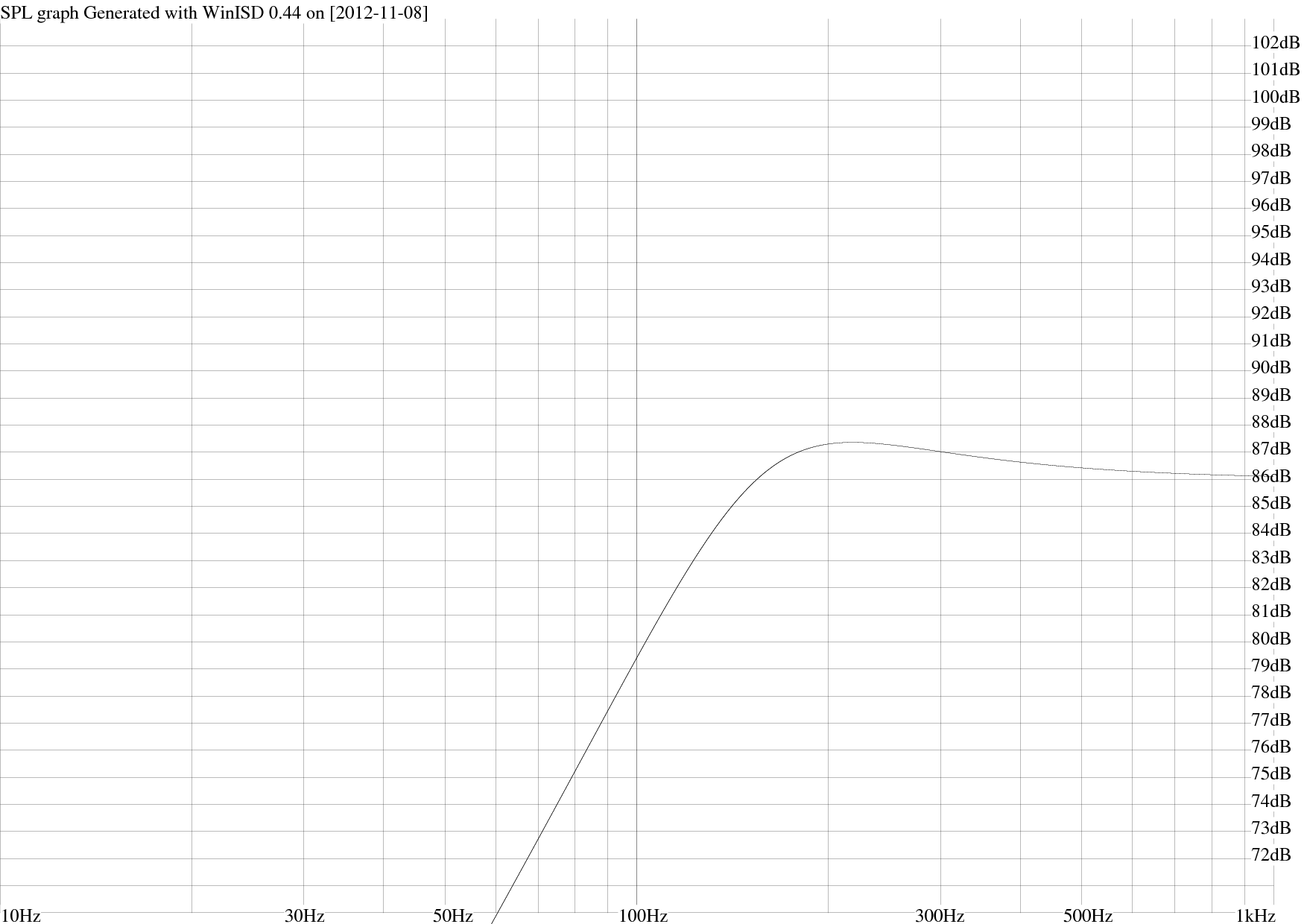

I'm looking at about a 2.5L enclosure each side. I was thinking sealed but am open to suggestions. My overall design is about 150x150x300
Is 86 db/1W to low. Would I be wise to look for a higher sensitivity say around 90 db/1W. I've really got no idea how loud that is.
I simulated the Vifa driver in winISD with 2 liter (per driver) sealed enclosure. Something like that should be ok. Qtc is close to 1, and F3 is about 122 Hz.

Ah did not see your last message. 2.5 liters if good too. Gives slightly lower Qtc and F3 which is good. Those speakers works best in sealed design.
