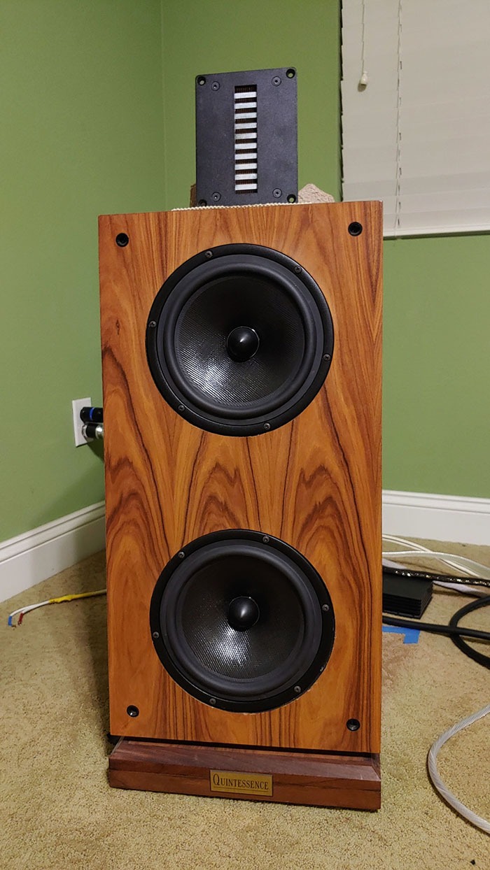

Being impatient, I tried plopping on the Beyma TPL-150 (horns not attached) just on top of my main speakers' bass modules. Big round horns with Radian compression drivers sit on top usually. Discrete analogue active crossovers cross them at 1kHz/18dB Butterworth, and so far the sound quality is very good. Seat is not too far, and average loudness at seat runs 75-80dB, so I am not really encountering much known issues, such as Beyer resonance. Adding the TPL horns reportedly makes the top a bit more "forward," so I'm holding off on that since they sound balanced currently. With horn/Radian, I had a gentle EQ to bring down the 1-3 kHz region a bit, but with TPL-150, I don't need that..

That's a very good first step. I often cobble something together with parts/speakers I have on hand to test new drivers or applications for them. I also use an analog active crossover and separate equalizer for a lot of that kind of testing. I still appreciate the ease/instant feedback you get with analog equipment where you just need to twiddle a dial to adjust them.

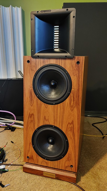

Attached the Beyma horns and...
Yup, as well documented in the past, a significant bump in frequency response happens at about 7kHz and below. Now a larger percentage of recordings with borderline sound quality in that region sound a bit too forward and highlighted. Some well-recorded, smooth music become more involving and lively. Tried DSP/EQ'ing down this area, and the result is not optimal, as music lost some magic and life, even compared to TPL150 without horns..
I don't understand how so many DIY and commercial speaker designs out there using Beyma TPL150H get around this issue? I may need to detach the horns.
My first question is, are you measuring or just EQing by ear? I could personally never live running the tpl down till 1Khz. Ultimately, we settled on a crossover point much closer to 1.75khz, and that still seemed a compromise. There's increased distortion that's clearly audible that low and a resonance that makes complex music sound harsh and aggressive. The use of the horn will also boost a range lower than 7Khz, so that would need to be addressed as well to get the horn implementation correctly adjusted.
