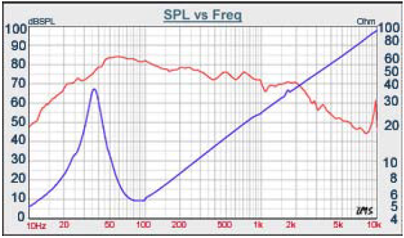

Had a look at W8-1363SBF datasheet and can imagine you had better first experience integrate TB than VIFA, TC9 is not as strong as 1772 in lows and with W8-1363SBF crude impedance rise it seems start natural LP 1st order roll off from 60Hz area and upwards in frq and also sensitivity is general low.

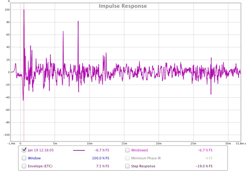

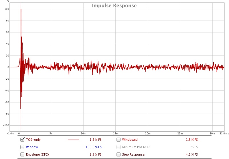

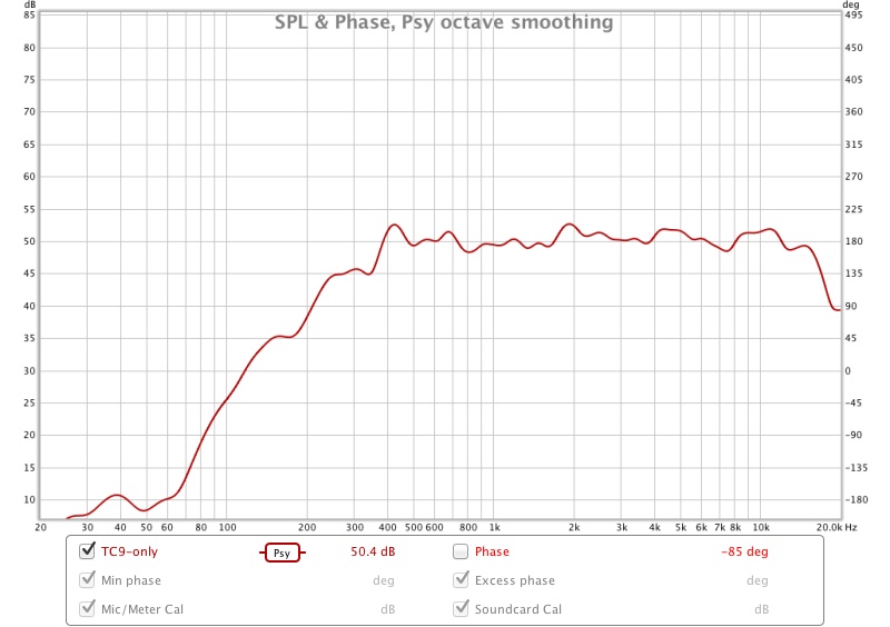

Alright, so this time, I'm going to stick to what I can hear and measure.
It's not so easy. I usually have about one hour of quiet time, and I have to pull all the setup out, dampening panels, mic, etc... So, I barely have time to try a few things at a time.
I made baffles of 30cm x 30cm for the TC9s, which is the same as the W8-1772 baffles.

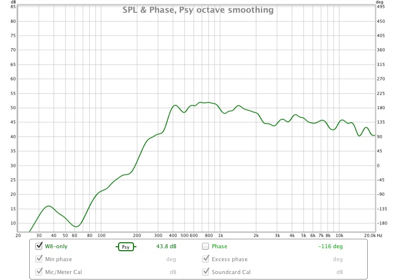

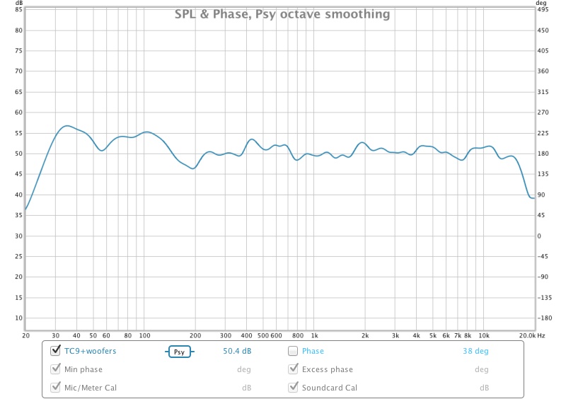

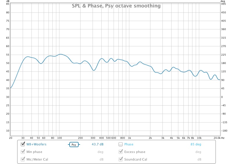

Here's the 1772 Frequency sweeps, one with the 1772s by themselves, the other using the woofers as well. There's a room node at 55Hz, and another one around 200-300 Hz, that's for the woofers. One other node I realised was at 2.8kHz. As I tried to lift it up by 2 or 3dB, I noticed nothing had changed. I went extreme and added a 10dB boost, and it still didn't change. So, as much as I try to give it, it cancels itself there. I didn't have time to move the mic to see if the cancellation was only at the listening position, or around the room.
I then tried to EQ the TC9s, which was a bit easier to do than with the 1772s. A funny thing here, the 2.8kHz cancellation is not present. So, it was driver related, and not position related.
Here's without and with woofers.

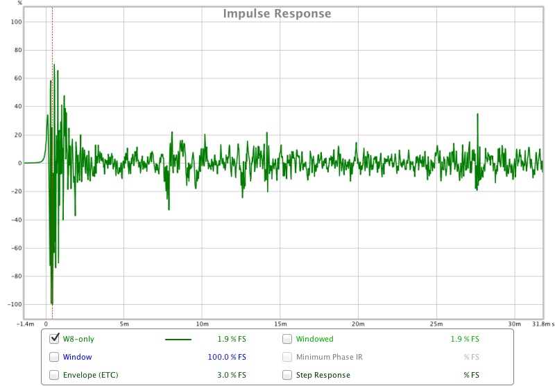

Finally, the piece de résistance... The impulse of the 1772s and the TC9s, without the woofers. Yes, the TC9s are a lot cleaner there.
So, what does it all mean so far?
Well, the 1772s down slope and the nodes make it sound darker... but not unpleasant. It's a setup I could listen all day and not feel ear fatigue.
The TC9, I was able to make the Freq flatter, and sound of course, brighter, more air as some would say.
So, the TC9 feel cleaner, but I have a lean to the darker 1772s. Also, with the 8" cones, there's more meat to the sound.

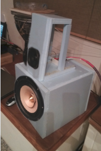

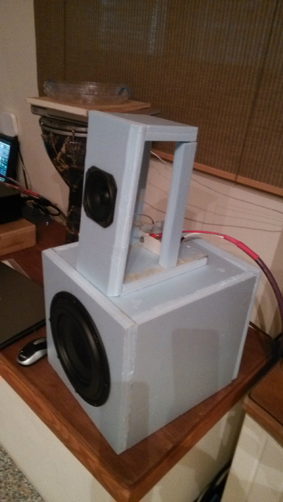

I have come to the conclusion that BYRTT (thank you and sorry to take so long to realise... but I had to try!) might have been on to something, mixing the W8-1772 in the sealed box, and the TC9 in OB on top. It should give me the meat of the 1772, and the cleanliness of the TC9.... hopefully!
So, that will be next test. Move the 1772 to a sealed box, and place the TC9 on top.
