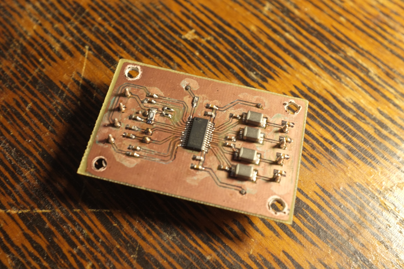

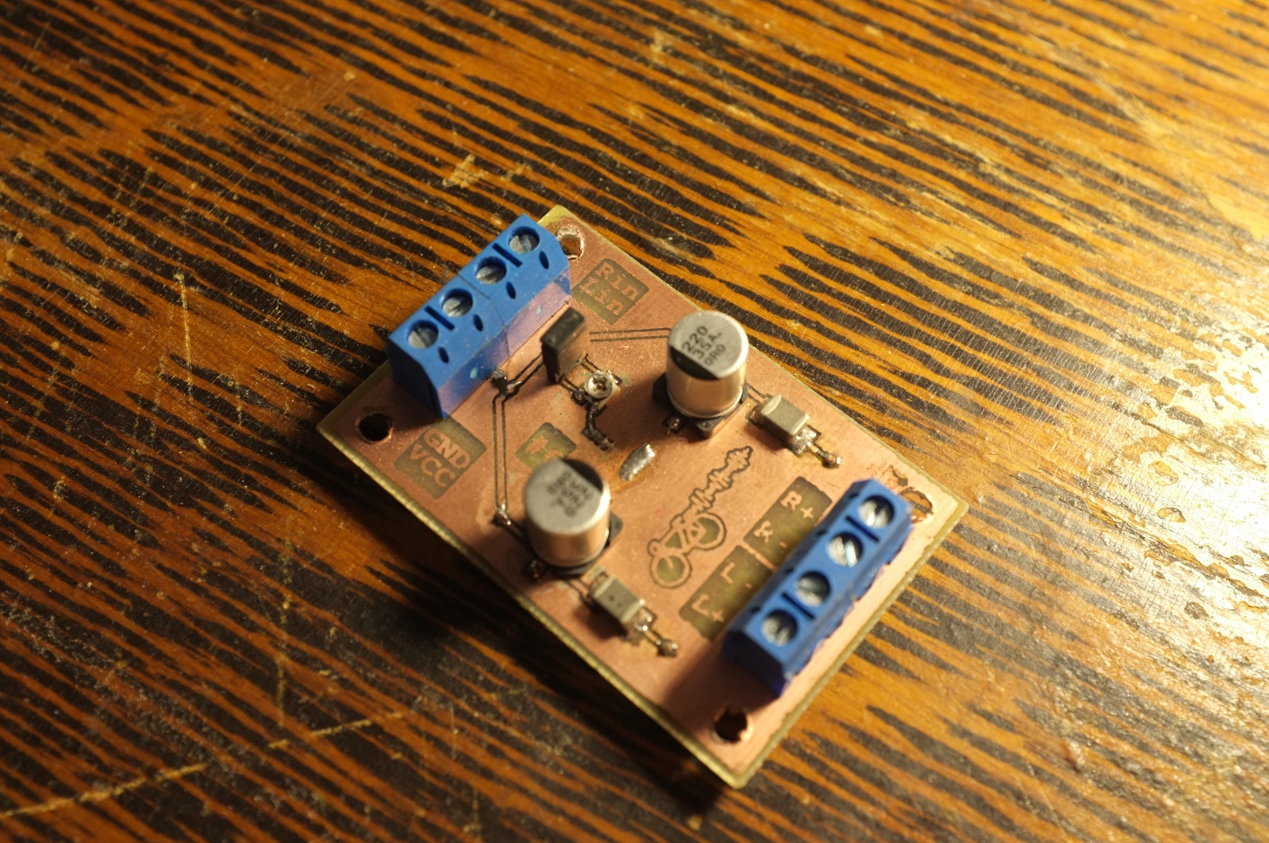

So I recently built a class D stereo amp around the TPA3110D2 chip. I was originally going to use it in a simple battery powered stereo application. But then I had a different idea, but I'm not sure how feasible it is.
My question is this:
Would it be possible to build a small, battery powered mono amp with sort of a "subwoofer" channel with this chip? The idea being that one speaker would generate the mid and upper ranges while the second speaker would be dedicated to the lower range. In my mind, I could isolate the mid and upper ranges from the lower with crossovers (either passive or active). Now, I was planning on using pretty small, identical speakers (around 3 inch), which I'm not sure would be that good for the low range. Would this produce deeper bass for this small amp project or would it just be a waste of time?
