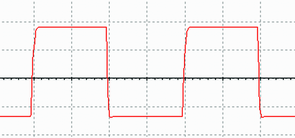

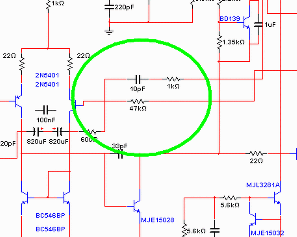

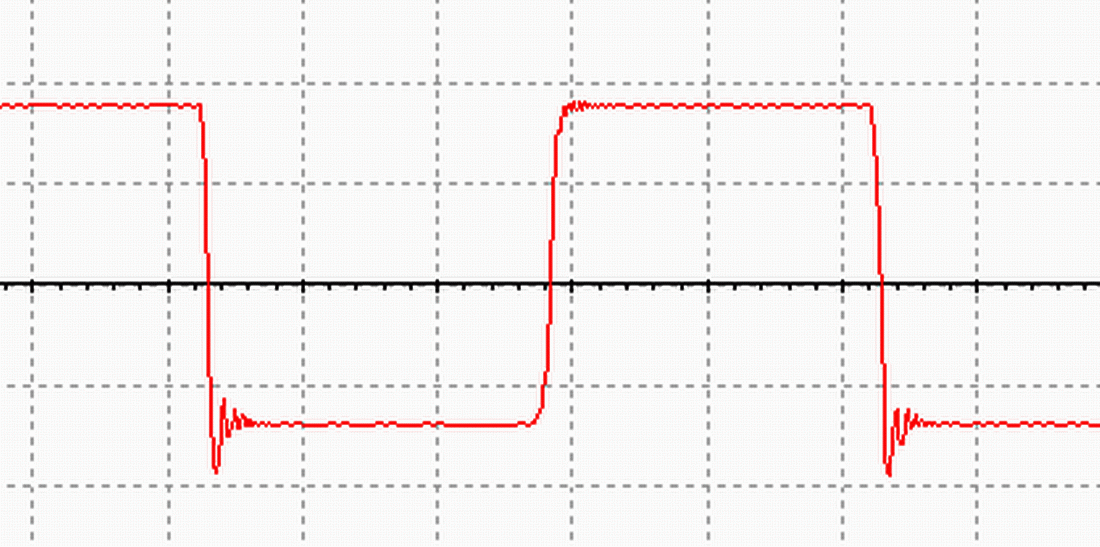

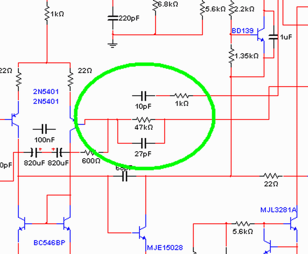

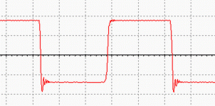

This modification made Fokker amplifier square wave much better
The distortion have reduced from 0.018% to 0.006% (THD)
Was assembled and the sonic result is clear..you can listen in the treble range.
Many thanks Kroto...you came as a messenger from the heaven...exactly in the moment i was needing....good!
Left is the 20 kilohertz oscilogram with Kroto's modification, the rigth side one is without Kroto modification

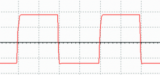

square wave
20kHz squarewave
rise time = 594 nS
fall time = 510 nS
20kHz squarewave
rise time = 594 nS
fall time = 510 nS
