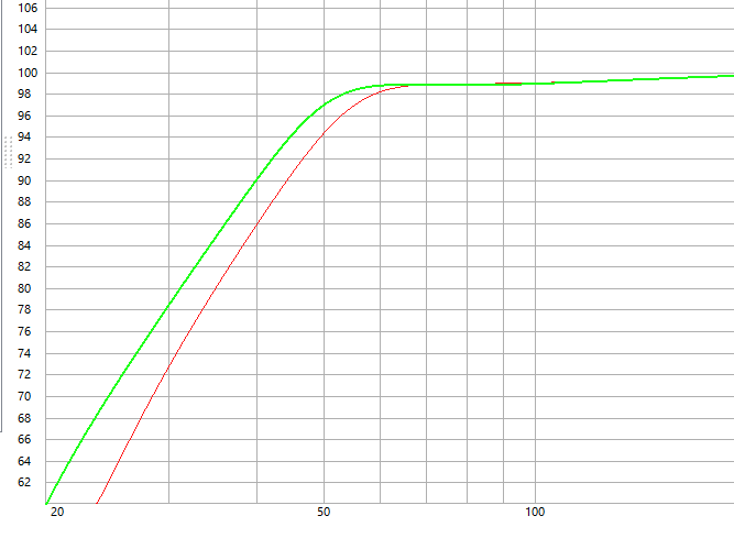

I just found that the high stiffness and high loss combined makes it loose 2db.
Green is the Purifi PR vs red the Dayton E180
Its not super bad and the suspension is good for the amount of travel needed.

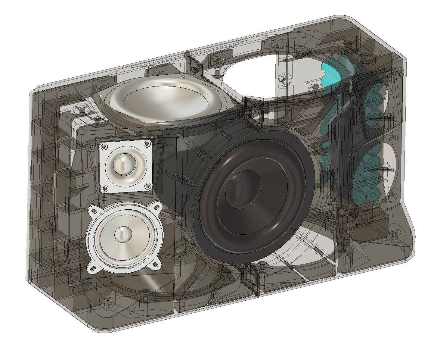

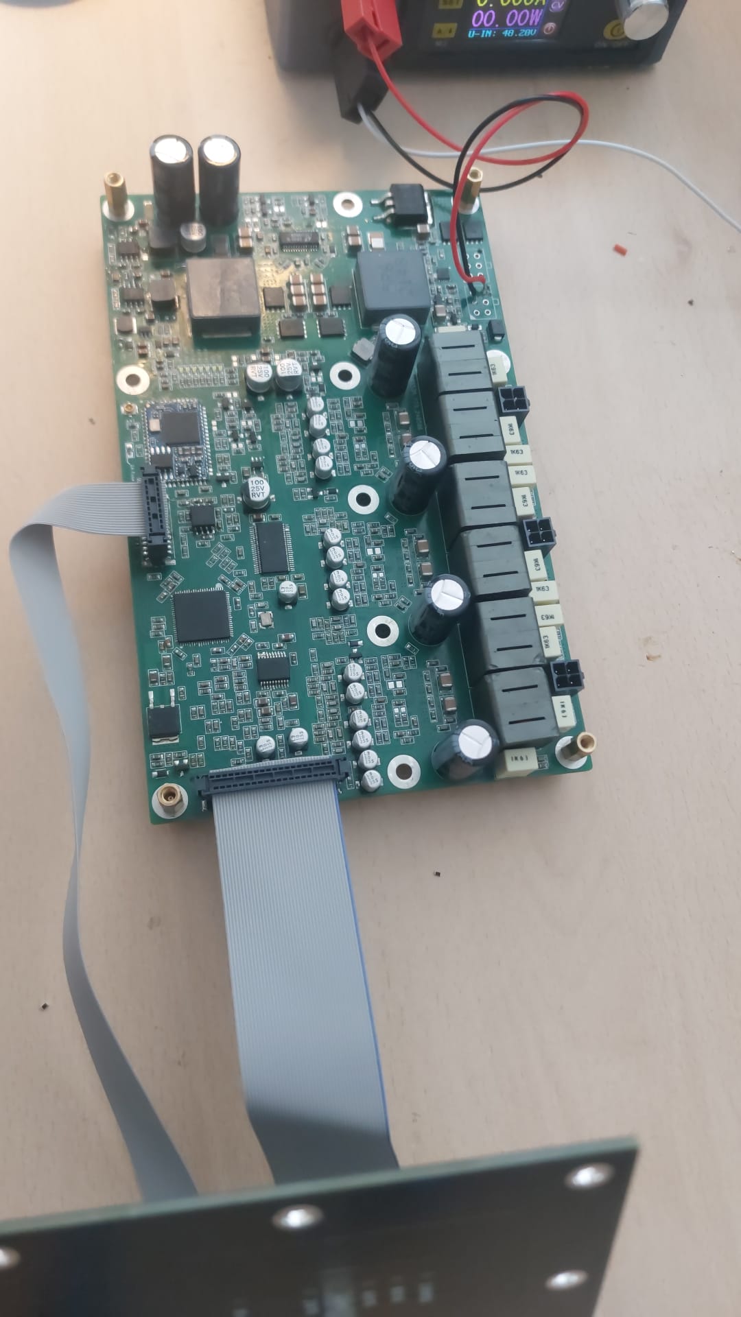

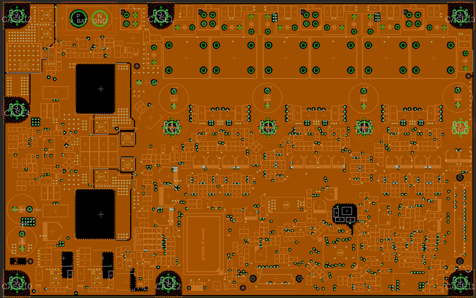

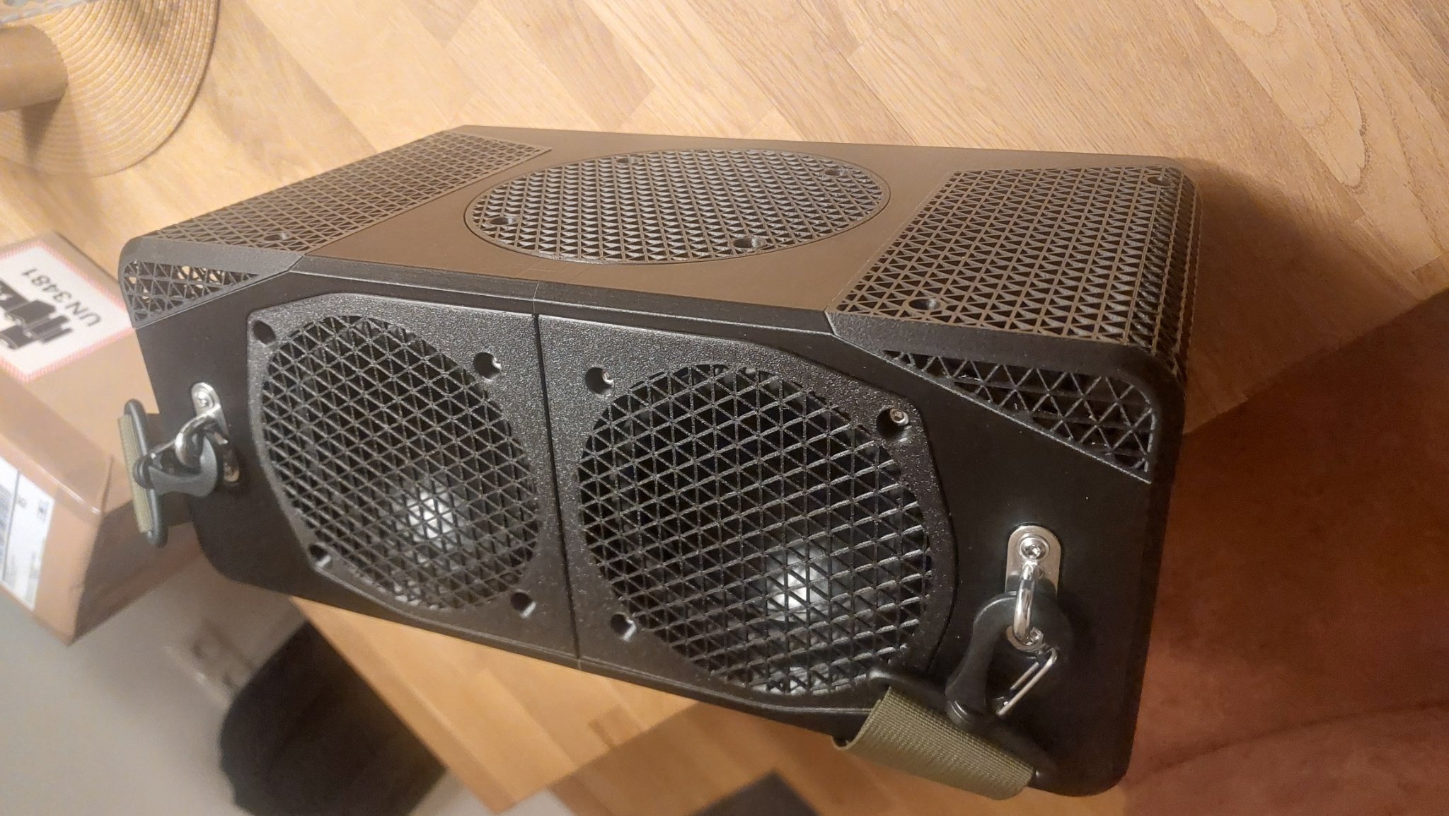

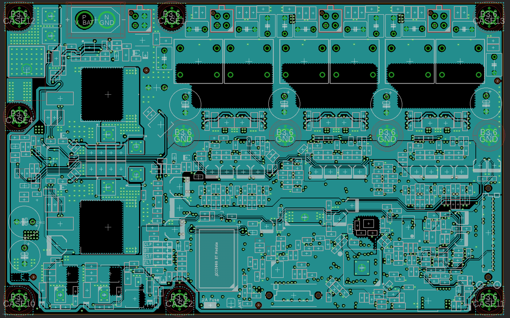

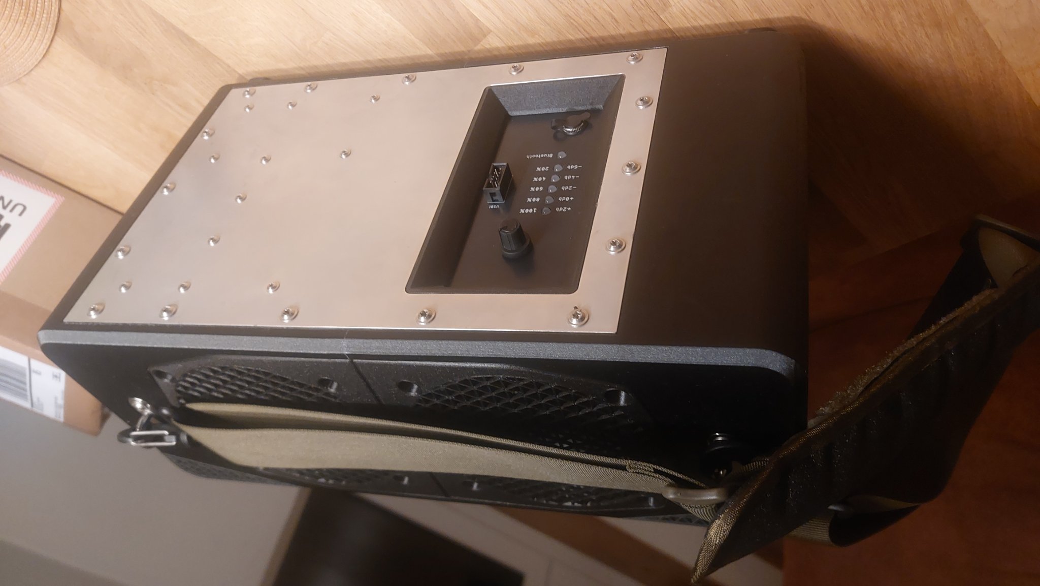

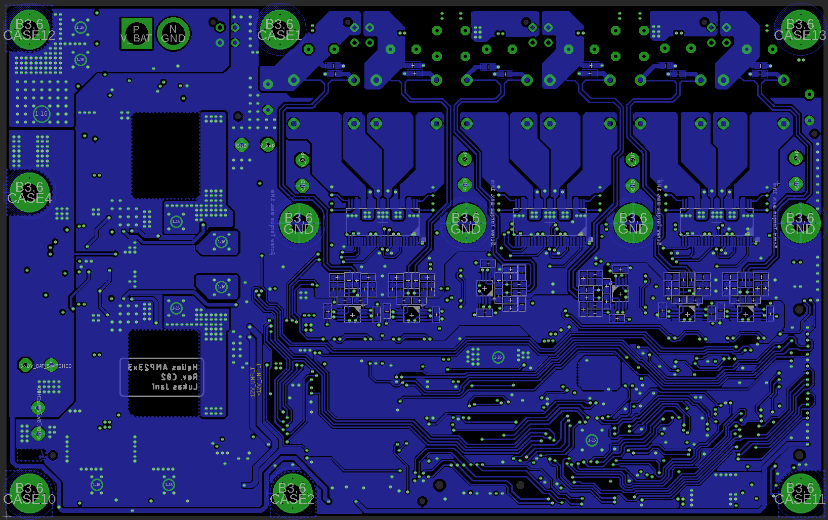

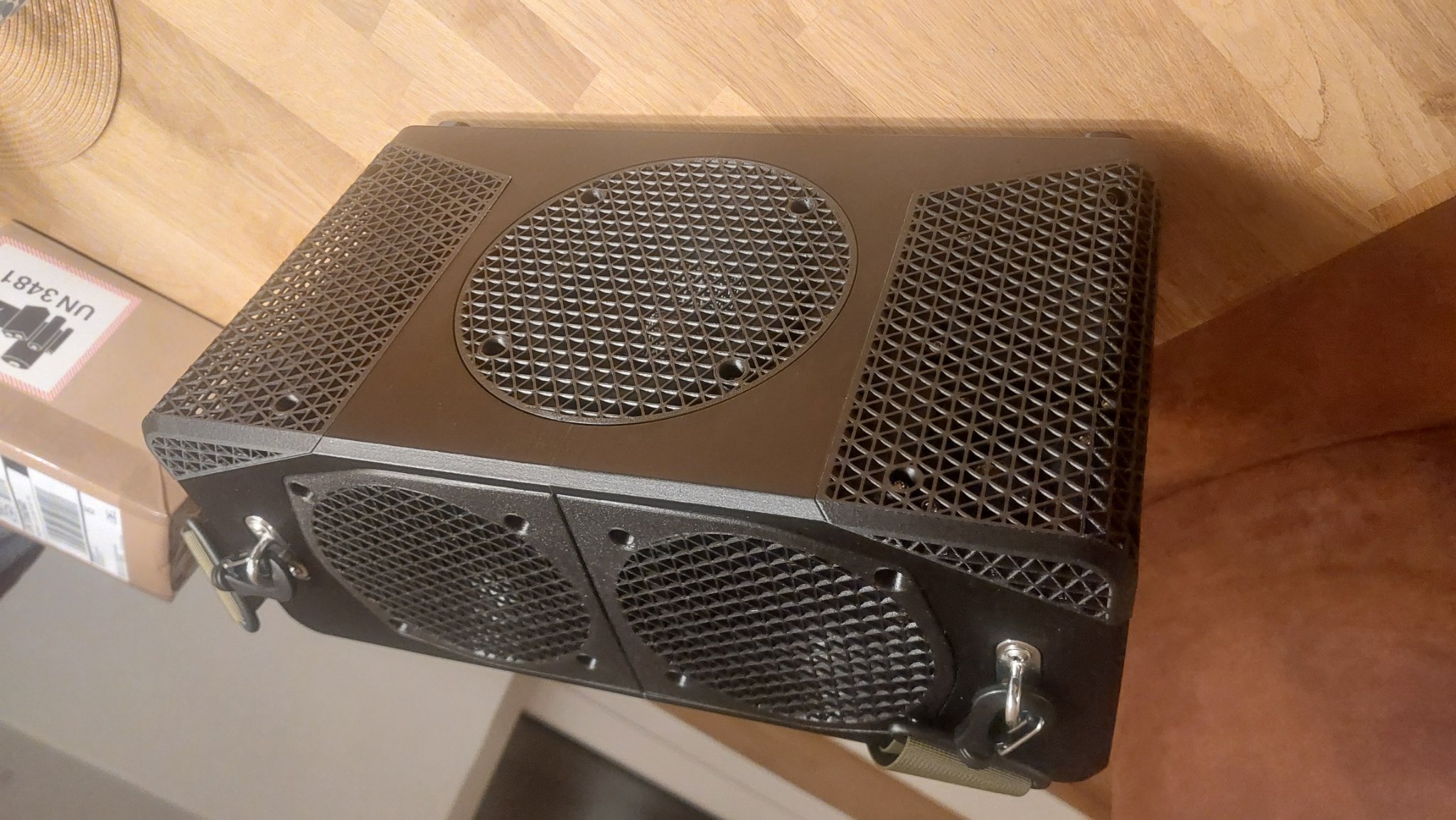

Here a some pictures of the system, the electronics and two videos. (SPL taken with a calibrated mic)
If someone wants more details...just ask

Nice work!

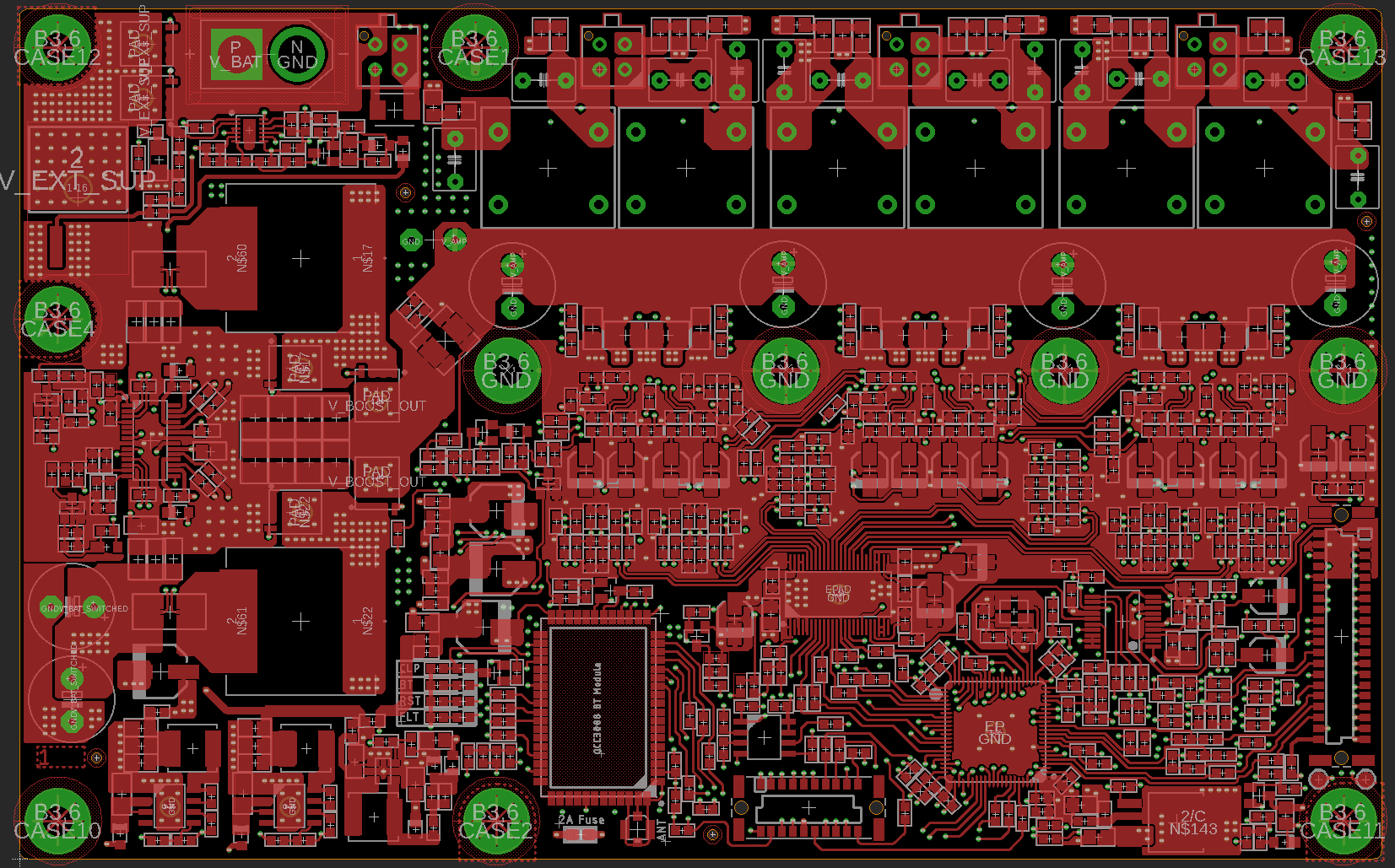

I recently (when autodesk brought eagle) switched to Kicad, I preffer it very much over the new buggy Autodesk Fusion/Eagle integration.

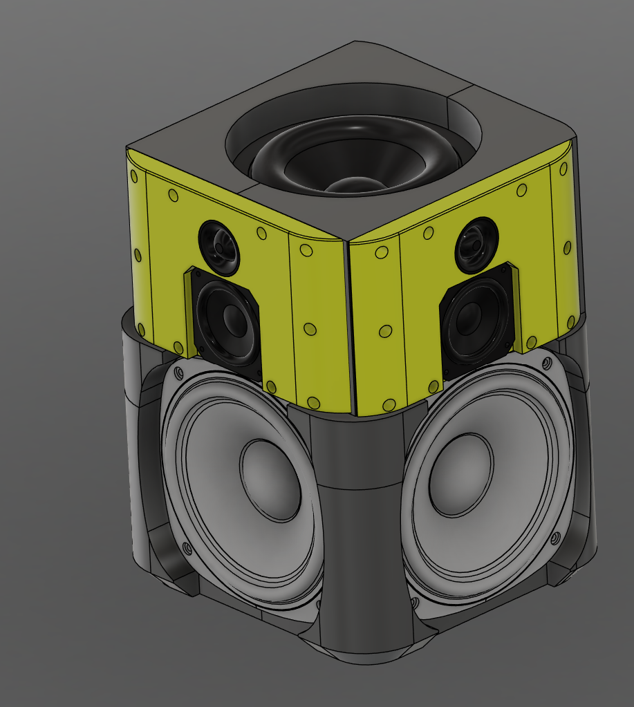

Your design isnt force canceling, so might i ask why you push that so much? Do you have issues with your moving mass? Your posts show 110g tuning mass so 220g wobbeling around might be the issue. How heavy is your enclosure total?

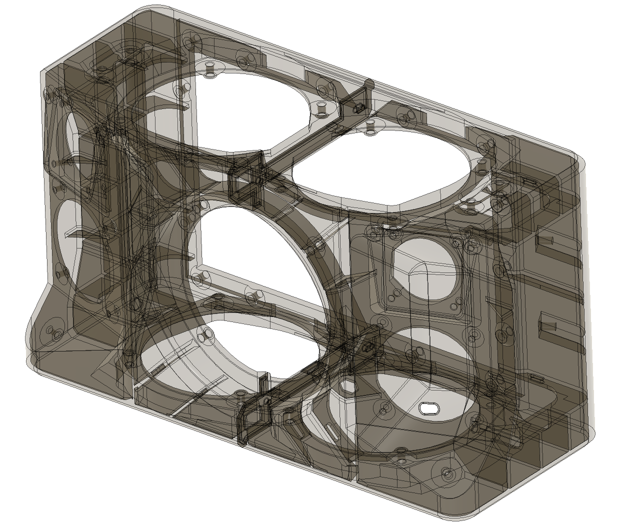

I really like the 3D printed speaker protection grill. I will try something similar: I will try to bend hexagonal aluminum perforated sheet. It should be doable with just a vice and 3d printed forms.
Actually, it is force cancelated. 2 PRs on Top and 2 PRs on the bottom. There is no Problem^^
The enclosure without anything in it is 1.2kg (PETG CF). The "flat" grills are quite easy, but for that "bent in every direction" nightmare i really had to put effort into well printable construction and needed some tries. Also, the filament for this one is PA12CF, works better in that orientation.

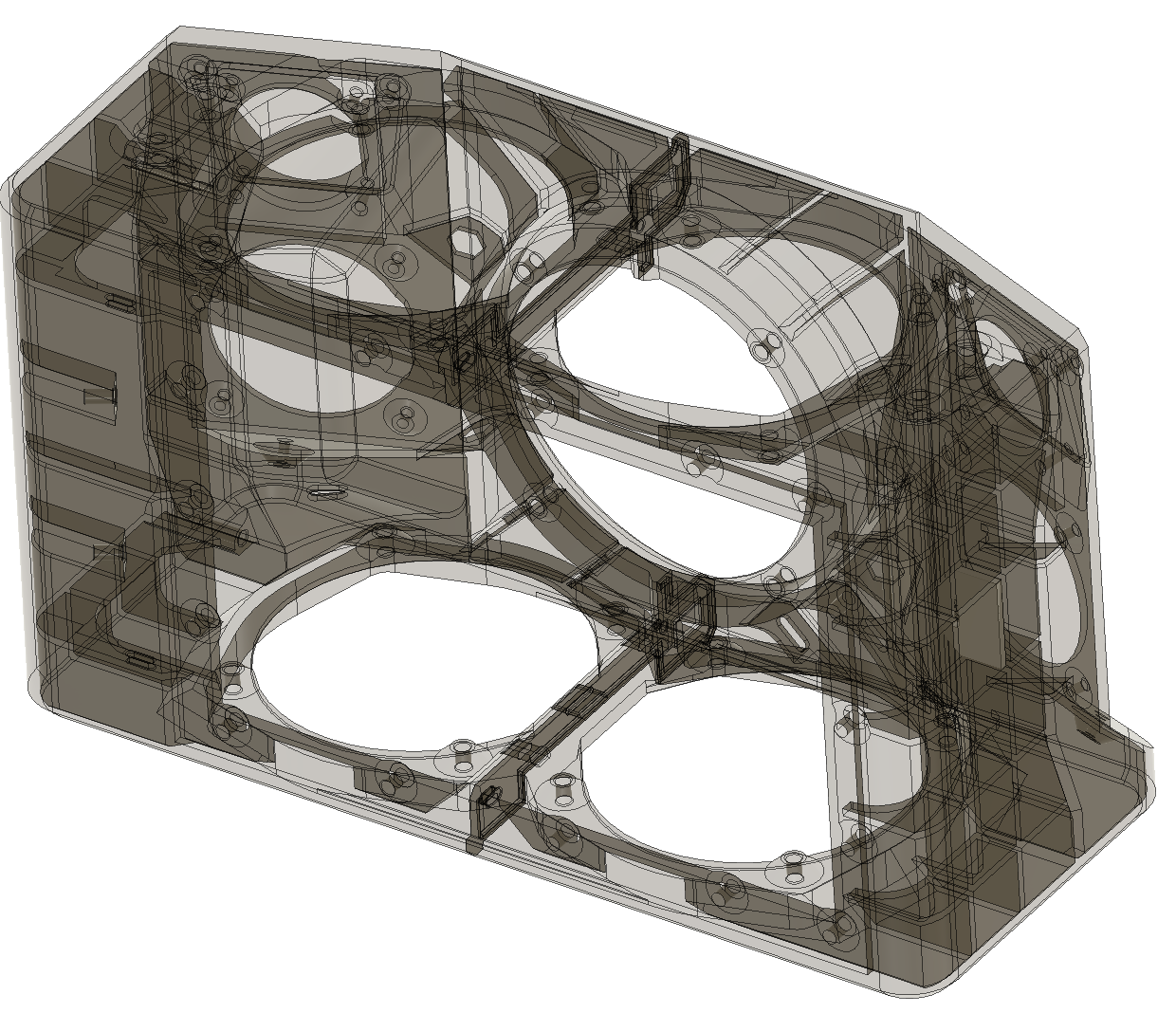

Ah ok I see there are two PRs on top and bottom, so thats not the one you where talking about here:
This is the one i am interested in. Your sims show 110g additional weight so you would have at least 110g moving around without force cancellation.
Thats a little less than my 80g total PR mems so i was trying to draw some conclusions about your experience regarding "speaker rattle".
I also use fusion for MCAD but KiCad for ECAD. I used Eagle for >15 years so i know a eagle color scheme when i see it 😉

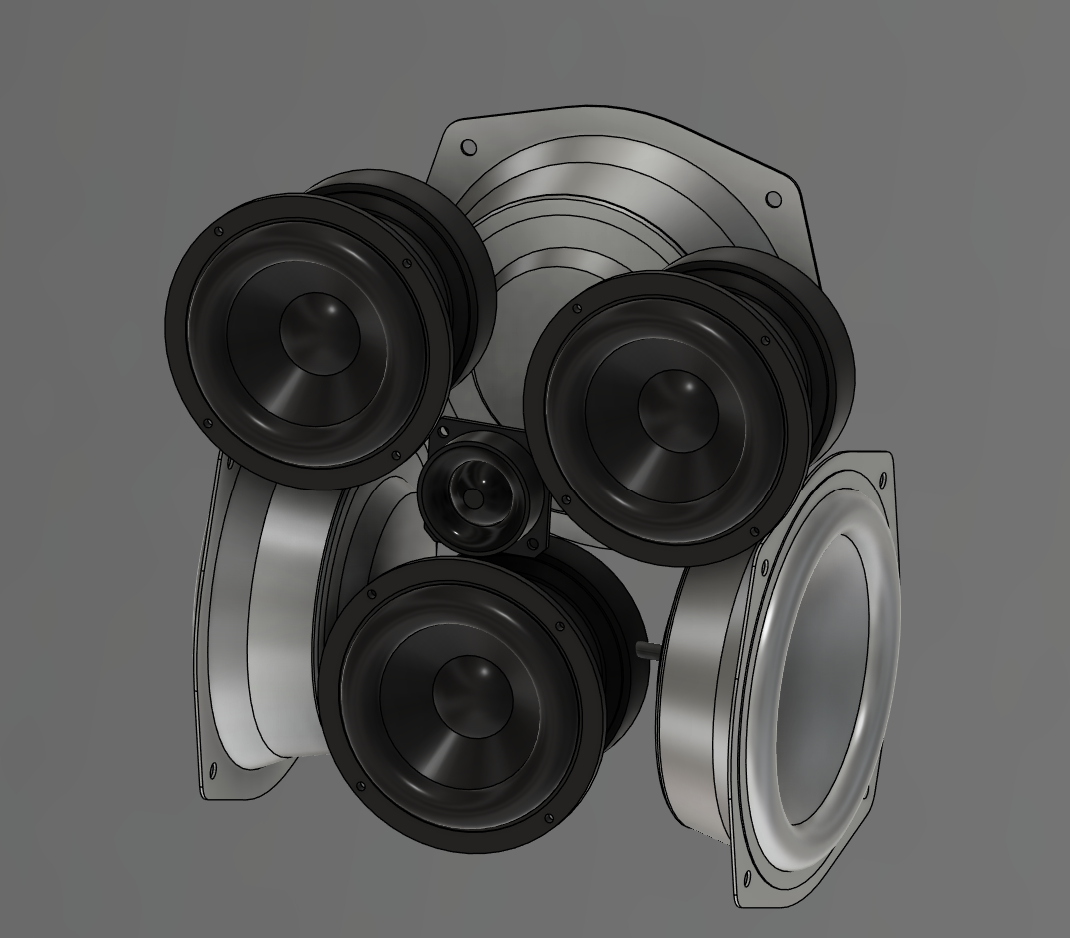

this would be my current mobile speaker (Dayton Eqpiue 150HE with 3x SB16PFC PR

ah yea... the 3 PR one. Remember, as far as i know the additonal weight for the PRs in winlsd is TOTAL. not per PR.
It’s per cone not total, you can variefy that by checking how fs doesn’t change if you add PRs but it should drop if the mass would be split across all cones.
So this one is still in the planning phase? No data on housing vibrations?
Would have been a nice data point to compare.
i thought that too, used the suggested weights and the tuning was much too low 😀
there is a printed enclosure, but not assembled yet. i do not think there will be a problem, the overall speaker has to much mass, the sub alone is like 4kg ... but, we will see. would have been great to meet up <.<
Loading 3 PRs in a hexagon on alternating walls will make them balanced with regard to the origin.

I am currently working on the PCB so not sure when I will get to measuring.

3D Printers for the win! Prototyping something like this gets so enjoyable. By the way, there is also some good passive radiators from wavecor, might be worth a look too.
I did the prototype 3D printed. Its just way to leaky and flexible and i already printed it 650g heavy..
I like 3D printing for stuff like that but sometimes its just not the right tool. A quick MDF box would have been way better.
I am just to lazy to whip one up right now 😀
Carbon fiber is so unique and relatively simple to work with that i really want to try it, I just enjoy trying new stuff so cutting MDF feels like a chore while making the CF housing is enjoyable to me even though it takes way more work.
And I even get an idea if the intended housing is stiff enough or doesnt have enough damping.
So yes its silly but I like it 😀
