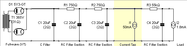

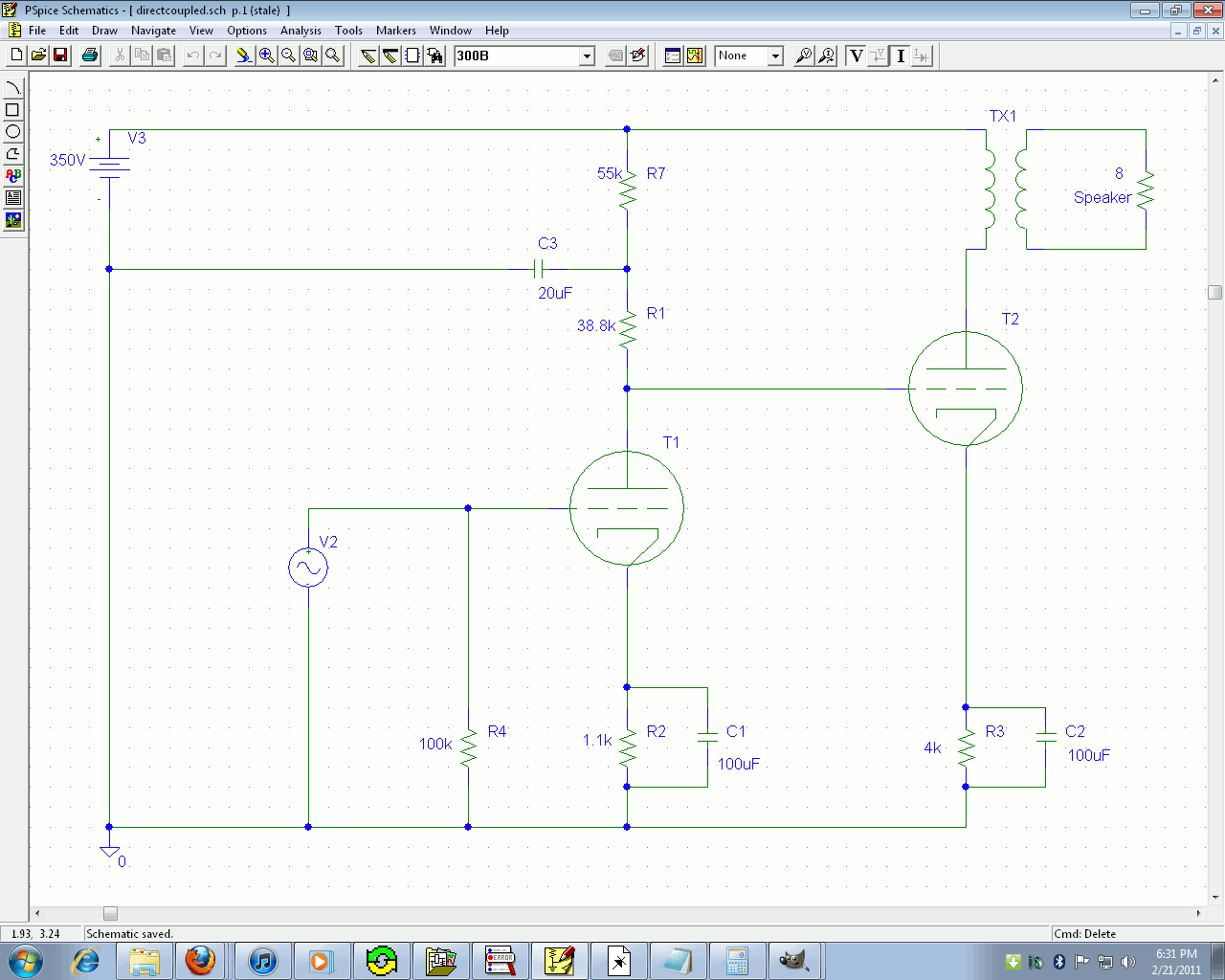

While waiting on my edcor transformers, I have started designing my next project. I'm hoping someone more experienced can take a peak at this and make sure that I'm not doing anything too stupid.
The main requirement for this SE direct coupled monoblock tube amp is that it must be small and portable, while still sound good. I therefore used the combo tube 6ea7/6em7 and I am dispensing with a choke in favor of a RC ladder filter like in Morgan Jones' book. When looking at the datasheet for the 6ea7, the recommended operating points are a bit different than with a normal two stage amp. The recommended operating point calls for the driver stage sit at a higher (250V) B+ than the power stage (150V). After looking at power supply designs and grounding schemes that would accommodate this, I floundered upon direct coupled designs, which would solve and simplify the power supply design.
I know these direct coupled designs tend to blow up when things go wrong, and the monkey design fixes it and reduces wasted power, but more components will add size, which I do not want. Also these tubes are relatively cheap and I'll be using properly rated components and fuses, so I'm not too worried about a failure.
Many of the designs I see call for loading the driver anode with a choke. I don't quite understand the need for this and would appreciate an explanation. Since I'm dispensing with a choke in the power supply, one here would not do.
The anode of T1 sits at 250V, idles at 180V, biased at -2V and takes 1.8 ma at idle. The operating point of T2 is at 150V at 50ma, biased at -20V. So, the cathode of T2 needs to sit at 180+20=200V and the anode needs a B+ of 180+150+20=200+150=350V. The cathode resistor needs to drop 200V at 50ma, so 3.2kOhms. Make sense?
All you'd really need is an extra coupling cap and bias resistor, which really won't add much if any extra size to the amp. You already have the OPT, power transformer, filter cap and tube, which are the bulky items anyway. And I hate to think of the power you're gonna burn in that cathode resistor. Which means a bulky power resistor probably bigger than the coupling cap and bias resistor anyway. Avoiding that power resistor would allow a smaller power transformer anyway.
The small triode’s plate resistance according to the data sheet is 30K. Your plate load, R1, is only 39K, which is way too small if you want full frequency response. A choke offers many advantages that you can find searching here.
The high plate resistance of the small triode of the 6EA7 and your small package size requirement may be better served by a constant current source, which can provide high impedance with little loss in voltage, around 30Vs or so.
If that is all the mains voltage you have to work with, you may be hard pressed to monkey with a constant current source, though a high-henry choke works. It’s a nice tube and worth playing around with.

With my operating points, I'd be burning 10 Watts in the cathode resistor. That kind of dissipation may need a heat sink. I have found that I don't quite fully understand Monkey amps enough yet to go that route. Maybe further down the line. I guess I'll put two or more cathode resistors in parrallel if I want to avoid a heat sink.
mwiebe, I printed out the graph for the 6em7 and drew the load line I wanted and then calculated the plate load resistor. Can you elaborate on the relationship between the tube plate resistance and the plate load resistor? I know that it is generally a tradeoff between linearity and voltage swing. The more plate load you have, the more voltage swing you can get. The less resistance, the more linear.

Just realized the original schematic contains a showstopper error. The 6EA7 is only allowed to run the heater minus 100V negative with respect to the cathode. This is for the DC components of the voltage difference. With 200V applied continuously, I'd expect the tube to be fairly short lived, until it develops a heater/cathode short and stops working. Even using a negative supply rail won't fix this, as we cannot separate the two tube heaters.
So the design either needs to use a different pair of tubes, driver and output each on their own heater supply, or the output stage should be run at a more reasonable cathode voltage via DC blocking capacitor and grid leak resistor.
Edit: Well, one could run the heater at around 100V potential, making each half of the tube run right on the edge of permissible voltage difference. A bit too close for my taste though.
it more or less makes sense.
cathode of T2 sits at 182 (T1 anode + bias) + 20 = 202V.
B+ of 202 + 150 = 352V, but you need to consider voltage drop due to output transformer primary.
cathode resistor of T2 should be around 4040R with 50mA at 10W, but you need to de-rate! factor in 3 x wattage for sustained use.

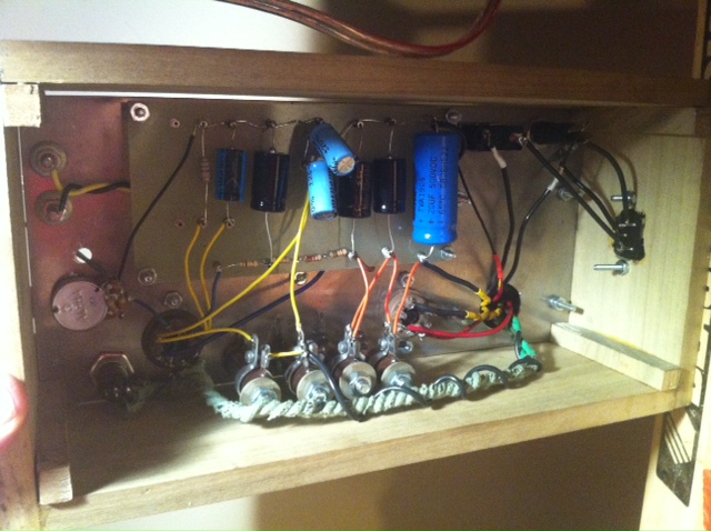

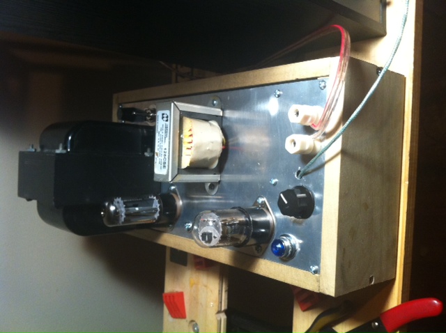

Ahaha it lives! It sounds great! And it's hot! And zero hum; none!
The final design changed a bit as I fell into a hammond 275X transformer and some power resistors. I am using four ohmite 25 watt adjustable power resistors. Two for the power supply and two for the power stage cathode bias. They are vertically mounted inside the chassis with a large bolt running through their middle. The bolts holding them act as a heat sink. You can put your hand on the bolt heads, but you wouldn't want to keep it there for too long. Input is from an ipod line out with a stereo to mono bridge.
The chassis is poplar, but it not finished yet. It still needs to be sanded and oil rubbed. The top is aluminum plate that I thought was really thick, but that giant transformer causes it to bend a little in the middle. I may have to add some more bracing.
Thanks to Knarf for pointing out the heater voltage problem. I overlooked that. I set it at half the bias voltage, which should be around 100V. I read that you said the max voltage difference is 100V, but the datasheet says 200V. I listened to it for about an hour tonight and everything seems ok. Tomorrow I will double check all the voltages and operating points and make sure everything is as I designed it.
mwjebe, I changed the driver plate load to 100K on your advice. I also looked through all the books and the web and still cannot find where the "three times" rule of thumb comes from. Can anyone point me to a reference that derives this rule of thumb? Because of the higher plate load, I upped the supply voltage to 300V to get a little better linearity, but it still idles around the same 175V with a -2V bias.
I didn't have a capacitor as big as I'd like for the power stage cathode bypass that can take the voltage. I'm only running 2 22uF 350V caps in parallel. I have by no means finished the listening test of this amp, but initial impressions may point to a small lack of bass. It's possible it is from the bypass cap, but I suspect the more likely candidate is the Hammond 125CSE OT. The frequency rolloff math works out with the 44uF cap.
My first build was supposed to be a straightforward 6sn7 6v6 build, but the pieces for this one fell into place first and I couldn't be happier. It is quite distinct from any other amp I've owned. Very warm. My computer setup sounds so harsh by comparison.
