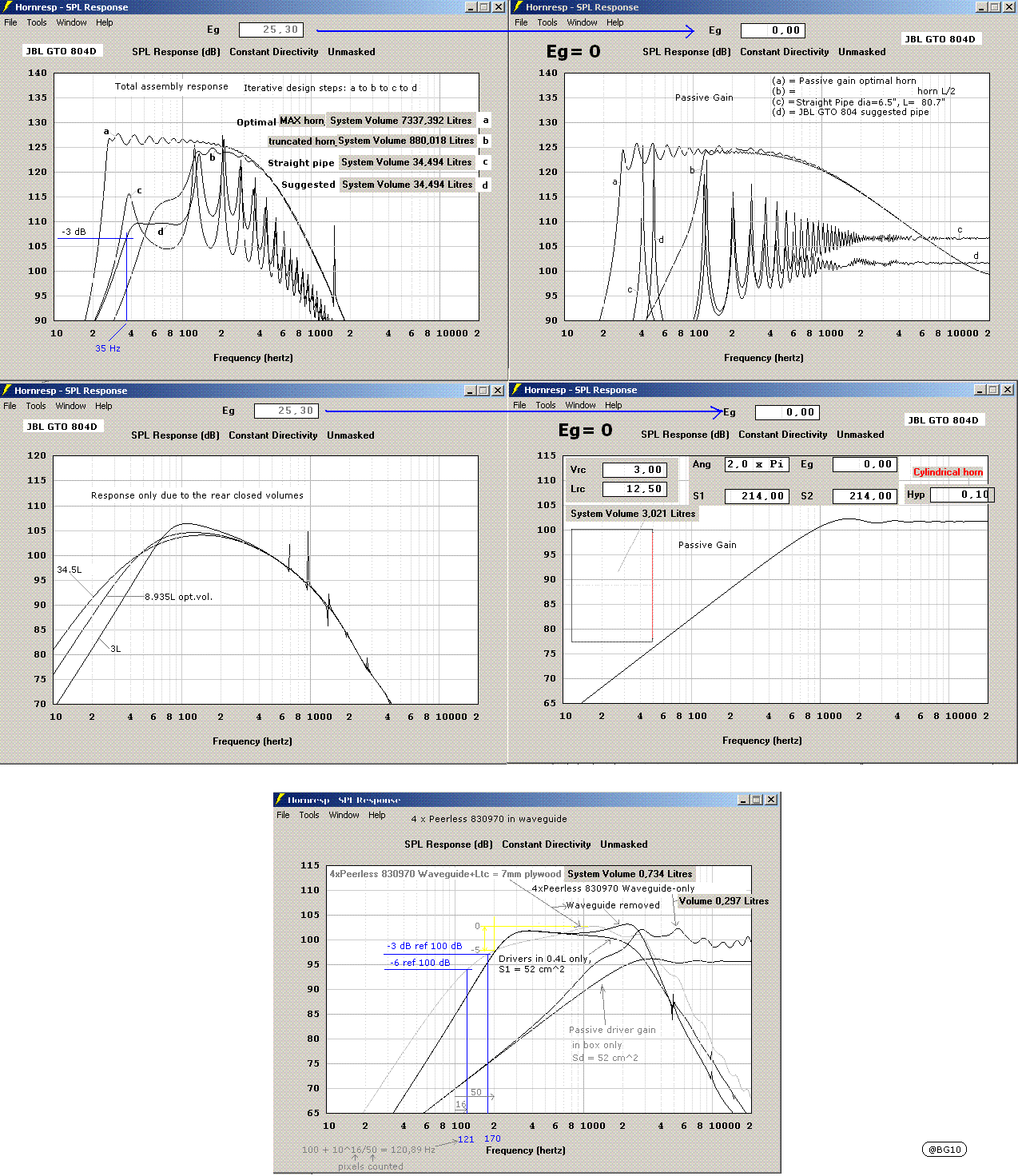

No problem at all. All you need is to properly use the HR and the hint is to correctly interpret the visual results that affect all output screens when changing the parameters.
...I wonder how well Hornresp models the geometry of the throat? Of course there is no phase plug...but you can input throat area and volume, and then conical sections...

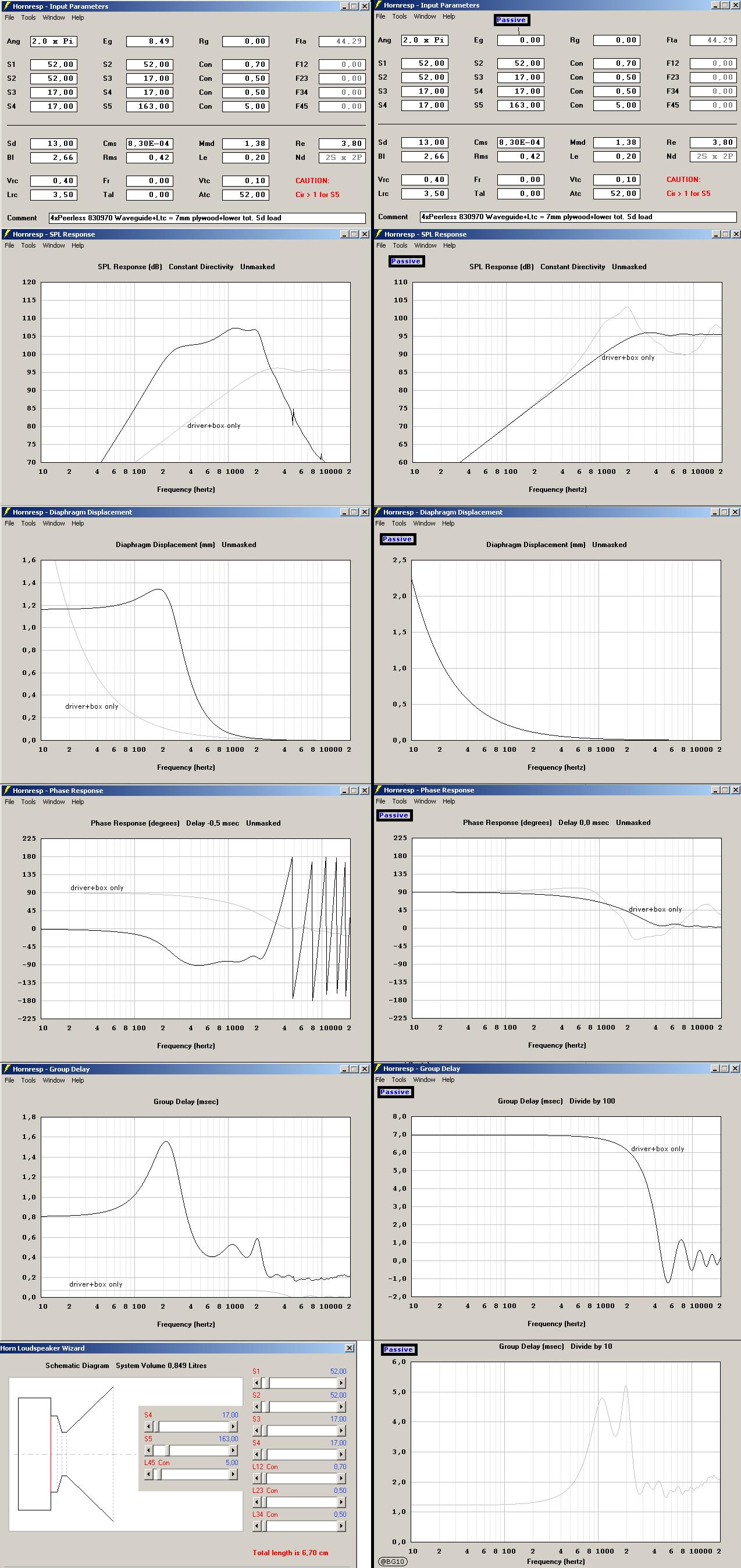

What are you aiming at? Did you find unwanted discrepancies in my posted HR plots using the 4 x Peerless 830970 drivers?
See the foundation/investigation and more (two picture I never intended to post but may be of some use?) I made prior to the posting of this one.
If you want to separate the ‘horn’ from the drivers in use, i.e. investigate the passive plots of the horn transfer functions, just enter a Zero Voltage = 0 V for the Eg value at the main HR input screen and then press the calculate button.
To find the throat impact: disable the expanding horn part, with or without a rear side closed box, but not the throat definition (areas and lengths) and repeat pressing the calculate button.

Thank you. I am swimming upstream with new tools. Thanks for your efforts and minimal but pointed hints (correctly interpret the visual results upon changing parameters; funny). GM said "...more drivers.. means a higher compression ratio for a given throat area which in turn means adding a filter chamber and phase plug, i.e. create a compression driver. For all but the most avid and/or knowledgeable, such a project is beyond the scope of DIYers. Ditto for designing/building a Unity concept horn."
So this led to the questions which you answered in your response. I didnt find discrepancies in your HR plots but in truth Im still digesting. I guess it could be very critical how one created the entrance into a horn, and using four drivers, I didnt know what the effects might be of abrupt steps in throat area etc. GM was not encouraging. So the compression driver was a possible alternative to unknown multiple driver throat geometries.

Some thoughts when duplicating your small horn with 4 peerless;
It seems there is no way to really horn load them unless one wants to accept multiple peaks of 10db. With your approach, It seems that the horn enclosure does little to modify the response or improve sensitivity. The lower region is modified by the rear enclosure volume. Sensitivity grows by 6 db due to 4 drivers, from 82 to 88 db. Then I wonder why you chose half space instead of full space for the radiation environment. I would guess the unity design is similar in that there is no boost from horn loading the lower midrange because of limitations in the horn size...or is that true? Using fullspace and the four peerless, 1.7 mm extension, the maximum SPL is driver extension limited at 105 db below about 350 hz, cutting off at 12db per octave. At least that is what my foray into HR indicates to me.
Your thoughts?

Playing with Hornresp, It seems that even four 2 inch peerless are pretty well excursion limited. Using a very small enclosure, you can barely put in one watt before they bottom out. Does that seem right? Its naturally rolling off at 200Hz. This limits the SPL to about 92 db.
I didnt find specs on low-mid compression drivers. I wonder how the cheaper ones would compare to 4 of the two inch peerless using a less than optimum horn. I put in specs for one Tang Band W4-1337SD 4", again using a very small enclosure, it appears to be nearing 100 db at 8 watts. But I could not tame the 8 db peak and valley. I knew I was bottoming out in my little tests but I wasnt sure exactly what was going on. I guess 200 Hz was aiming too low! But I am not quite grasping these small full range drivers. It seems either you would need to limit the low end with a x-over, or feed them no more than a watt, and forget ported enclosures.
