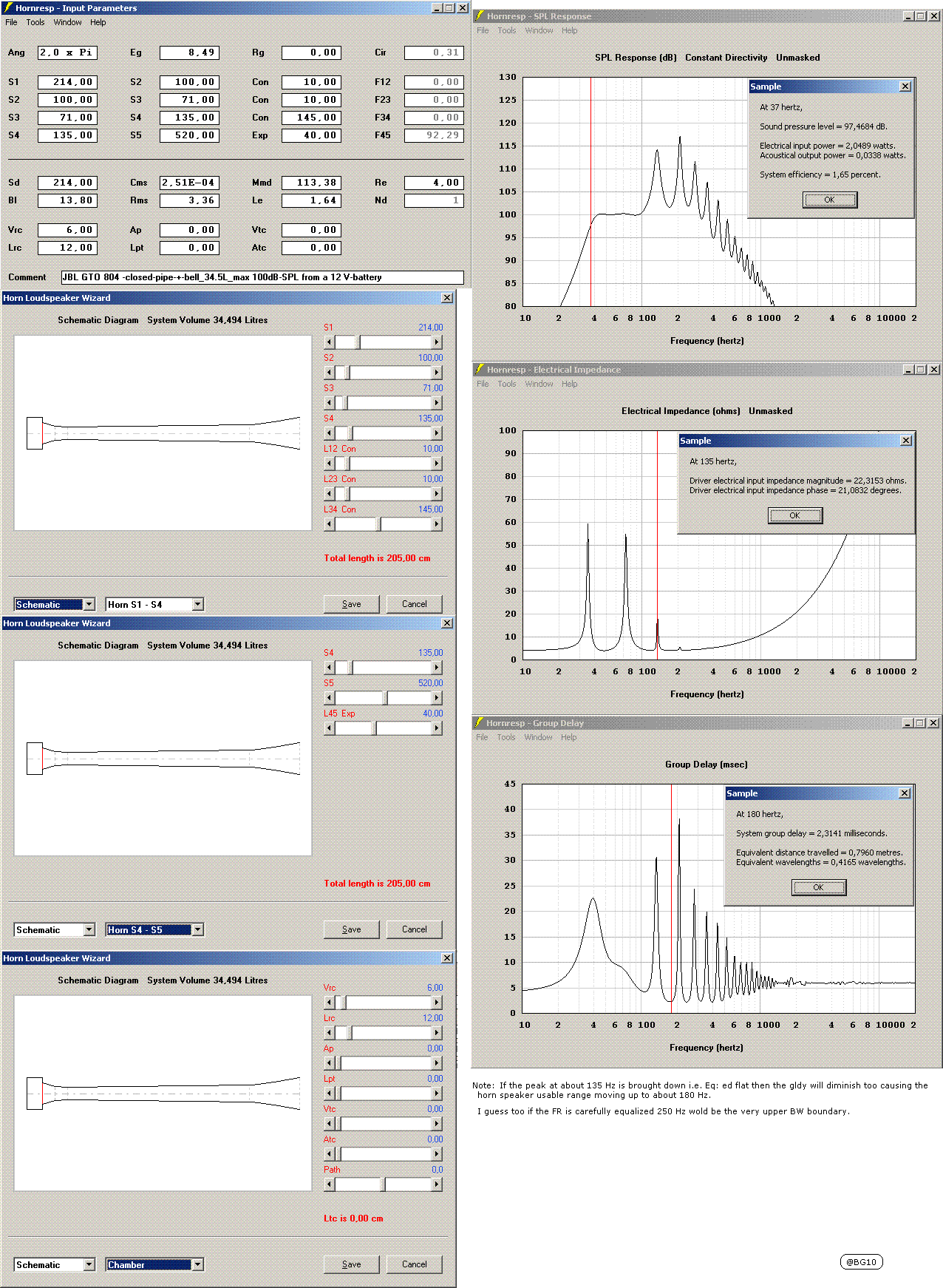

max axe;2082214...I am looking for suggestions on how to design a unique loudspeaker...[/quote said:...I need a unique portable sound reinforcement speaker based on a horn of around 8 inches in diameter. The device would naturally be limited in frequency range. The question is how to extend the low end below the horn cutoff...But theres more; This thing must look like some kind of novel musical instrument...
Hi max axe,
Here is a quick HR simulation that might be a solution for the lower end of the FR:
b
bjorno
Thank you. Thats very cool. Its interesting that a trombone with its very narrow pipes can hit 80 Hz at 130 DB. Maybe flapping lips are the new driver paradigm.
This geometry would be great for a floor standing bass augmentation. If I could get a good seal I could open it up like an instrument case and carry the wind instrument inside. What is your thought to specify rubber on the long section?
My original query, naive as it may be, is what would the frequency response be if you replaced the closed section with a horn of mouth diameter 20 cm driven by a rather small full range, like Peerless 830970 2", (that would project to the left if we are modifying your diagram) and then used a scaled down cross section of your TL to the right. Aiming for perhaps 200 Hz. This would be the Bose concept of rear phase addition, except the shorter of the TL legs is substituted with a horn. The idea is that I want to attach it to the instrument and carry it whilst playing....
Im curious if you compared the response of your bass design using a straight 8 inch tube of the same length....

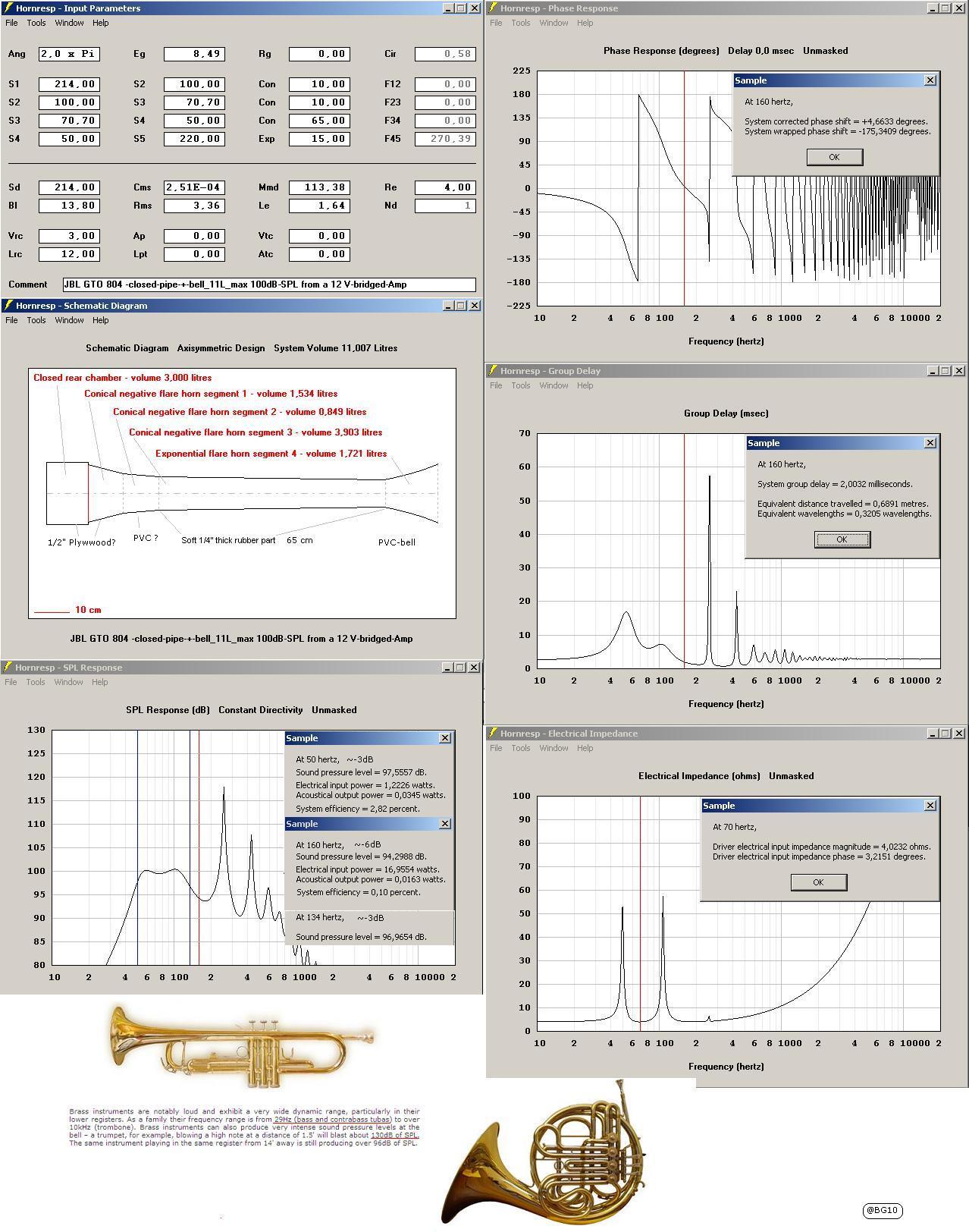

bjorno
You can use any airtight material for the pipe but the rubber pipe idea i.e. using a soft bendable, expanded closed cell rubber insulation pipe, originates from a sound leaking tube test I made years ago with a 4” driver I mounted on one end of a 2m closed lambda/2 tube where the driver also faced a closed box of fc= 85 Hz at the basket side.
A few dips were seen in the measurements I made but were not so easily heard when playing music.
Most of the midrange and the treble range were much attenuated but the mid bass and upper bass came through at a higher level and sounding quite smooth and of course attenuated.
...My original query, naive as it may be, is what would the frequency response be if you replaced the closed section with a horn of mouth diameter 20 cm driven by a rather small full range, like Peerless 830970 2", (that would project to the left if we are modifying your diagram) and then used a scaled down cross section of your TL to the right. Aiming for perhaps 200 Hz. This would be the Bose concept of rear phase addition, except the shorter of the TL legs is substituted with a horn. The idea is that I want to attach it to the instrument and carry it whilst playing....
I don’t think a single Peerless 2” is the answer ‘SPL wise’ but 4 are, that is if a quadric or bell like aperture is placed in front of the drivers (See the picture of 4x Peerless 830970 in a HR simulation attempt targeting a Unity horn).
Each driver should be equipped with a small closed volume at the basket side.
An extra TL pipe or open back wouldn’t extend the FR much and as can be seen in the picture, but a small terminating volume (compliance) would reactance balance the horn to the better = flatter FR.
...Im curious if you compared the response of your bass design using a straight 8 inch tube of the same length...
This would IMO result in an untamable and horrible FR throughout the whole BW and of course not that portable too.

Hi Max,GM_all
A new HR simulation of the 'portable sub' now not so portable but maybe can be curled up to a 'case' ( detachable sections)?
b

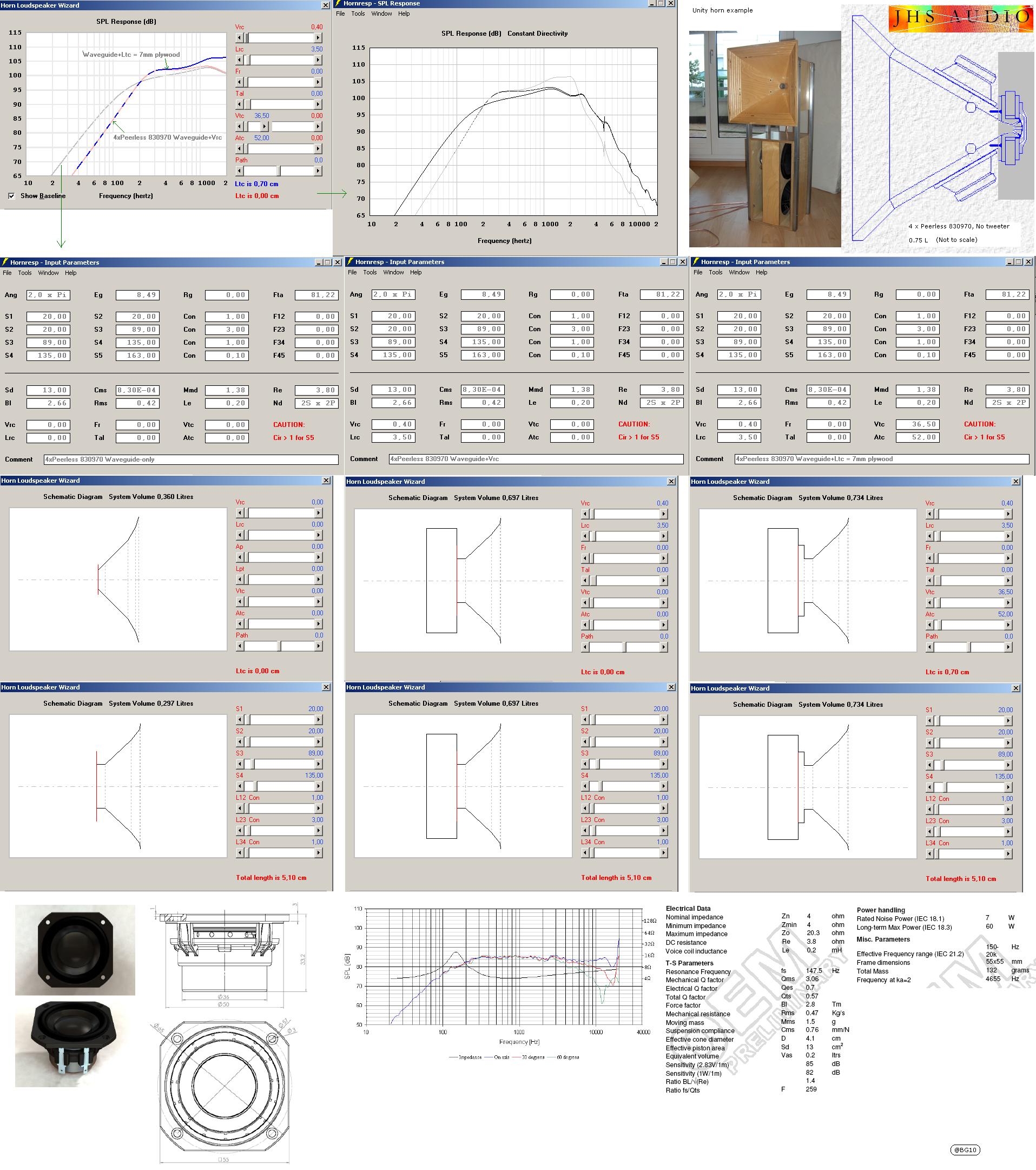

I think you're getting the point. But in fact I do play in a mind wrenchingly loud maelstrom which I must overcome. I normally play the flute with a couple of flamenco guitarists, electric bass and drum kit. Even with close floor monitors, its maddening to try to hear what youre doing. You constantly think your instrument is broken or something terrible has gone wrong. Imagine trying to give a speech or sing a song in front of 200 people and finding you cant use consonants. But your point is valid in a number of ways though. The idea of audiophile reproduction is not so much an issue because the instrument in question is playing as a monophonic voice. A change in timbral characteristics from speaker coloration is like playing a violin made from different manufacturer. In fact SOME fixed resonances might create a more realistic sounding instrument, because the samples that the synth plays are probably every third note up the scale and who knows how they processed them.
Hmmm, I didnt have to go far to read about the Unity Horn. I spoke too soon of course, sorry. "Unmatched voice intelligibility and precise music reproduction due to the time-aligned phase coherent design"
Man, the degree to which you brains get into this stuff! I dont really know if I have it in me to get up to speed on the science within this lifetime.
When I hear statements like "the subtle airy presentation of the fifth octave" I realize that we are in different worlds as far as goals go. Im just trying to survive sonic hell.
Ive recorded in some of the best studios in Arizona, and I guarantee that while engineering these, there is an effort made, but its nothing like what the audiophile gets into. And then there is all of the compression and effects applied....
Then stage performance is a completely different world than studio recording and you are cast into a roaring, reverberating, clipped, feedback plagued nightmare of audio overload. Its mainly this world that Im trying to create a solo voice instrument loud enough to be heard so I can just figure out what Im doing, whos playing what.

I rather like the idea of bjornos bass tube and the horn loaded concept for the power of it. But Im stuck on not going more than about 8 inches in diameter, and the horns in question seem to be twice that, although I havent checked bjornos last analysis for dimensions. Im not too keen on getting deep into crossover design either, and I would be willing to compromise sonics to some degree to simplify that part of the project.

Now if this system that bjorno is coming up with could sound as good as I imagine, I could see making a pair and using it as a stand alone PA in its own right. It would look very cool to have those horns. Certainly for now there is the problem of the octave + between 200 and 550 Hz. ......an 8 inch horn that goes to 200 Hz....."impossible" said the engineer to the trombone player.
