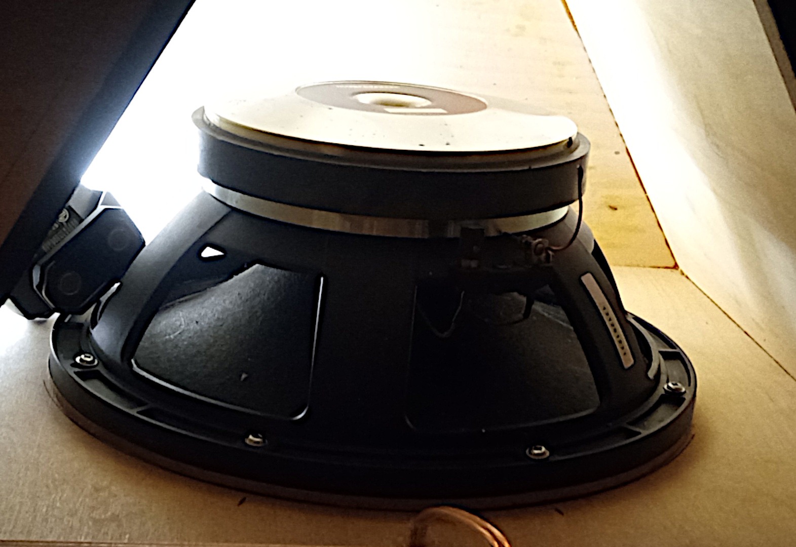

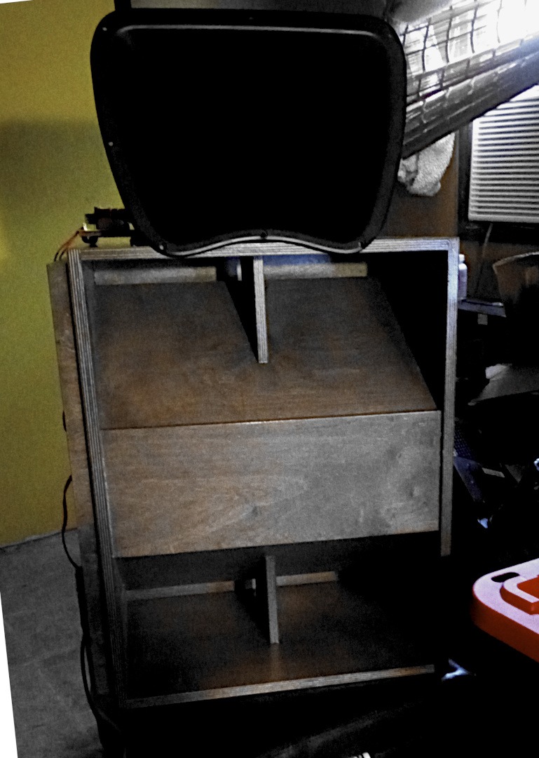

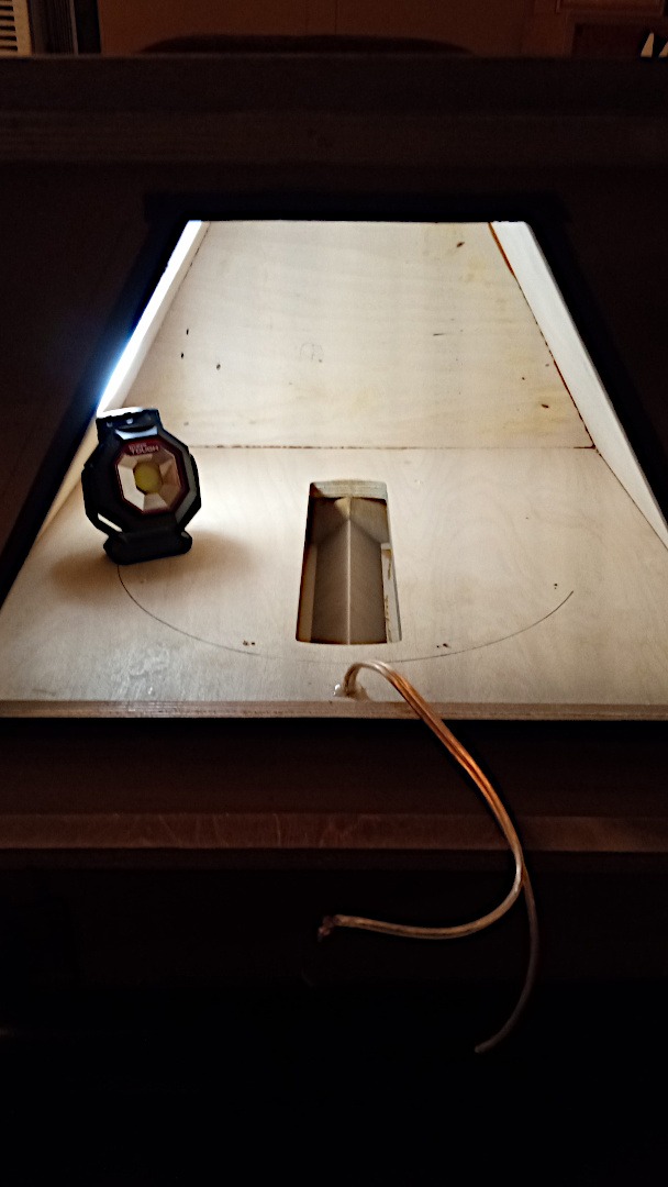

"Small" horn rigs based on 100Hz up folded horn
I've been playing with a 12/15 scale Klipsch Belle (18.75"H x15" D x 23.75"W along with a very high xover to whatever horn I had handy. (A B52 waveguide and DE250)
Anyhow I like what i hear from the little W-bin more-so than what I got from my Peavey FH1. I think a pair of 12/15 Belle w. midhorn and treble horn - or as two way could make for a dynamic sounding system which would be relatively compact and work in situation s where a straight midbass horn's depth is unacceptable.
