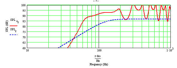

well I translated the isometric drawing to a 2d side view in Autocad. The horn length is approximately 58", So=4.25", Sx =21.85" (or so, I took a little poetic licence). The ratio is 5.1388
Fill the cavities with sand (providing you have a way to ensure they don't topple over). I end up with a 1/4 wave frequency of 58.6Hz for a 58" horn length.
The material is 3/8", so use Baltic birch, finish the interior exactly as the exterior (ie, paint if exterior is to be painted, etc., )
I wonder if there is an English print of these out there🙂. I guess somewhat similar to the Frugal Horn, other than Dave has em firing rearward..

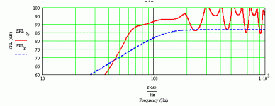

I'd call that an expanding TL rather than a BLH. MathCad predicted response attached, using above dims and the FE83E, which is probably going to be roughly similar to the original driver specs. (And the magnet might just about fit).
I've seen worse, though it'll need damping out, and as it's a straightforward expansion as far as I can see, no filter chamber, with the mouth effectively on-axis to the listener, I suspect you'll run into problems with mids coming out of the vent. Note the classic expanding TL nulls at the odd harmonics.
It might go a touch lower due to the reflectinal boundary condition of the floor nominally doubling the mouth size, but I wouldn't bet on it -Fs of most any driver that'll fit this thing will be well over 100Hz, and you won't want to try pushing them too hard. Nothing to stop you from scaling it up though.

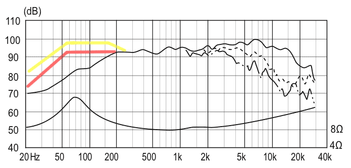

I'm not really worried about the size anyway. My Fostex recommended 108 horns are about the size of Ron's A126, so anywhere between that and Frugal size is ok. I just want super sound and I don't want a front mouth.
AndrewT said:
will it still be a horn?
Rear facing mouth for mid freqs probably won't work either.
In a back loaded horn, you don't want mid frequencies to come out of the mouth... you want to lift the drooping response in the bottom to make it flat (red in the FE126e FR plot attached) or lift it a bit to compensate for baffle-step (yellow -- which with BS would be where the red one is). Note that there will be a dip in FR due to baffle-step between where it starts and where the horn action can start creating lift, hence the need for a wide baffle so that baffle-step doesn't start until where the horn can start compensating for it (hence the supra-baffle on the RonHorns & the Frugel-Horn, or the wide baffle in John's tombstone proposal.
Rear mouth gives the advantage of using a wall/floor or a corner to multiply the mouth size. Otherwise you are faced with a Klien-horn size box (KH designed to do 30 Hz in free-space IIRC).
By using the corner (and the deflector to further increase mouth size) the Frugel-Horn, for example, has a mouth large enuff to hit ~50 Hz. Against a wall/floor this would be ~70 Hz
In a box such as the Fostex recommended horn for the 108es with a front terminus up off the floor, we don't really have a horn at all, but a transmission line.
An approximation of the cut-off of a horn is that the circumference of the mouth equals the wavelength of the cut-off frequency divided by the multiplier (1 for free space, 2 for floor loading, 4 for wall/floor, and 8 for a corner) -- approximation because the further the mouth is from a circle, the less true it is.
In the FE108eS fostex "horn" circumference = ~35" with a multiplier of 1 -> ~400 Hz. Since we are trying to have the terminus output fall above 200-300 Hz you can see there is really no horn action at all.
In the Frugel-Horn (Level 3) the mouth circumference is ~120" with a multiplier of 8 -> 15 Hz. The reallities of the rapid flare at the end and the high aspect ratio means that this potential is not met. We'll see how low they really go when we can get a mic on them.
It is pretty easy to see that any rear-load horn with a front mouth is either going to have to have a very large mouth or depend on TL action for the lowest frequencies.
Another advantage of the rear mouth is that it gets the driver (think satelittes) out a bit into the room where they will image better, yet leave the mouth (woofers) near the room boundaries for maximum reinforcement.
