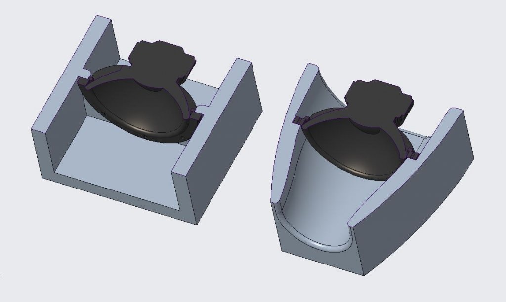

I'm sure this isn't anything particularly new, but I've considered making a modified H-frame with a taper on the front, either with wedges/slanted front sides, or as a cone if starting from a cylinder. My interest in doing so was actually driven more by partially hiding the fronts of the drivers from view in order to better make large drivers integrate with my wife's preferences! 🙂
Here is a cross-section showing the H on the left and the tapered H on the right.
For this particular example I was trying to make the GR Research OB servosubs have a front baffle width that would also match their Oticas (and their "wings").
Would the tapered H-frame have the same cavity resonance limitations as with a ripole? Or how would one model this? I think the above image on the right, which was a rounded slot, was reducing the Sd to about 1/3 Sd.

That seems similar to the slot loaded open baffle just a different shape restriction. The resonant peak may be hard to model; I think Linkwitz just measured it.
