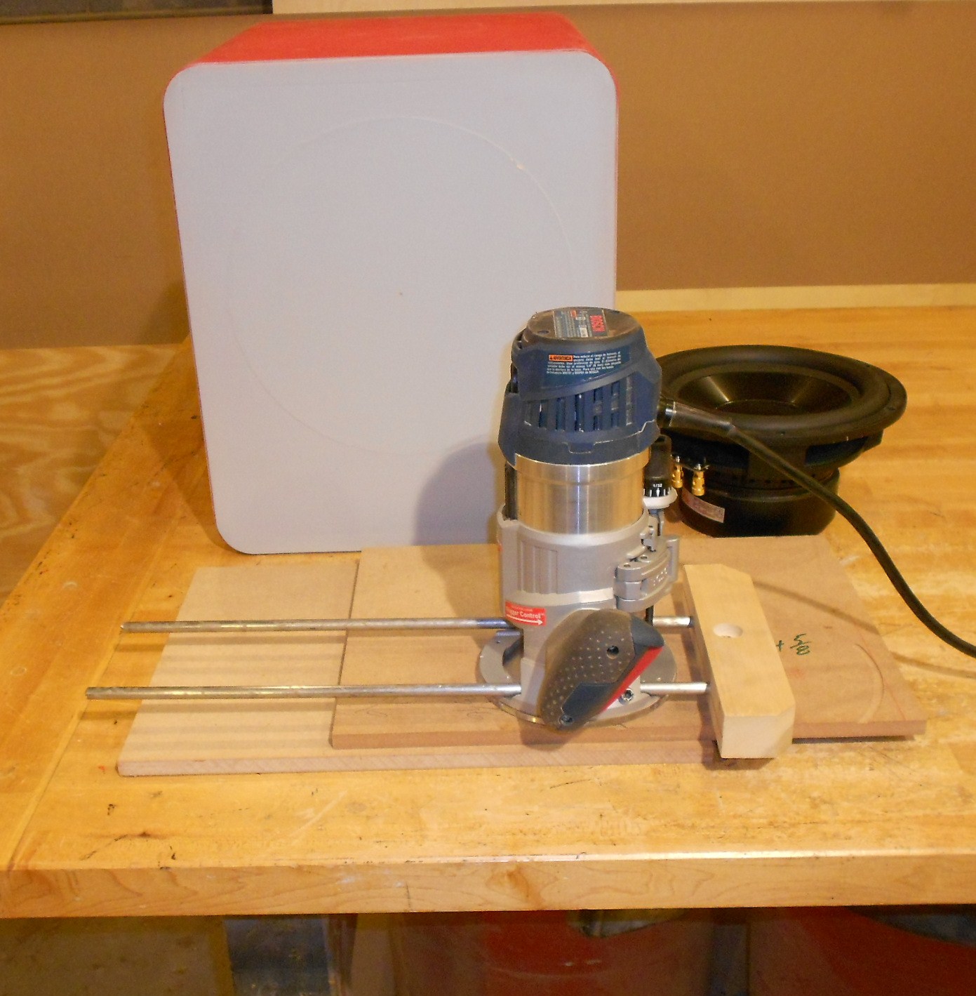

Made a few of these - this one took less time and better than others.
Just set steel rods in wood
The base has a thumb turn to drop into wood.
btw I...going to mark depth on Alum base, so know when almost thru (-; (-;
btw II... retrofit speaker box, the cutout was for a 12" - glued in plywood ring (lap) going to cut for 10".
