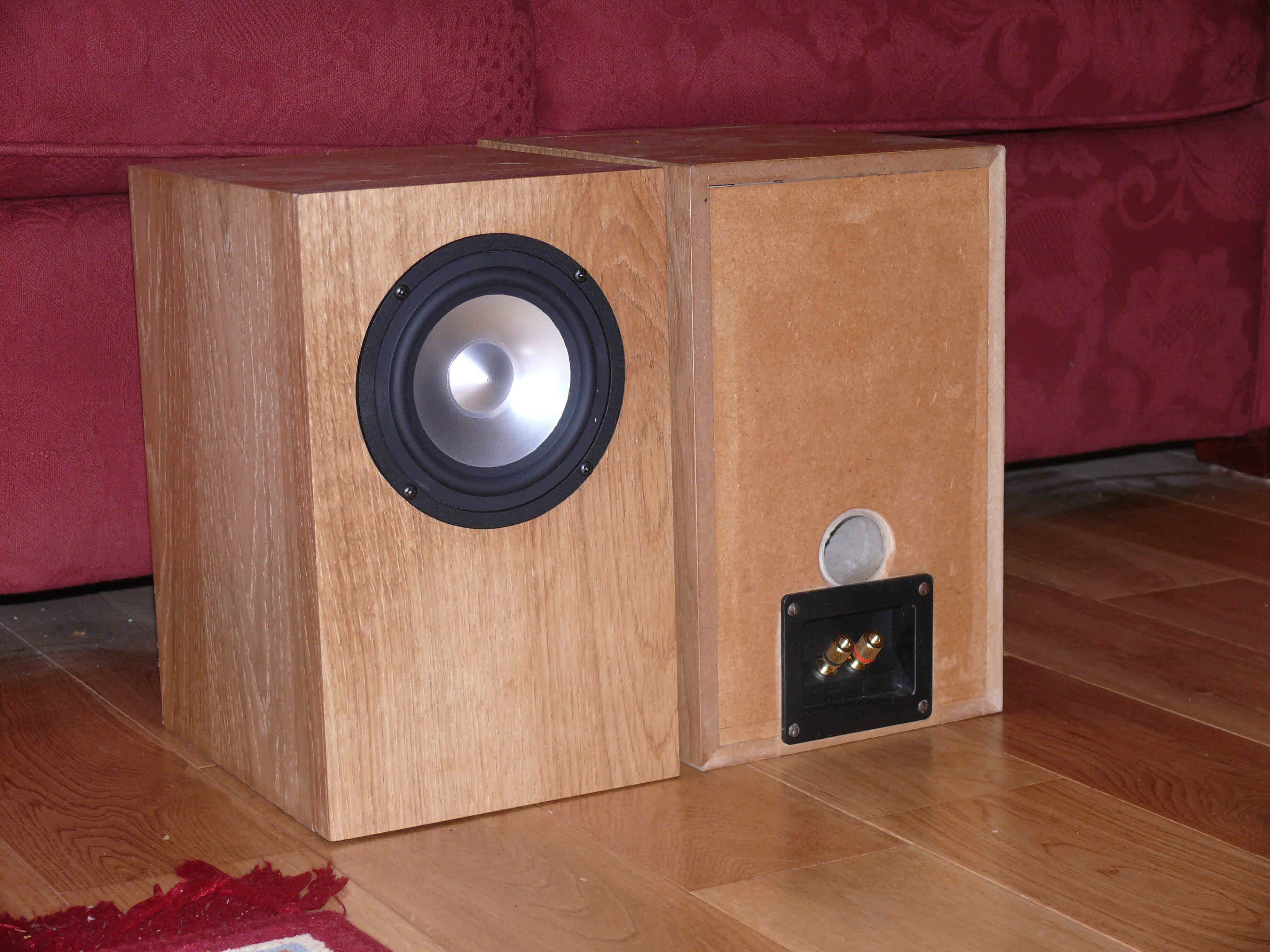

Two or three years back I posted details of my oak transmission line speakers with Jordan drivers.
I have now made a pair of small speakers using the same model driver.
There are 12inches high, 7.5 inches wide and 9.25 deep. The front panel is oak and the sides and back are MDF. The terminals are from Maplin. There is a vent on the rear. The panels have carpet tiles glued to all surfaces on the inside.
They sound very good, almost as good as the transmission line speakers but lack the full bass which the TL speakers give. They sound as good as my small BBC LS3/5A monitor speakers.

Very nice, about the size I'm looking to build. Those don't look like inverted surrounds, which drivers are those?
Really nice! I bet that has a lot of good thump to it.
Redshift187, the driver looks to be the JX92S (mine have non-inverted surrounds just like in the picture).

I used the JX92S which I purchased directly from Mrs Jordan in Wales. http://www.ejjordan.co.uk/systems/jx92_system.html
You can see my transmission line speaker at http://www.diyaudio.com/forums/multi-way/9407-konus-audio-essence-4.html#post1395382 Which uses the same driver
