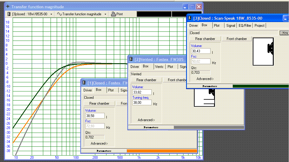

You can also look at other drivers like the SCANSPEAK 18w8535 used for the ProAc2.5 that is a very good driver, with less output at around +-86dB (Fostex is 90/95dB). I tested it here for you in a closed 30L enclosure. (Fostex 12" in a closed/BR enclosure for comparison)

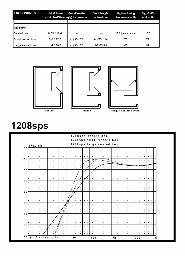

I don't know how they would be. But I got another idea for you, based on two speakers (that are very similar). The Black Widows. Peavey 1201-8 12" Woofer 98.5dB(94-100dB) for woofer and 1208-8 SPS BWX 12" 97dB for the 4 subs (Qms=9.513).
Another option is to get this woofer (1201-8) but with a different setup for the sub like two 4Ohm drivers in series.
I can assure you I would choose this baby for a monitor right now (based on the performance of the Impulse 1012 Peavey speaker).

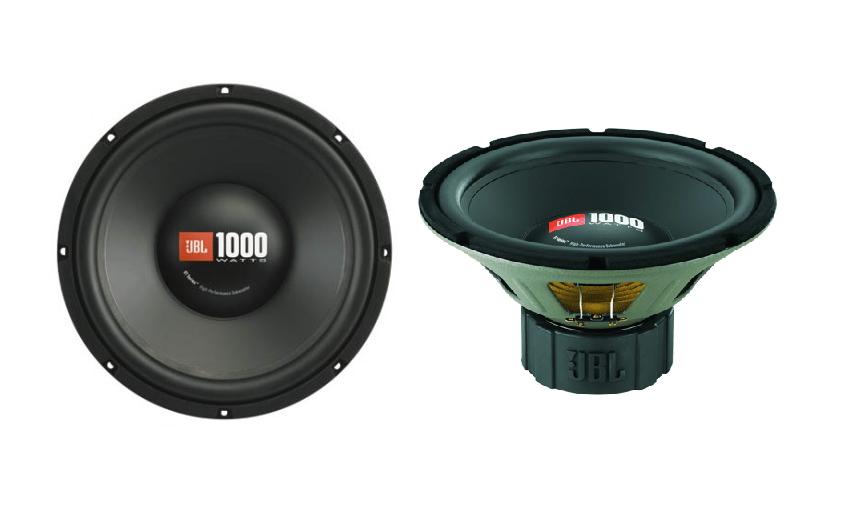

In reality, for the sub, I would go with a speaker driver with Fs lower than 35Hz of the 15" type specifications, if a had to stay with a 12", I would considerer a auto type to, like the JBL 12"GTO with rubber surround w/two in series and Fs=24.75Hz, price on the 100€/150$ range.
