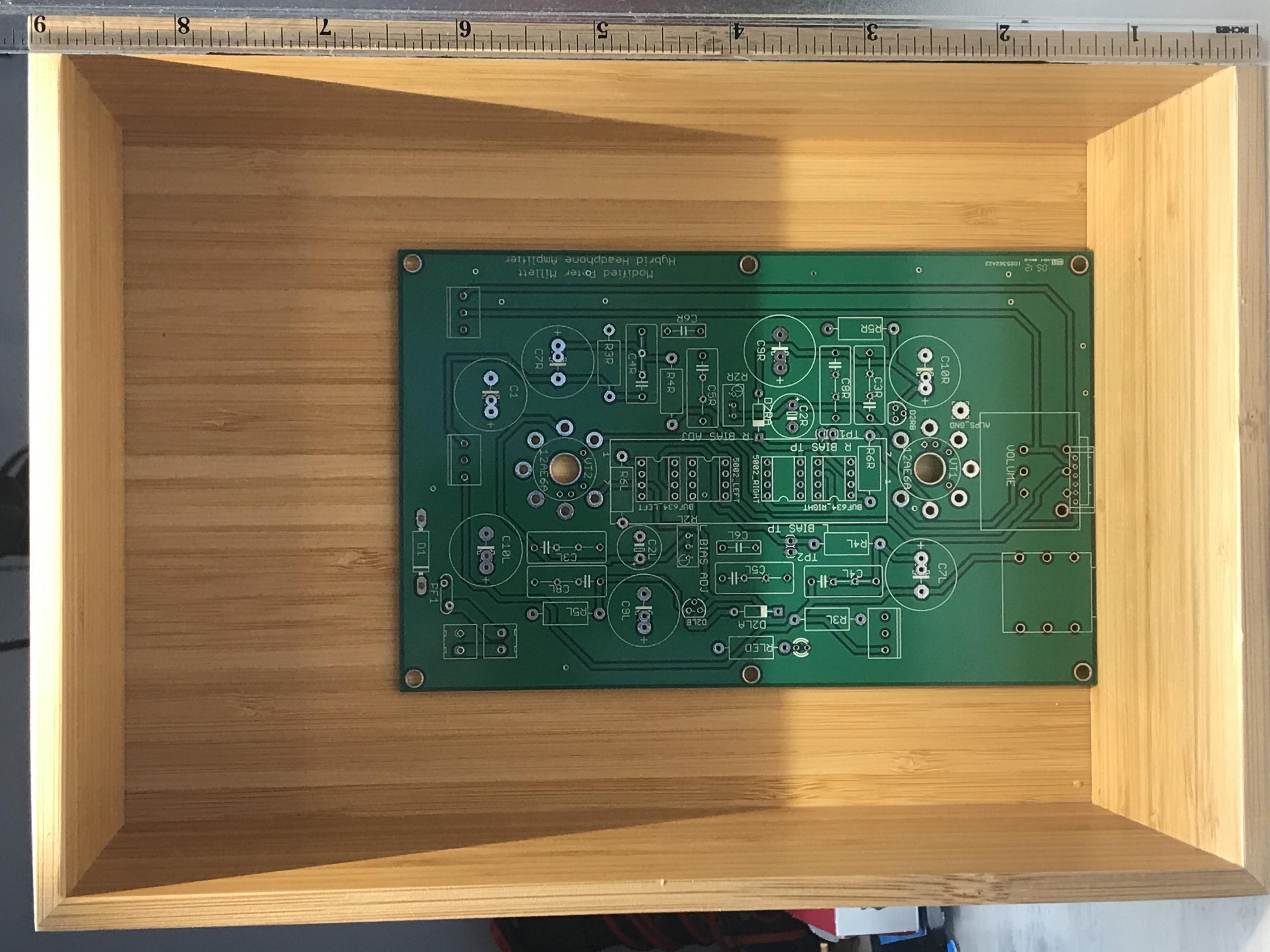

I have an old Millett Hybrid headphone amp pcb I am wanting to put into a small case with a Raspberry Pi3+ (with HAT dac) and a 2.5" HDD. I've been trying to determine what would be the best way to power all of this off of one power supply as I want it to be a self contained unit for my office.
The amp requires 24V/0.75A and I currently am using the Pi/HAT/HDD with a 5V/2A wall wart.
I've used a Tangentsoft TREAD back in the day to regulate the voltage to a Millett with good success and I'm looking for something that is similar in size as I would like this to be as small a footprint as possible. So the HDD will go under the amp pcb and the Pi/DAC will be vertical along one of the chassis sides. leaving one end of the 6" x 9" box open (amp pcb is 4" x 6").
I was thinking a dc/dc wall wart 24V/3-5A into a small linear regulator to get the 24V to the amp and to a buck converter to the 5V to the Pi/HAT/HDD. I'm not much on power supplies that have two completely different voltages so I'm kinda lost here.

The amp is a tube amp. It needs a minimum of 500mA but works better at 750mA. It only outputs a fraction of a watt. Each tube needs at least 10V but I’ve found it sounded better at 11-12V.
Here’s the amp pcb in the enclosure for size reference.

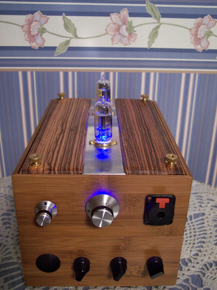

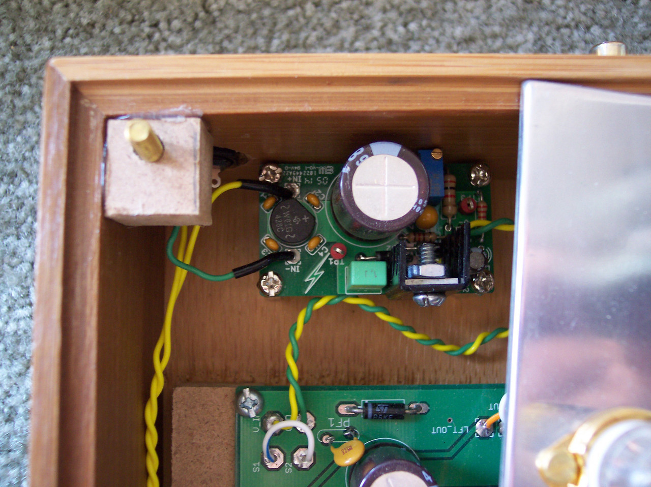

Here’s the amp I built back in 2006 or so with the LM317 TREAD regulator and a overall shot with it on top of a DIY Meier Crossfeed.
