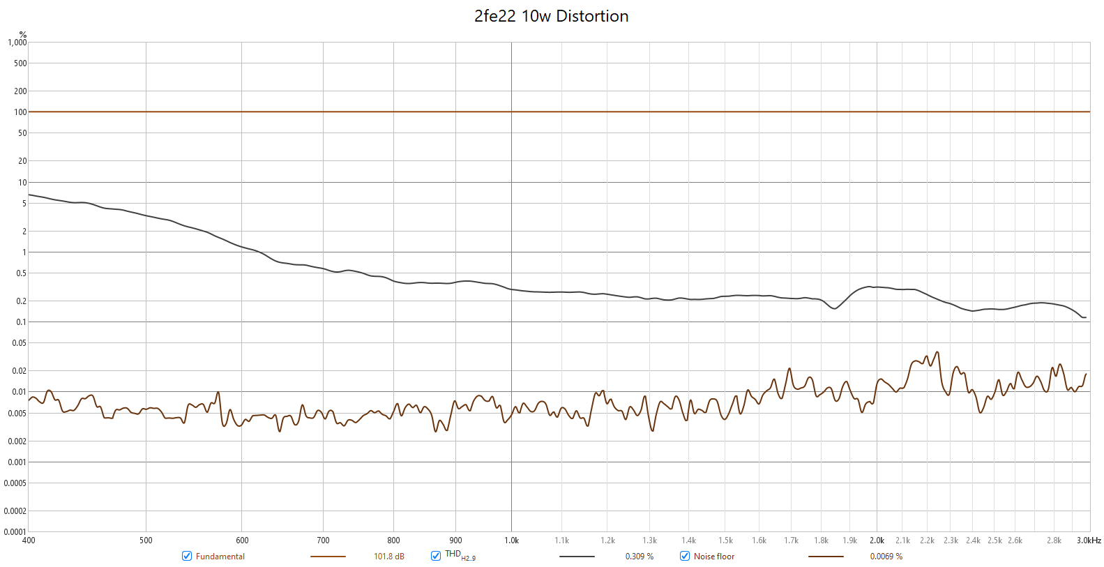

I have tested the 2fe22 and it seems loads better. gets a little high lower down but if I cross over at 650 it will hopefully be ok. This was at 10w it was a bit lower at less power

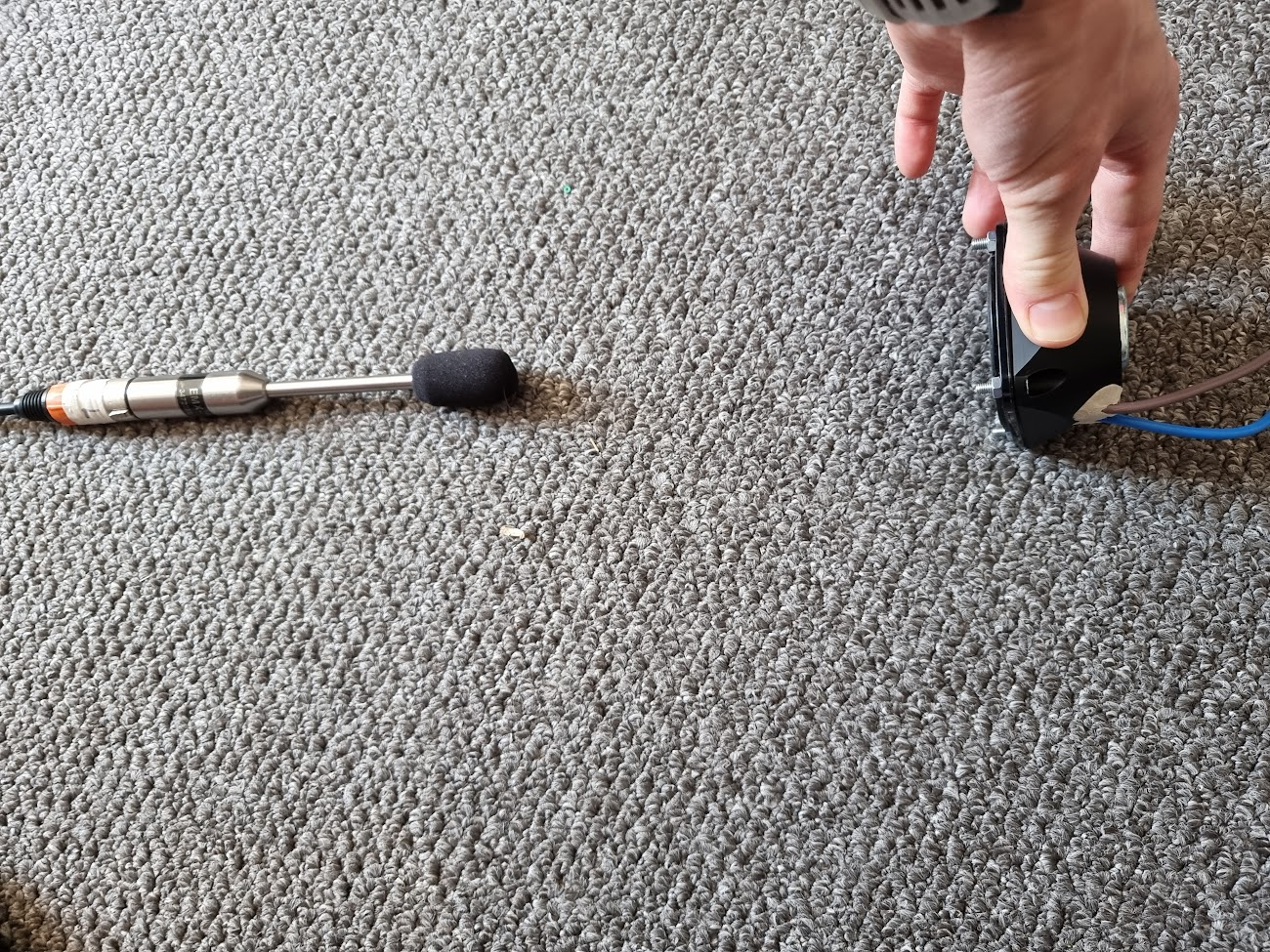

My test setup for this:
I haven't measured the sensitivity of it yet, next this is redesigning the front chamber and seeing whether that adds any distortion. I need to measure the cone as it seems different to the 3d model then also do some more path length correction on it so it might take me a while haha

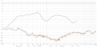

I have finally managed to test the 2FE24 properly. Had to get some CAD finished for it.
The distortion is much lower but still not really low.
I think I need to have a go at adjusting the rear chamber and front chamber size. Is there a method of sizing the rear chamber to reduce distortion?

the smaller the rear chamber the better (up to a point) if you are not looking for response below 500 Hz. small chamber means more air spring/compression which reduces excursion which might reduce distortion. increasing the front chamber will give increasing acoustic low pass filter effect which might filter out harmonic distortion products but also might attenuate desired high frequencies

You really want it 100% sealed. Look at sealed back mids as the ultimate expression of the principle. The get a little bit of peaking at the low end and are only rated with minimal linear excursion because the tight seal neither allows nor needs more - unless you are trying to get below 400 hz or so.
