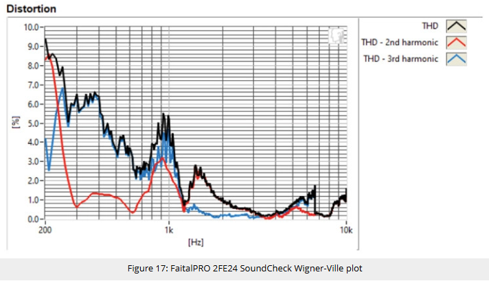

So far I have been designing it around the Faital Pro 2fe24 however from doing measurements the distortion is mega high at 10% THD at 10W around 600hz. It's still mega high on less power minimum 2% or 3% THD
Edit: thought I would add that this distortion is even just with a small rear chamber and no front chamber/ports/horn

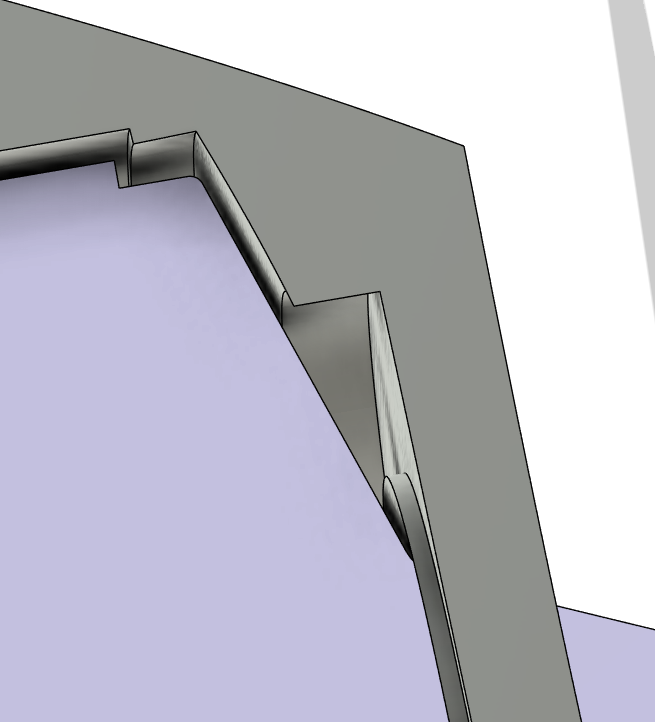

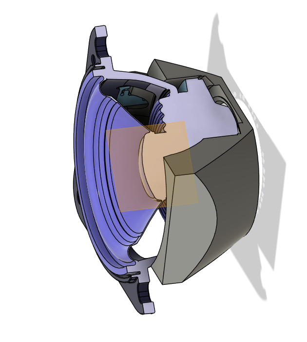

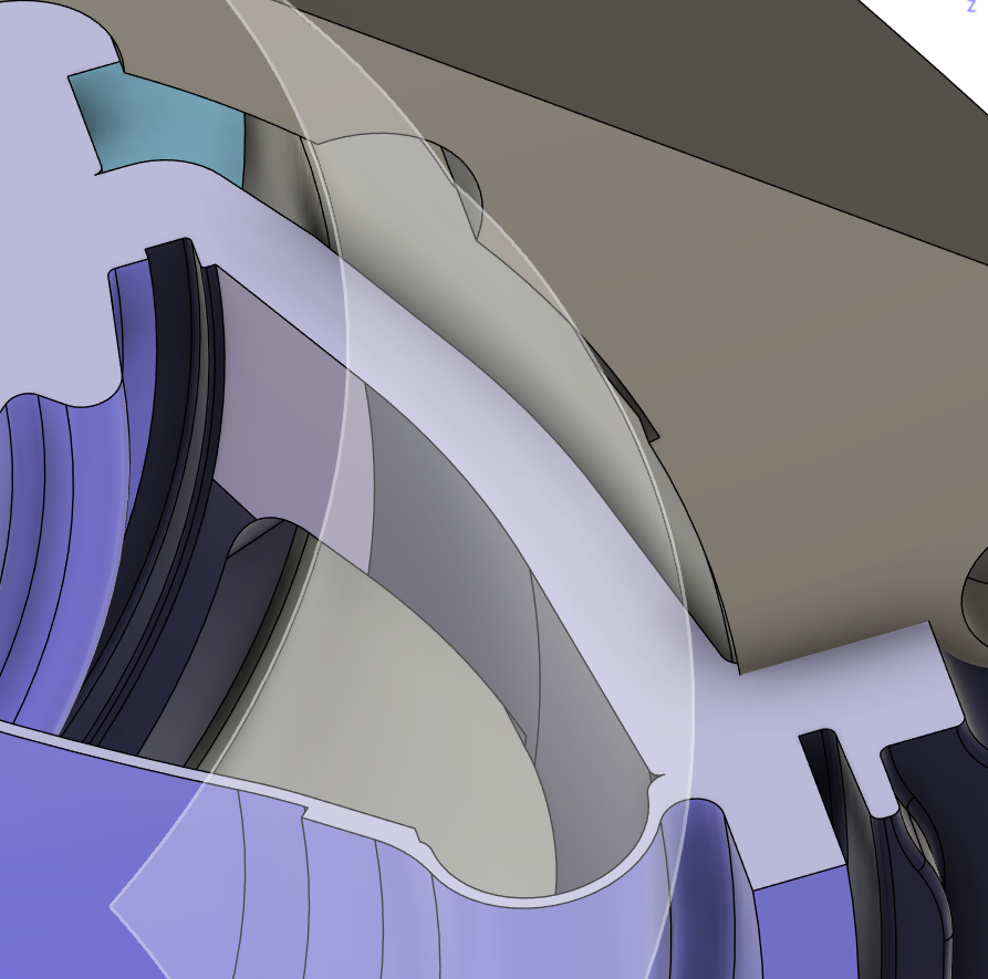

This is the rear chamber I made for it: (I got the 3d file from Faital Pro and seal it with a small o ring at the top)
It is fully sealed, you can tell because the cone is harder to move than when it's free.

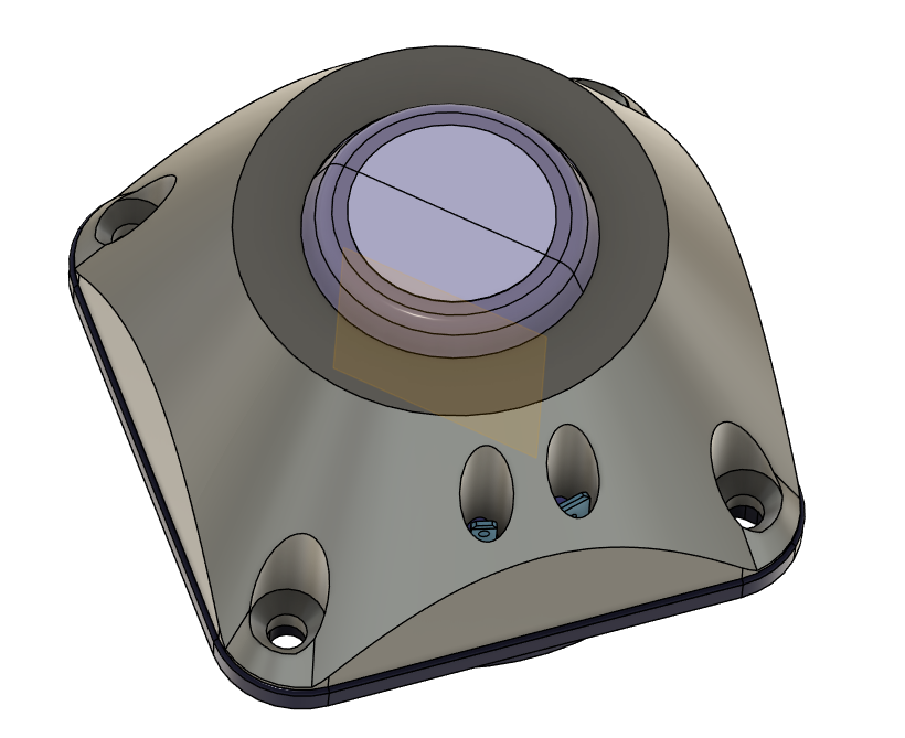

I have designed a rear chamber for the 2ndf22
I'm going to print a piece to test the fitment then I will get it fully printed and measured.
I have a slot in the top for an o ring to seal it
Unfortunately the dust cap is slightly different on the 2fe22 than the 2fe24 and the model isn't quite correct so I will need to make some adjustments to the MEH design

I would suspect I had done something wrong or that there was something wrong with the driver, if I saw very high THD even at low power. Back in the day, I built line arrays using 32 2.5" drivers each side and they showed the reverse problem - low THD at low power, high THD at high power but that turned out to be an inadequately braced rear panel. The drivers were the SB65WAC25. Lots of line arrays have been built using "quite a few" small full range drivers with good results.I will take a look at those. I am planning on using quite a few 2" drivers to get over the efficiency. It's more the very high THD even at low power
I'm back to wondering what the Fb is for a chamber that small. In your model it looks miniscule. If we assume 0.02 liter sealed, you get an Fb of about 630 Hz if my sim is correct. I don't think you've specifically stated your lower cross point goals.rear chamber for the 2ndf22
The Voice Coil review showed pretty high distortion at the typical test levels also. Since the sensitivity of the driver is stated as 85 dB, 94 dB isn't an extreme level to test at (but not "low power" either). The free air configuration for the test makes things harder to decipher, but the distortion plot would inspire me to test that aspect pretty early if I were investigating that driver.if I saw very high THD even at low power.
https://audioxpress.com/article/faitalpro-2fe24-pro-sound-2-5-full-range
"For the distortion measurement, I mounted the FaitalPRO 2.5” full-range driver in free-air, and set the SPL to 94dB at 1m (7.2V), using a noise stimulus. I then measured the distortion with the microphone placed 10cm from the dust cap."
I have been using 0.02L in my simulations. I have been aiming for around there, I haven't measured the impedance yet to figure that out.
That graph is interesting, distortion looks pretty high on that driver in general. I will hopefully get some measurements of the 2fe22 tomorrow.
I checked some measurements I took around a year ago using the same driver and it had high distortion. They also had a different small rear chamber that I made using tape and hot glue.
That aspect of their testing varies in how it is plotted, what the level is, and whether a test box is used or not. That makes interpreting the plots a little harder. I looked around a bit for comparable drivers tested the same way and included a few below.distortion looks pretty high on that driver in general
With a driver this small running free air, dipole cancellation is happening so high in frequency that I can imagine it causing accuracy issues even at lower midrange frequencies. I haven't run a distortion test this exact way, so can't say for certain what the impact is though or what conditions interact.

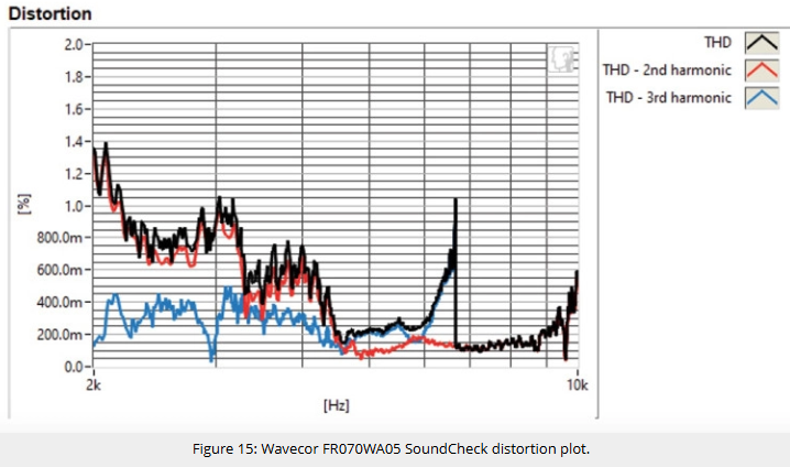

https://audioxpress.com/article/tes...r070wa05-aluminum-cone-full-range-2-75-driver
"For the distortion measurement, I mounted the FR070WA05 driver rigidly in free-air and set the SPL to 90dB at 1m (7.66V) using a noise stimulus. Then, I measured the distortion with the microphone placed 10cm from the dust cap."

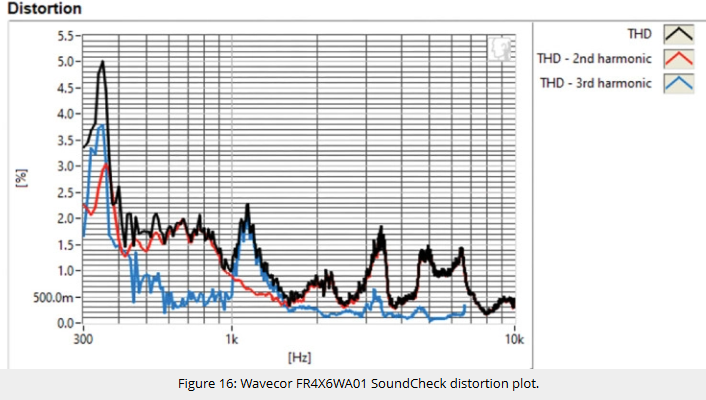

https://audioxpress.com/article/test-bench-wavecor-s-fr4x6wa01-oval-full-range-driver
"For the distortion measurement, the Wavecor 1.75” × 2.5” oval full-range driver was mounted rigidly in free-air, and the SPL set to 90dB at 1m (6.0V), using a noise stimulus. Then, I measured the distortion with the microphone placed 10cm from the dust cap."

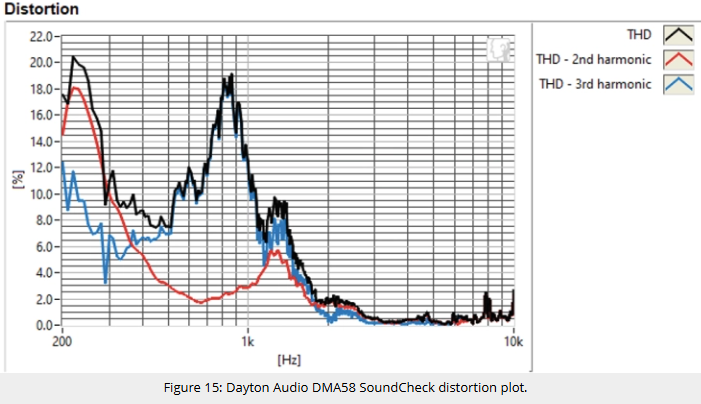

https://audioxpress.com/article/test-bench-the-dayton-audio-dma58-4-2-full-range-speaker-driver
"For the distortion measurement, the DMA58-4 was mounted rigidly in free-air, and the SPL set to 94 dB at 1 m (9.86 V), using a pink noise stimulus. The distortion was measured with the microphone placed 10 cm from the dust cap."

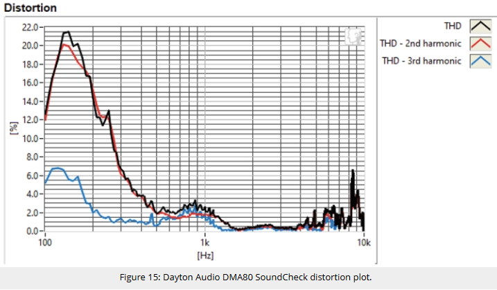

https://audioxpress.com/article/test-bench-the-dayton-audio-dma80-4-3-full-range-driver
"For the distortion measurement, I mounted the DMA80 rigidly in free-air and used a pink noise stimulus to set the SPL to 94 dB at 1 m (7.55V). Then, I measured the distortion with the microphone placed 10 cm from the dust cap."

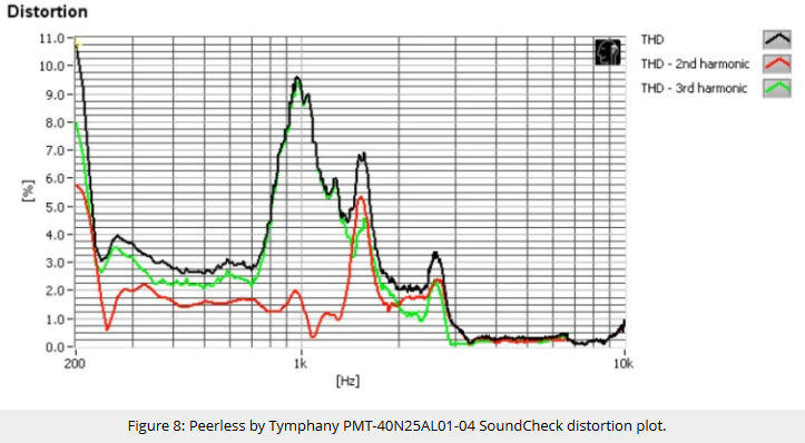

https://audioxpress.com/article/tes...phany-pmt-40n25al01-04-mini-full-range-driver
"to measure distortion and generate time-frequency PMT-40N25AL01-04 in free air, and used a noise stimulus to set the SPL to 94 dB at 1 m (8.1 V). I measured the distortion with the microphone placed 10 cm from the dust cap."

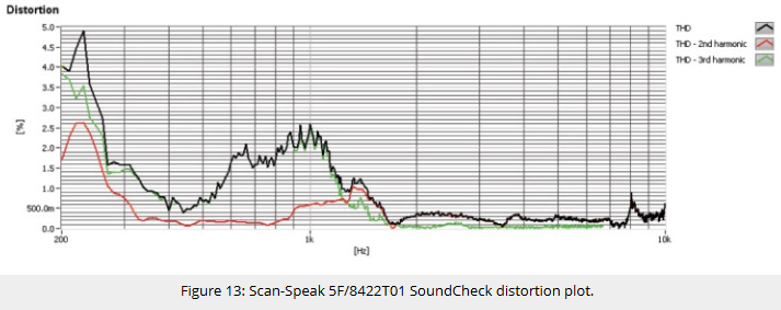

https://audioxpress.com/article/test-bench-scan-speak-5f-8422t01-2-full-range-driver
"For the distortion measurement, I rigidly mounted the 5F/8822T01 in free-air and used a noise stimulus to set the SPL to 94 dB at 1 m (7.2 V). Next, I measured the distortion with the microphone placed 10 cm from the dust cap."
