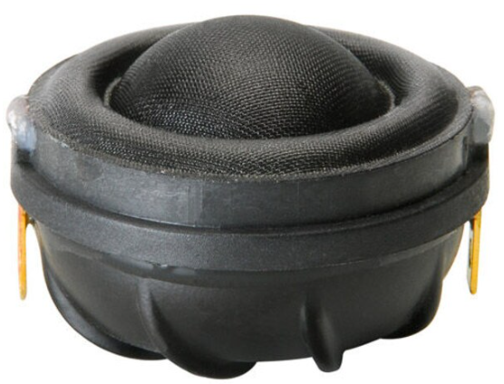

I am looking for a really small dome tweeter. The idea is to get a really like spread of sound throughout the room and the smaller the tweeter, the higher the frequency it falls off. At least, that's how I currently understand it. Feel free to correct me.
I am looking at this Peerless unit and wonder if there are any other small diameter dome tweeters I should be looking at.
https://www.parts-express.com/Peerless-D19TD05-08-3-4-Poly-Dome-Tweeter-264-500?quantity=1

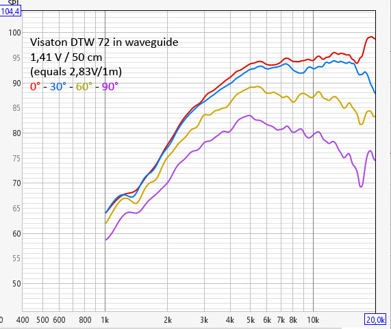

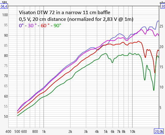

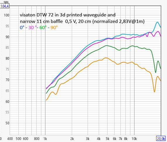

I believe the diameter of the driver plays a very large role in when the frequency response starts to drop concerning off-axis. Here you see this very tiny tweeter doesn't drop off axis until around 9000hz. So if I stay within the proper octave of the diameter of driver I can basically have an even spread across the room and it won't matter where I happen to sit.

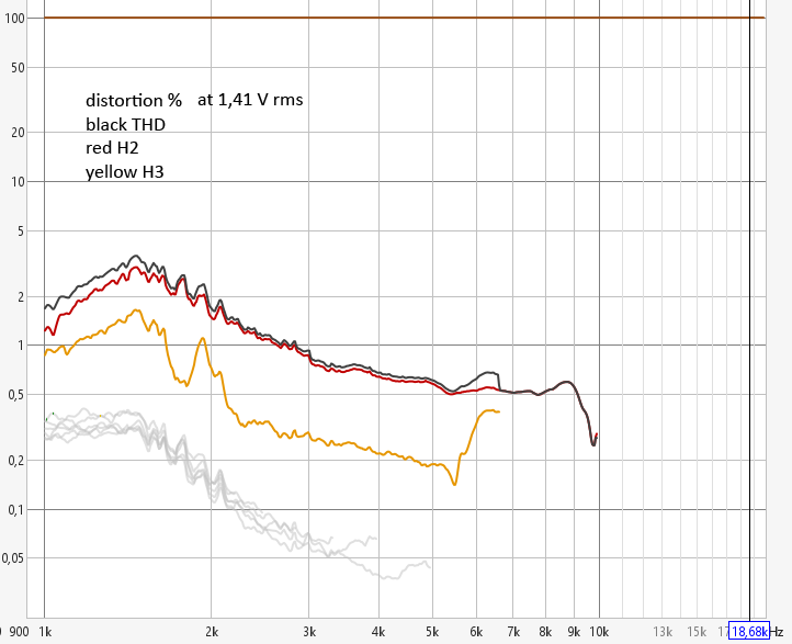

Another small dome which performs very well with low distortion is hiquphon. Not cheap.

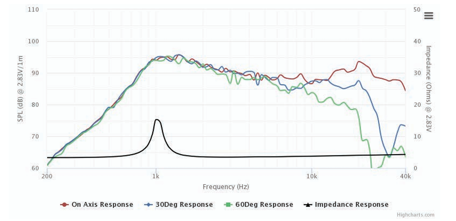

However, recently for 4way, i was putting small foster planar on top. Great flat response to 40kHz, flat impedance, great dispersion, low distortion. Cheap, was on sale.
Foster e100t10 planar does not seem to be available, but there was plenty from other sources.

I believe Buchardt S400 actually chose the 19mm dome, because it "loaded" the waveguide better, since a soft dome tend to have a taller structure to support its shape, even though it's made from soft material.

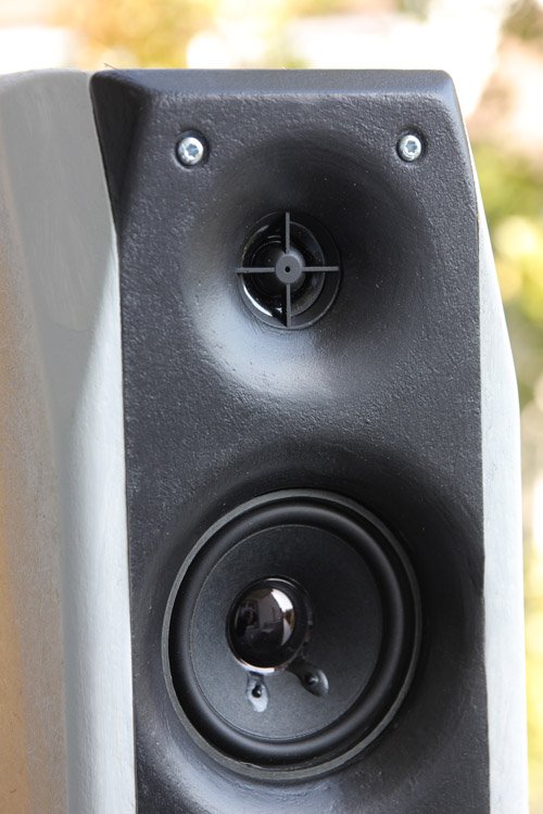

You sim whole system at once, so by muting or turning on you can readily see difference between 1, 2 or 3 drivers and driver placement.Can you dim multiple driver diffraction at once?
Here one can see how floor/ceiling bounce improves when one bass driver is moved down to the floor instead of being higher up like in a classic MTM.
I've still got a couple of those small Foster tweeters in the stash. Seems they are best used above 10kHz.
Yeah I've noticed the material doesn't seem to matter a ton compared to comes.Bit of an old myth. Most metal dome break up is outside of the audible range. Soft domes are what typically exhibit break up in the audible range. It's a little silly to pick a tweeter based on it's diaphragm material anymore. The sound of a tweeter mostly comes from how it's integrated.
What is strange to me is the off axis responses vary WILDLY of domes the same diameter. Do you know what is design feature that most impacts off axis response of a dome? Is is the radius?
Looks like I have a bit of learning to do. Are there any more in depth tutorials on how to use the tools and its features or just the manual? You care if I PM you and ask you questions as I figure this out?You sim whole system at once, so by muting or turning on you can readily see difference between 1, 2 or 3 drivers and driver placement.
Yup. I used 9k for this project. Here is just development stage.I've still got a couple of those small Foster tweeters in the stash. Seems they are best used above 10kHz.
Radius is one aspect.Yeah I've noticed the material doesn't seem to matter a ton compared to comes.
The "height" of a dome can change it - flatter is wider. Inverted has an effect; in essence it's like a dish cone.
Size of surround can affect things as it is a radiating area and starts being a waveguide if it gets large.
Material can affect dispersion as some are rigid and others can bend.
The small "waveguide" that goes unnoticed that's built into almost all dome tweeters can affect the response; someone on ASR simulated a few of these
In addition to this there are phase guides and other things placed in front of a dome; eg most recently, the Purifi tweeter , but has been done in some ways for decades

1. There are excellent 1" dome tweeters as well.
