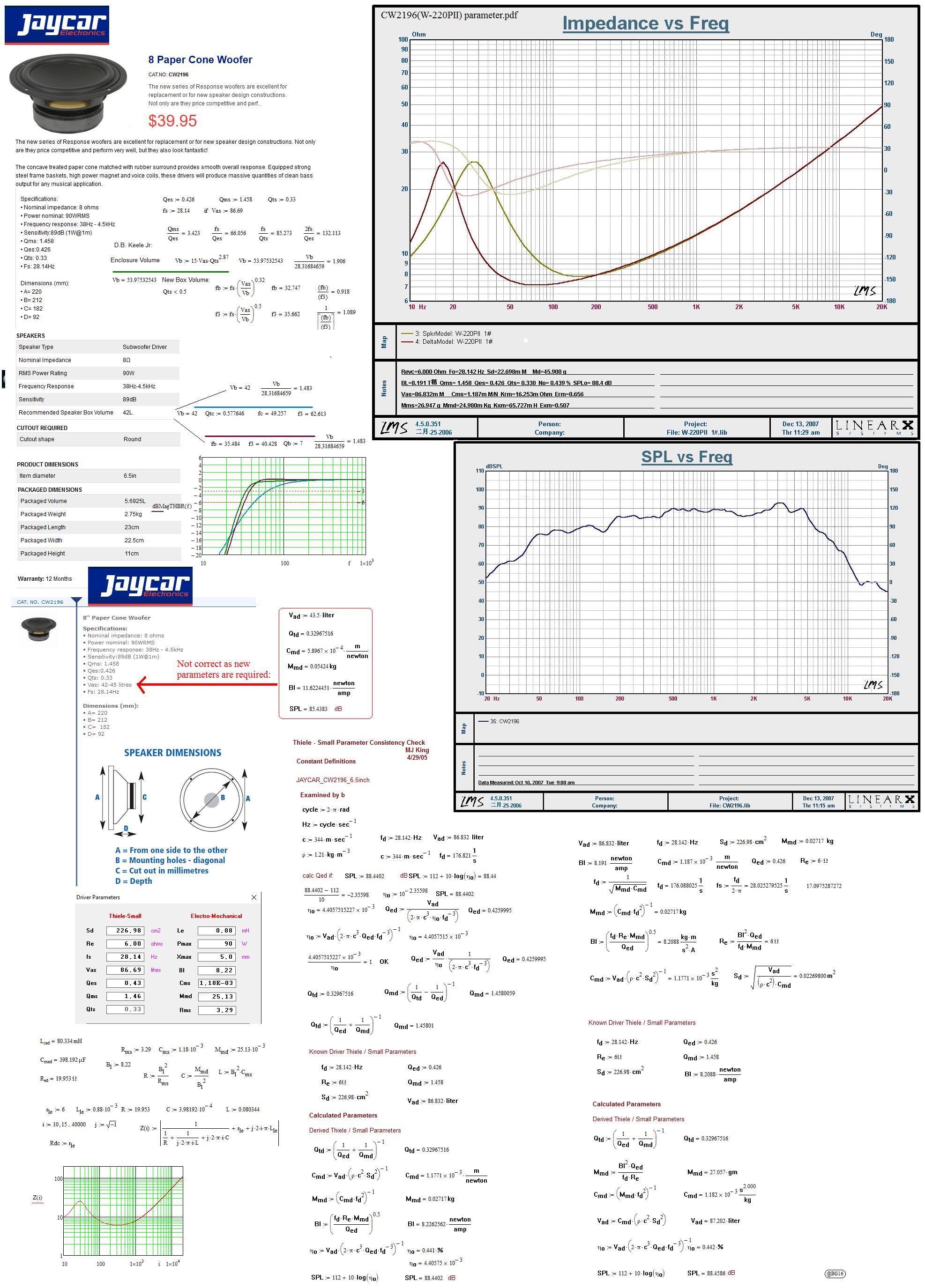

The Jaycar has more useful information, and its likely to
be fine in a sealed and stuffed 28L / 1 cuft box, it is very
likely the recommended 42L box refers to a vented box *.
I'd go with the Jaycar driver every time, and its cheaper.

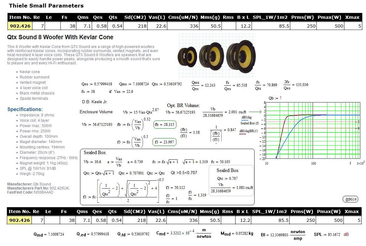

I actually thought QTX made decent drivers, but I'll remember this.

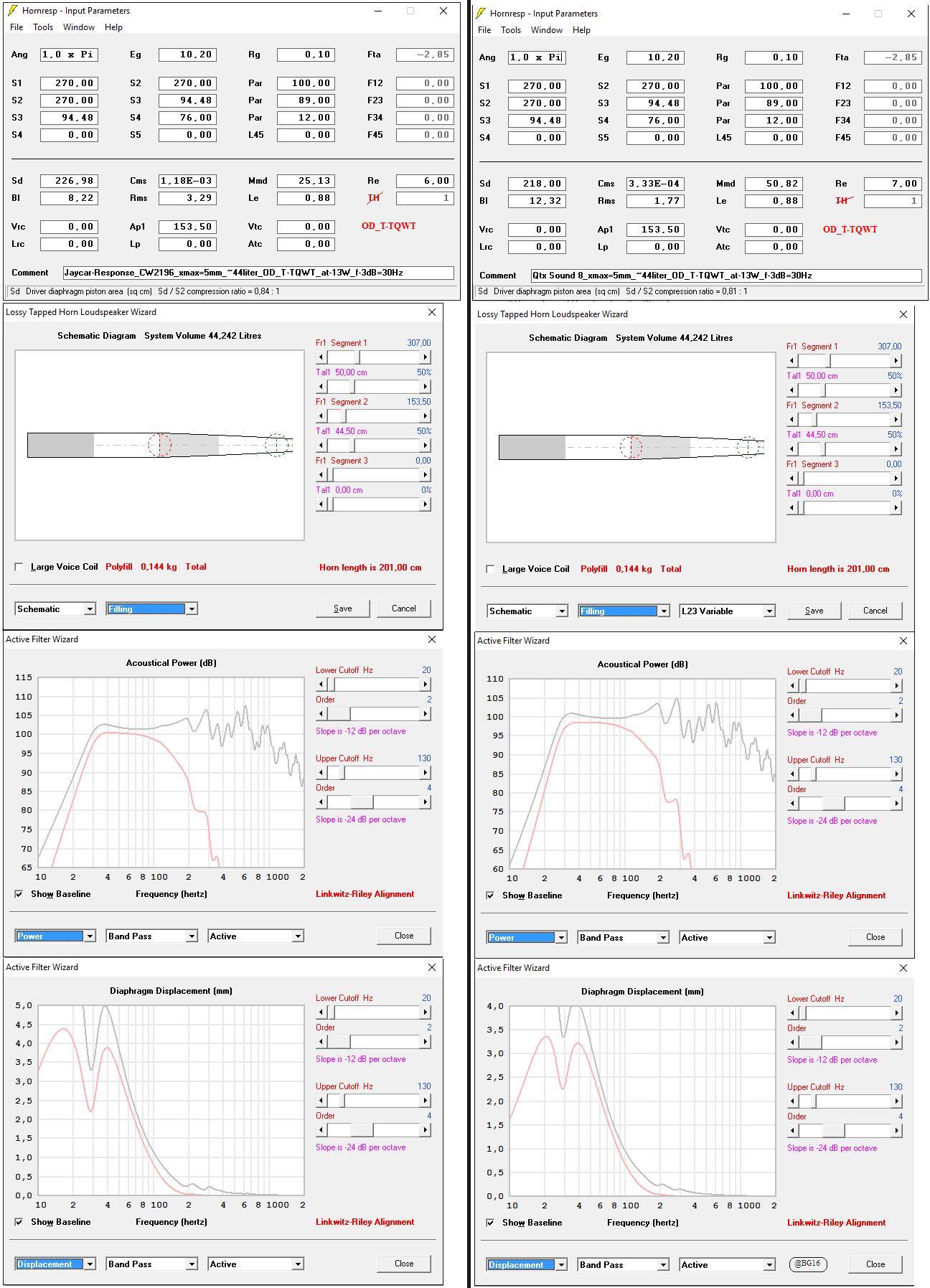

No clue about quality or its published specs accuracy, but based on the specs I just posted: per Hornresp it's only ~85.2 dB efficient and near enough a ~0.73 Qtc, so a bit stuffed would make it a max flat 0.707 with a ~48.8 Hz Fb, making the low 30s a good 8 dB down, all ignoring any room gain, etc., so the cab could conceivably be too small, requiring EQ to flatten it out.
GM
Hi All,
FYI:
Surprise:, 😎 The T/S Parameters of the QTX Driver are trustworthy:
b🙂

Jaycar-Response_CW2196_vs_Qtx Sound 8(Lepai LP-168HA_Amp)

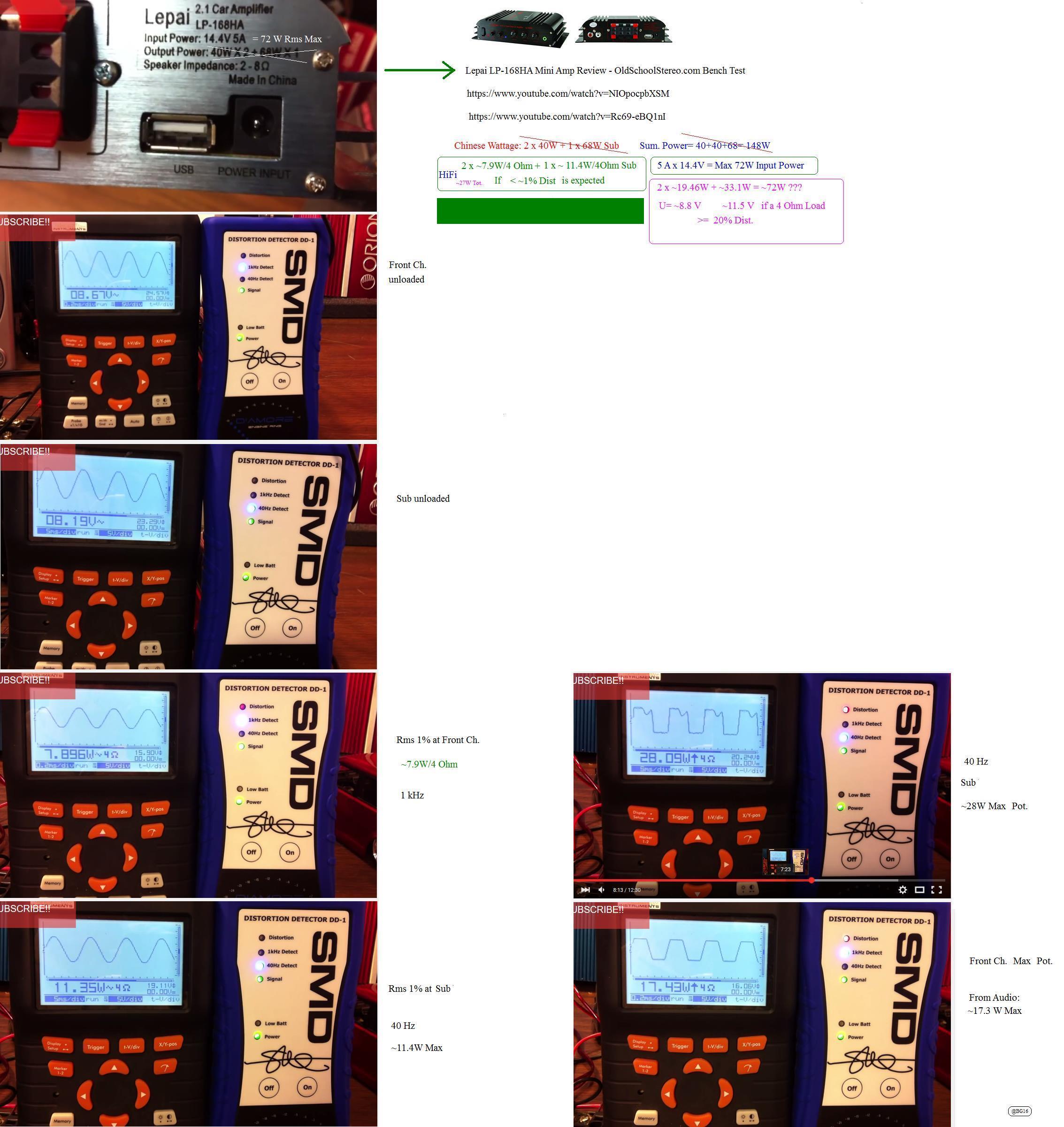

Hi All,
FYI:
b🙂
