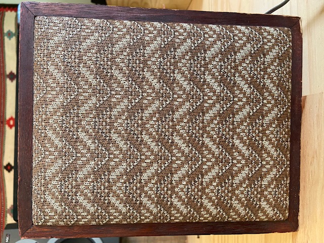

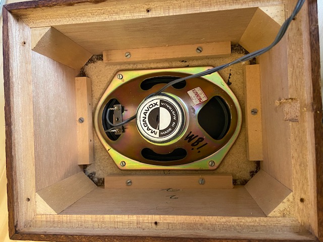

I am hoping to make a mono 'grotbox' speaker for checking my mixes on.
I have a single driver passive speaker to do the job. At the minute I am running a Lepai Class T amp to drive it, but it keeps making loud clicking noises intermittently and scaring the life out of me.
I'm hoping to turn the speaker into an all in one unit with the amp on the inside and a power-switch attached to the outside somehow.
Part of the point is that it doesn't sound great so I'm looking for something cheap and effective rather than 'good'. Any advice is appreciated!
I've attached pics of the speaker and driver.

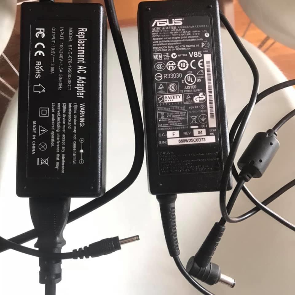

Power + and - to your supply... 19 volts is pretty common in laptop chargers and it will give you a little more oomph.
