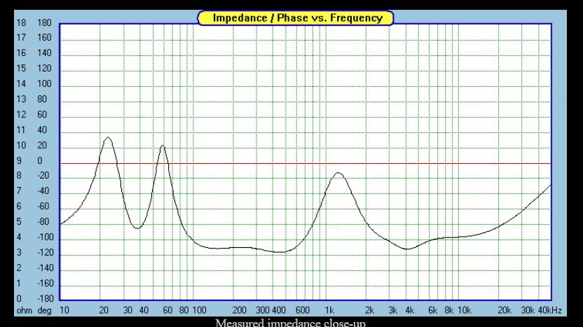

Ah. Well, the ZDT3's are 4ohm speakers with sensitivity up around 88dB with 2.83V/1m.
Your amp has lots of power for speakers that sensitive however I'm sorry to tell you that your AVR does not look like it will be happy with 4ohm speakers. It suggests the minimum should be 6ohm.
It's a 4ohm speaker. What can I tell you? No you can't change that.
Your AVR says 6ohm minimum. Try it with the 4ohms ZDT's and then if and when you fry it, buy a new one that will be happier with the lower impedance.
Otherwise, you are best off with 8ohm speakers. Unless - are you using a different amp than the Onkyo that can handle 4ohms? There's something big sitting there on top of the AVR.
Yes. That is true. And each speaker uses 2 of the RS180-8 drivers. These drivers are wired in parallel which changes the impedance for the combination to 4ohms. Look at the impedance graph below, the minimum impedance is ~3.2ohms which is what is called a 4ohm nominal speaker.
