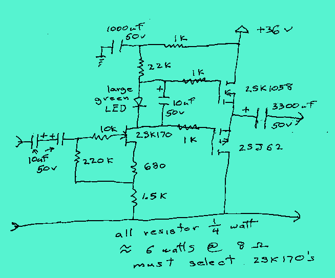

hitsware said:
Yep....If I could find a xfmr that would give me an about x10 voltage gain. With maybe 10 kOhm in? More realistically perhaps 600 Ohm in.........🙂 and drive the fets ........
Well, if you're using a digital source, your Red Book output is 2 volts RMS. To get your 6 watts or so, you'd only need a gain of 5.
I finally got 'round to ordering up the transformers so should let you know how it sounds in a couple weeks. I've already done a lower current version (about 160mA) using 1:1 transformers for driving headphones and it sounds fantastic. Just need to scale it up with some 1:5 transformers and higher current output devices.

hitsware said:
will your generic 'red cd' put out a good 2V into 1.5K?
If it's output impedance isn't unusually high. The transformer in question is optimized for a 150 ohm source impedance. So if you're in that range you're looking at a little under 1dB loss so you'll get about 1.82 volts at the primary and about 9 volts at the secondary. So you can still get close to 5 watts at the end of the day. Which would be a difference of just over 1dB compared to 6 watts.

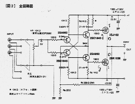

Hi Sukandar,
May be the Son of Ampzilla or the Grandson.
http://home.kimo.com.tw/skychutw/ampzilla/index.html
Must be possible to use FETs for the inputstage like 2SK389 & 2SJ109....
