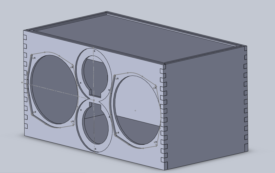

So I've sketched up the enclosure and added the speakers.... The challenge now is to come up with a suitable porting (if at all) design. I was thinking I could have some removable 'plugs' that fit into the holes so under certain circumstances they could be removed. Any thoughts?
I need some guidance on port sizing and direction if anybody could offer advice?

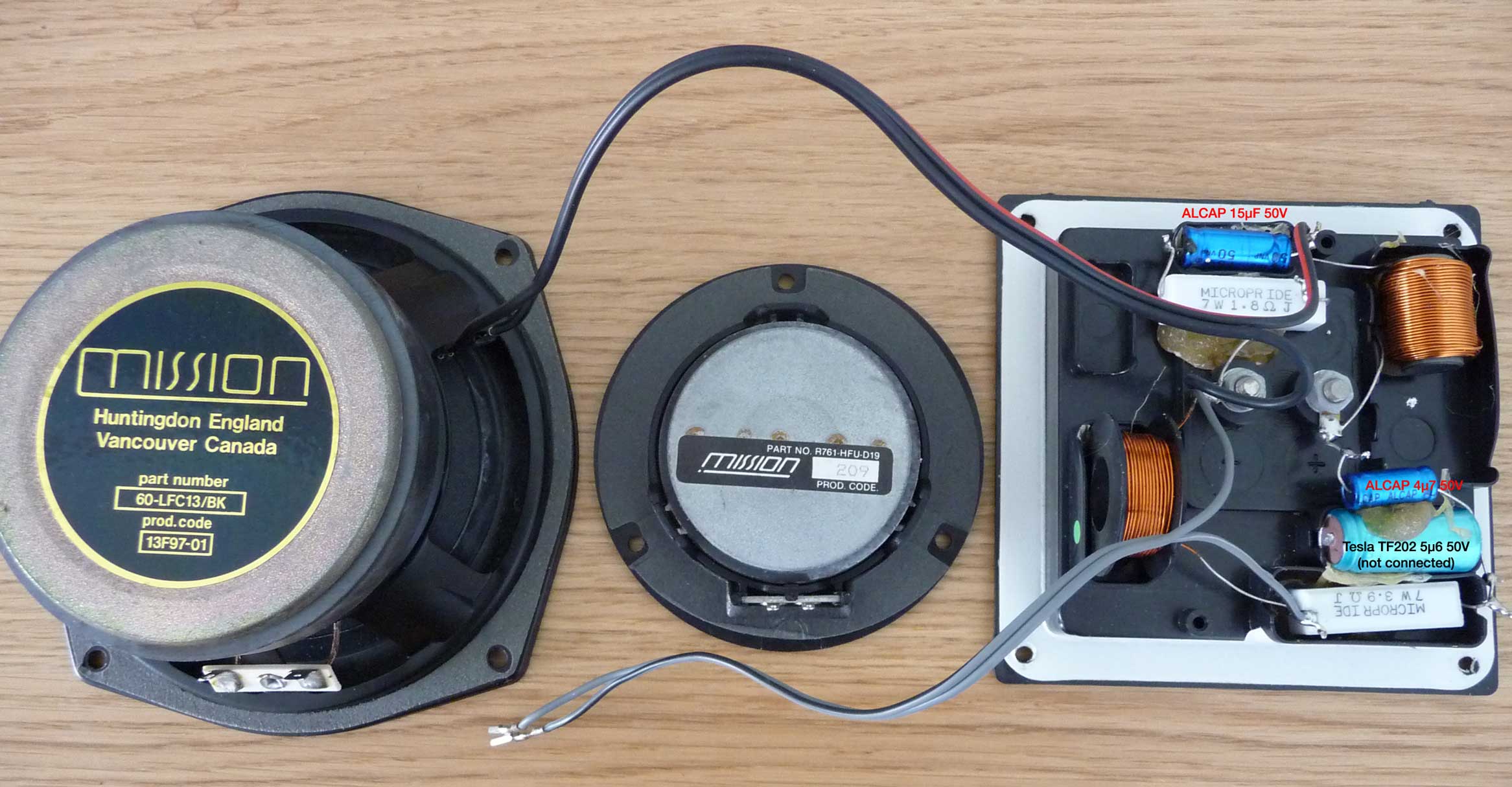

I've had the speakers apart - one of the capacitors was not connected to anything and was of a different brand to the other two. One of the other two was glued with what looked like original glue. So what happened? Has somebody had these apart and replaced both capacitors, INCLUDING all of the glue? Just for comprehensiveness, I have attached a photos with values below
Having taken ours apart, the disconnected cap is the original, the smaller one just above it is a replacement. TF202 has value 4.7uF in ours.
The design you've drawn up: I'm not sure if having two tweeters is a good idea, because of comb filtering. When the distance between two point sources approaches a wavelength, they will start to cancel when off-axis. So, if you put it on the floor, you won't have much treble. It's difficult to explain, so here's someone that can...

Thanks for your comments Chris, I understand what you're getting at. I had considered that arrangement (and buying a center speaker instead) but I wasn't sure what to do with the cross-over side of things. I guess my choices are:
1/ Run a mono signal into the amp, run two channels through two cross-overs and into the two mid's. Run one tweeter off one of the cross-overs.
2/ Run a mono signal into one channel of the amp, then going into one cross-over driving the two mid's in parallel (giving half the impedance, twice the power provided it doesn't mind driving 3 ohms) and one tweeter.
The cross-overs have a high pass of 4500hz so approx 7.6cm, the tweeter centres are 91mm apart. Advice would be really appreciated!

I would run a mono signal into each channel of the amp. One channel, run one woofer and the tweeter (you'll need to play with the series resistor to bring the level back up), use the other channel for the second woofer.
I expect this would be about the best (especially in terms of amplifier loading). Just remember to de-solder the wires from the second tweeter - you don't want them shorting...
