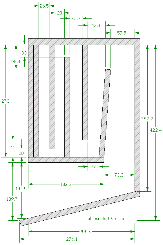

But that is hard to read -- the drawing i did to aid in construction:

Re: horn baffle,
i have no trouble reading them, but many won't -- you can see that i sucked the pictures out of Excel and made them into gifs... but why put them in Excel in the 1st place?

Ricdelros said:still cant read my attachments?
It's a drawing of horn loaded baffles for beta-8 & beta -10.
