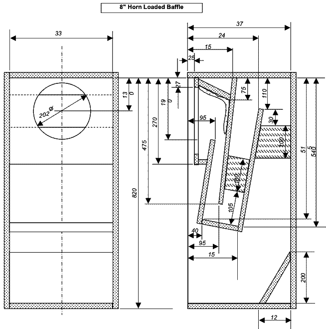

I was wanting to build a small, low power (50-100 watt) bass horn using an 6 1/2, 8, or 10 inch sub. This will be used for my computer sub, and as an experiment in horn loading drivers. Any help would be nice, Driver recommendations, documented projects, anything. Thanks.

bhg41088 said:I just so happen to have 2 W8-740c's. Anyone have box designs?
Download hornresp and start modeling.

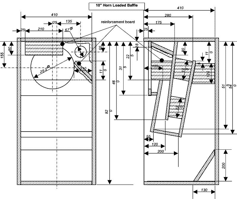

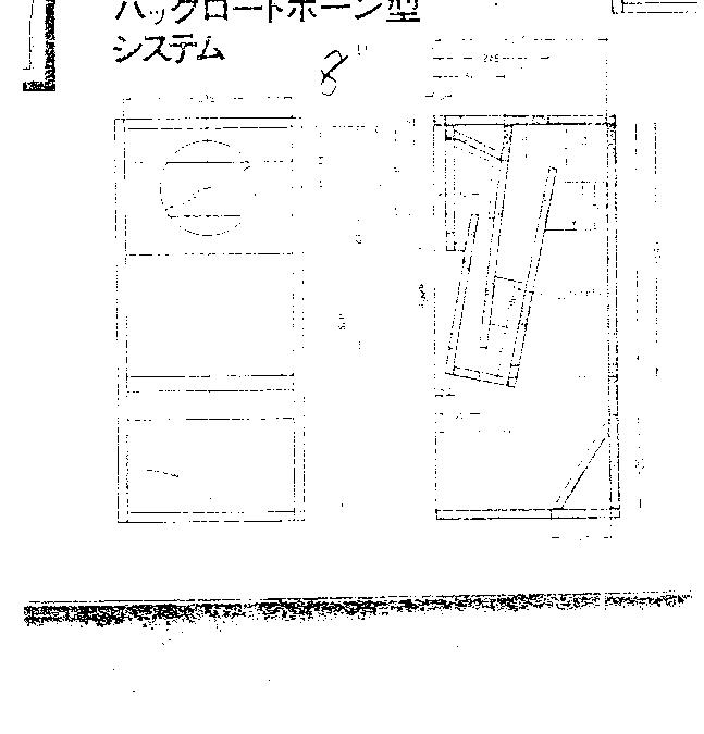

sorry for the unclear picture. it is only a scanned drawing from japanese coral brochure. I'll redrw it for you.please wait

bhg,

bhg41088 said:What driver would i need for this horn?
ideally a Coral Beta 10 or Bata 8 (or 10SX-70/8SX-70)
